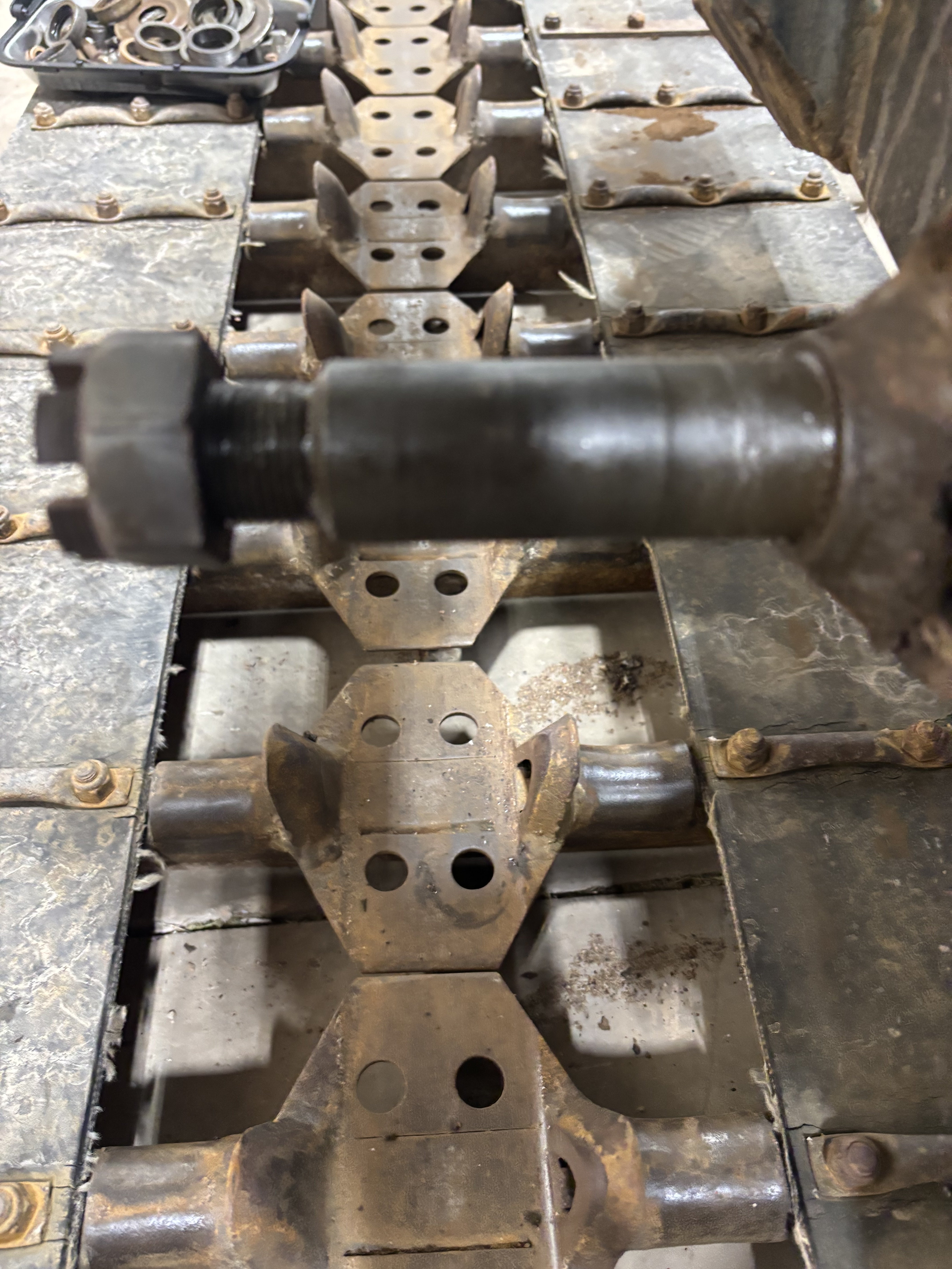

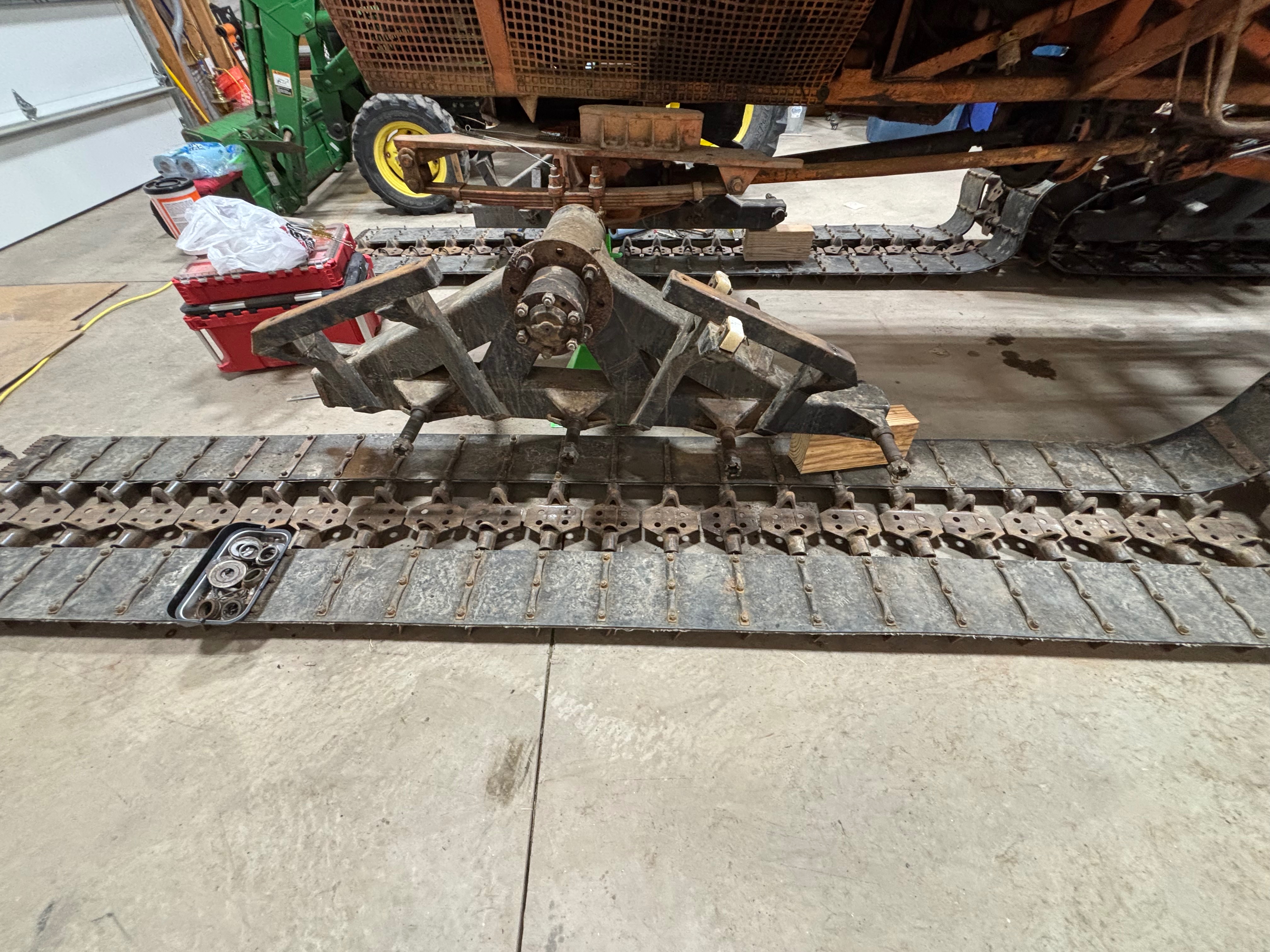

Thank you Davenet, I knew it was not going to be easy but starting with the tensioner spindles first and going to try and press them out. I had to drill out the bolts that hold the UHMW on and not a terrible job just time consuming but learning real quickly that nothing goes fast on these cats and when you have them apart address anything you find and that time as it will only get worse if prolonged. Not sure why the old mechanics never used anti seize on any of the parts? I work in the oil and gas industry and we put it on everything as it just makes life that much easier at the end of the day.

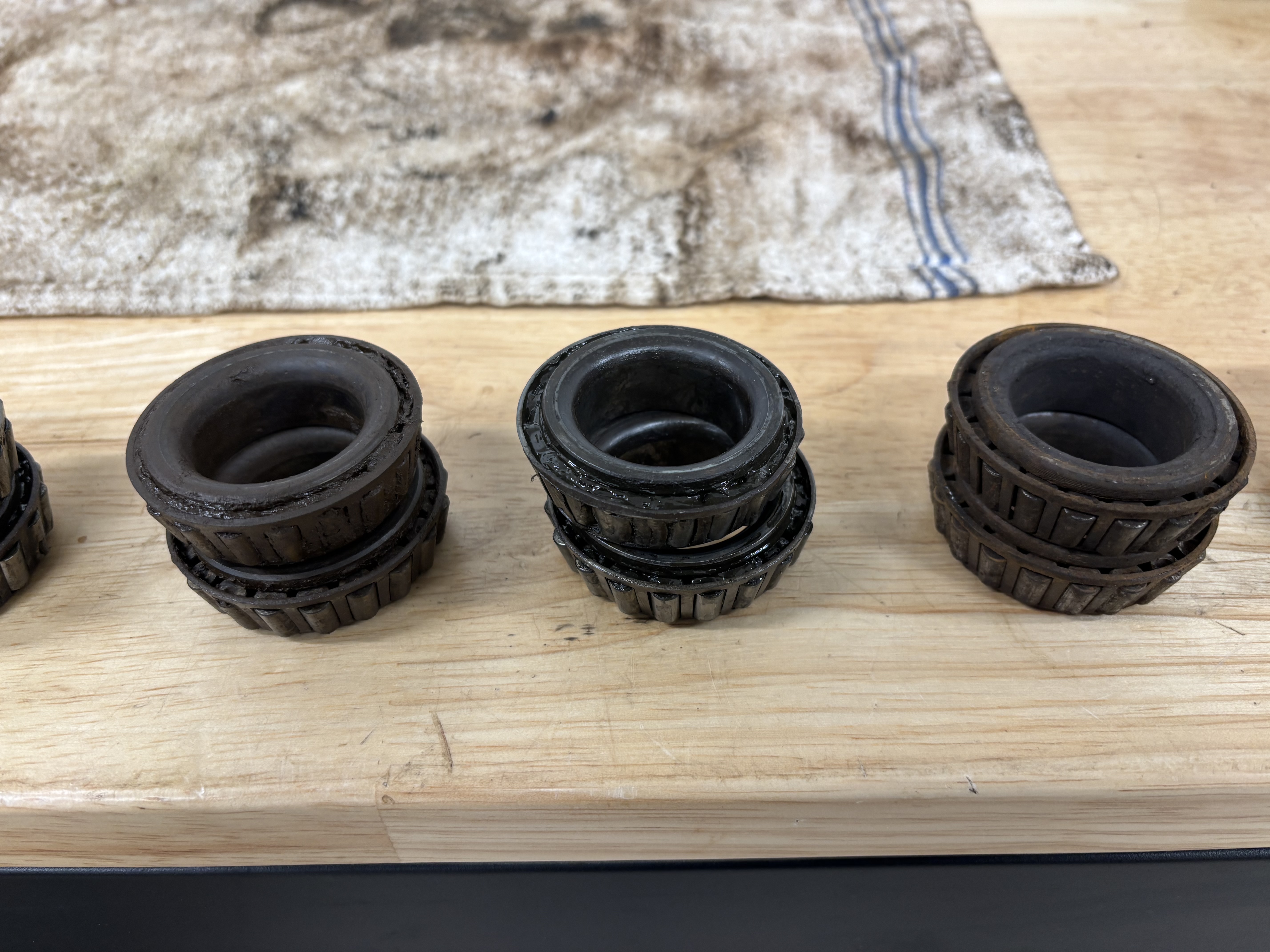

On another note here are some of the idler wheel bearings that I pulled out, I read a really good discussion on that the other day and which brand to use and were the cheaper ones better? From the ones that I pulled out the Timken bearing held up better than the others, I have no idea what brand the other were as there are no markings on them but what I did find that even when the seals were out the Timken did not rust and fall apart like the others they seem to be just a little heavier built and better materials from what I assessed. Another question is on the outside of the idler some of my wheels just had washers and others had caps (about a 50/50 mix of them) the washers are obviously easier to remove but the caps seem to hold the grease better? They put silicone on the caps to help them seal up but not sure if Loctite would be better? The caps were not bad to remove but was wonder if the washers were better as I seee most of you guys are just running washers? I also notice that the seals that were installed backwards did hold up better (were still in place and holding) but only had 1 or 2 that were that way most were installed correctly and most were either leaking or completely gone. Just an FYI from what I have found.

"I have no idea what brand the other were as there are no markings on them but what I did find that even when the seals were out the Timken did not rust and fall apart like the others they seem to be just a little heavier built and better materials from what I assessed."
The other brand: itchycrotchy, my bane of rebuilding equipment for many years.

On our Thundercat and CHUGSzilla projects we removed all the spindles from the carriers. This was suggested by Tucker’s former parts and service manager Jeff Godard. Really, it’s preventive maintenance in case you ever have to change out a spindle in the field. Lying on your side, hopefully on a tarp and trying to swing a good sized hammer to beat the spindle out is a scenario I hope to never experience.
We did it in the comfort of Scott’s shop with a crane, a massive steel work table, oxyacetylene at the ready for heat, and a big hydraulic press. Even with all that... some of the spindles were downright recalcitrant. We eventually got them all out, and when it came time to reinstall them, they were liberally coated with anti-seize.
There is no magic bullet to get them out. In some cases (very few) it was just a few blows with about a three pound double jack. Others required the hydraulic press, some required heat, and still others required The Gorilla wailing away with a 12 pound sledge hammer. In the last situation you almost felt sorry for the spindle, the key word being “almost”.

This may seem wasteful, but I stopped cleaning and inspecting the idler wheel bearings. You'd take the time to clean the bearing thoroughly, and then when inspecting it you'd find some pitting on the rollers. Then you scrap the bearing and you've just wasted that time. The carriers on the Thundercat and CHUGSzilla projects are 1600 series, and they have damper wheels, so a total of 72 bearings per machine.
The last time I bought those bearings (yes, made in China) a bearing set; meaning tapered roller bearing and race were around $4.00. Yes, prices are now higher thanks to Bidenomics, but here's a link:

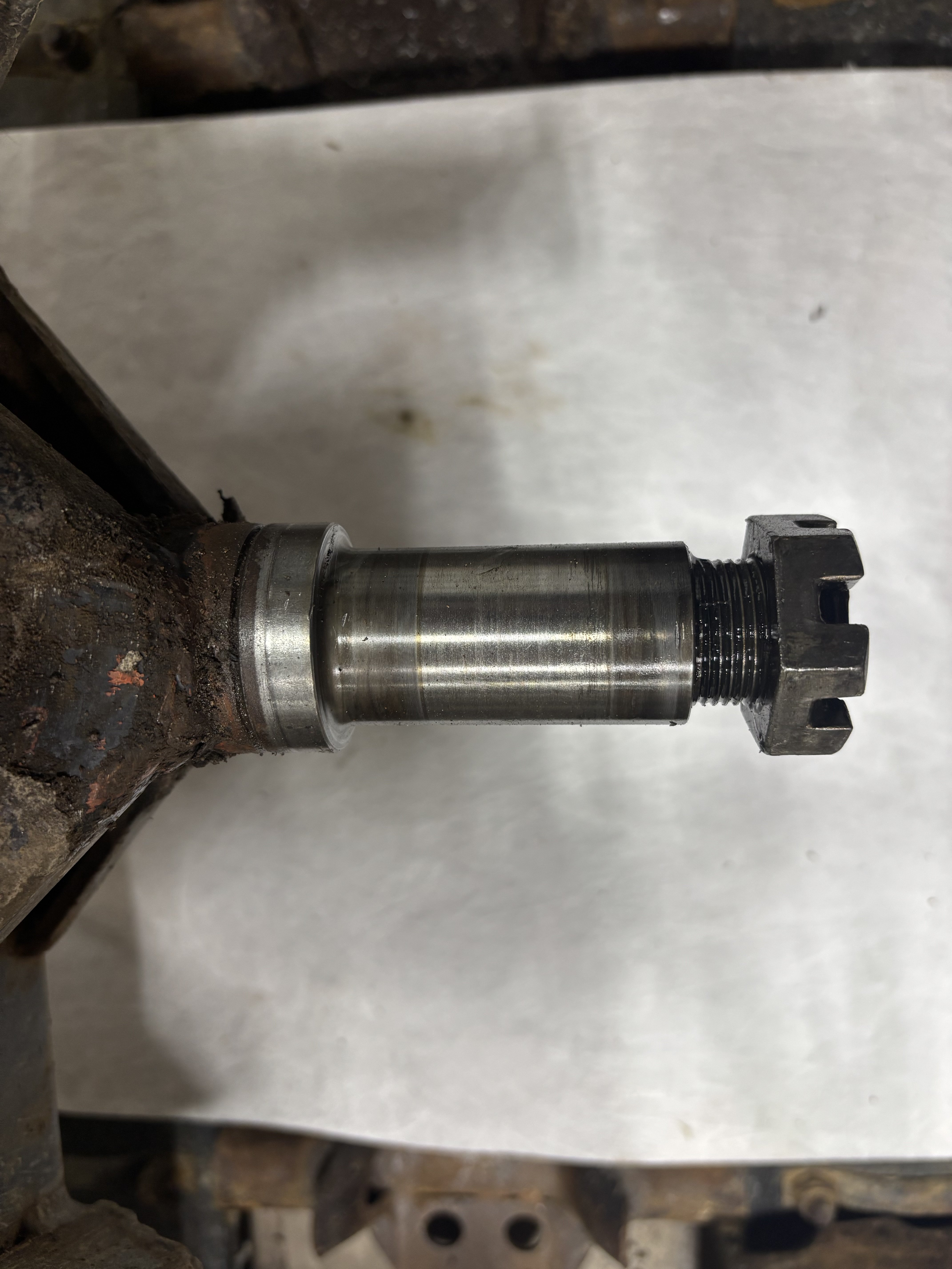

So the first picture is up close of what I am assuming is the new spindle (TA and BFT please correct if I am wrong). The next 2 pictures are of old spindle I did not get pictures of the spacers but I do have both old and new spacers (without and with o-ring groove) you can also see the difference in the castle nuts the old spindles have quite a bit heavier nut on them. All of my new spindles have the press fit caps on them, have a mix on the back tracks as well with and without caps. Depending on cost and if I can get them out without tearing them up I plan on going with the new style and running caps on all (might be a little OCD on things like that) but all depends on cost.

That’s the new and old. One old looks to have a crusty race frozen on.
Save the money and spend that time and money on more greasing. If you grease after every use bet the bearings last for ever.
It’s when they sit with moisture the trouble starts. Front and year idlers are the ones that will disable the machine for a failure. You can at least limp on the middles.
