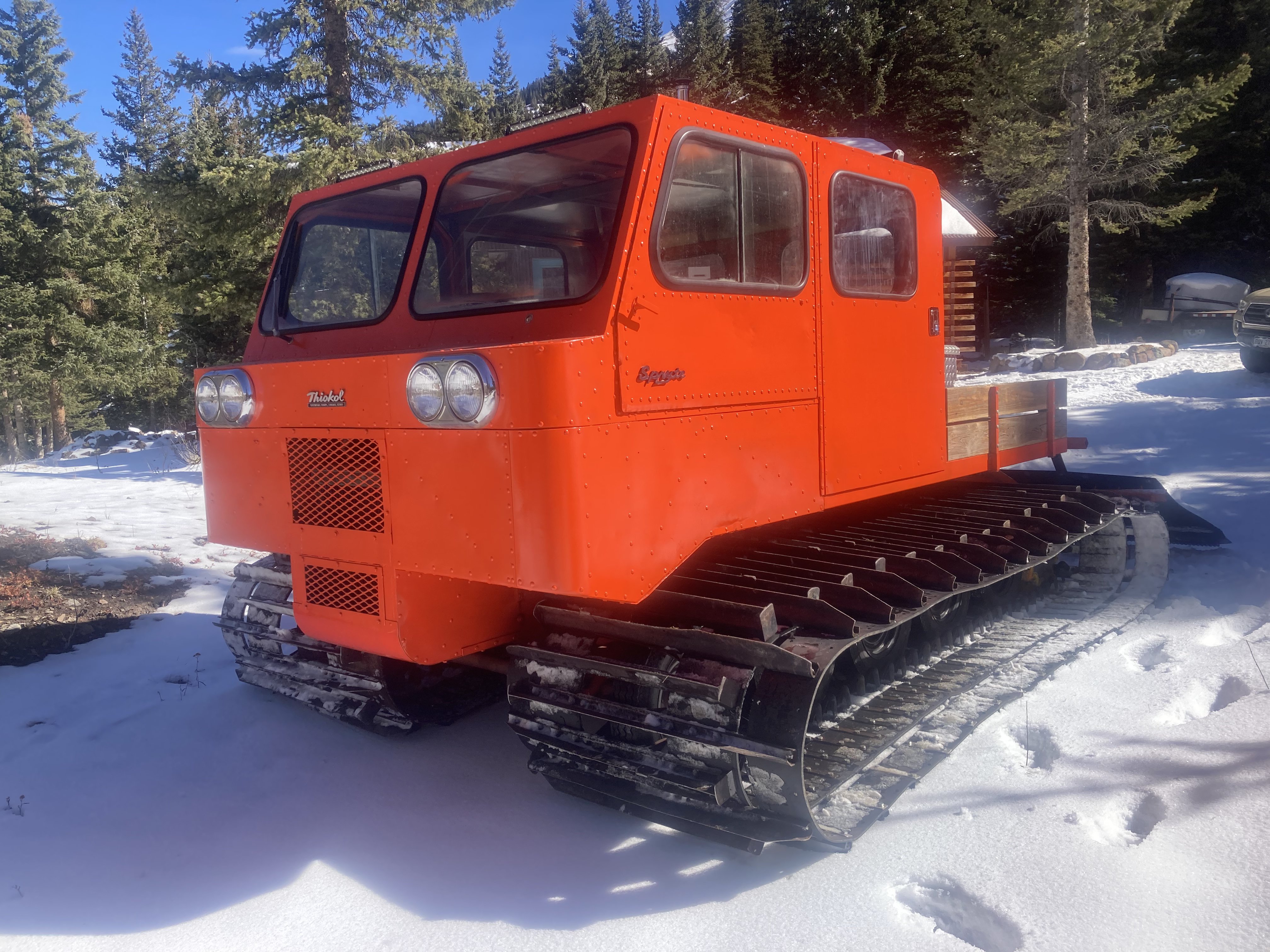

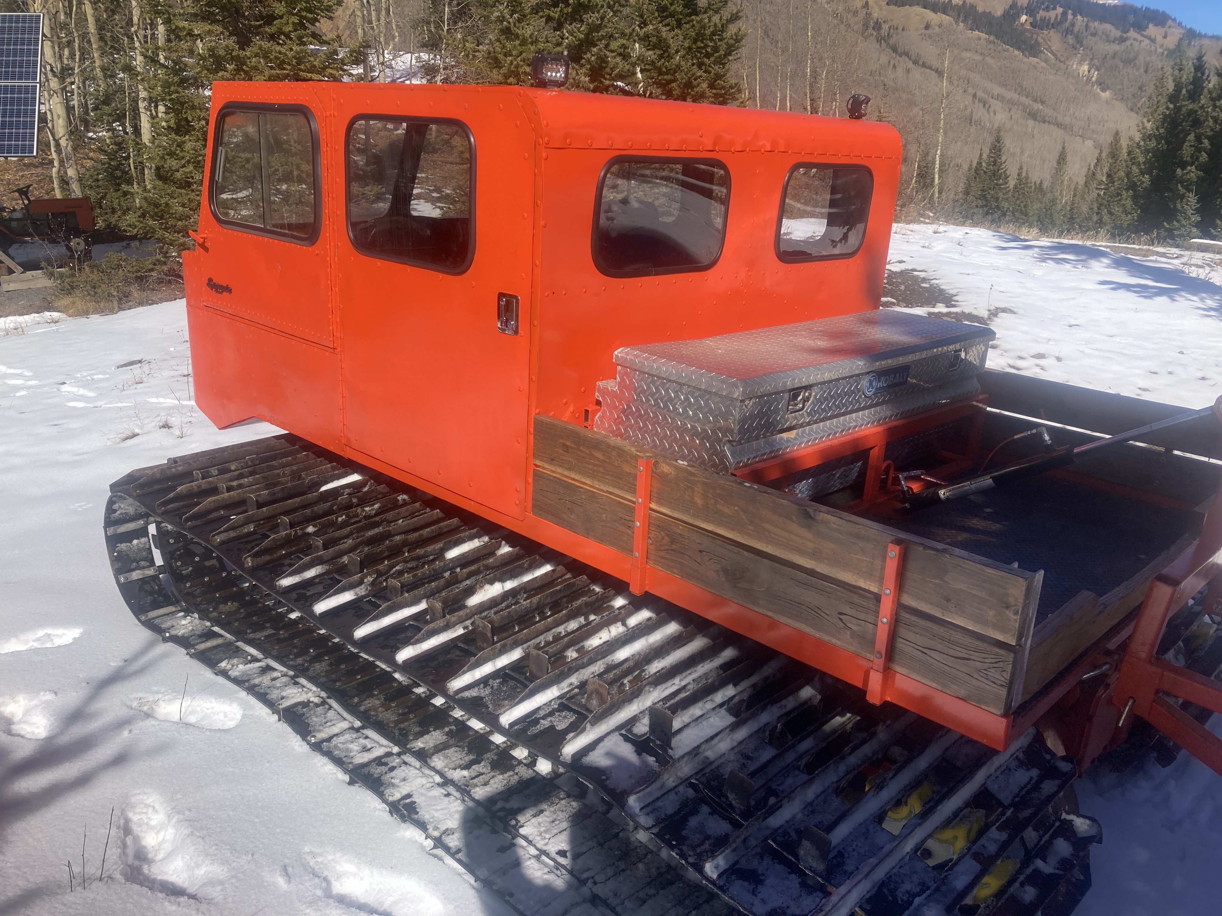

Thinking of extending my 1201A cab to match a 1202. Doesn’t seem like it’d be too tricky. Anyone done this? Tired of shoveling the bed and could use a couple more seats.
Would anyone with a 1202 cab care to post some detailed pics or dimensions?

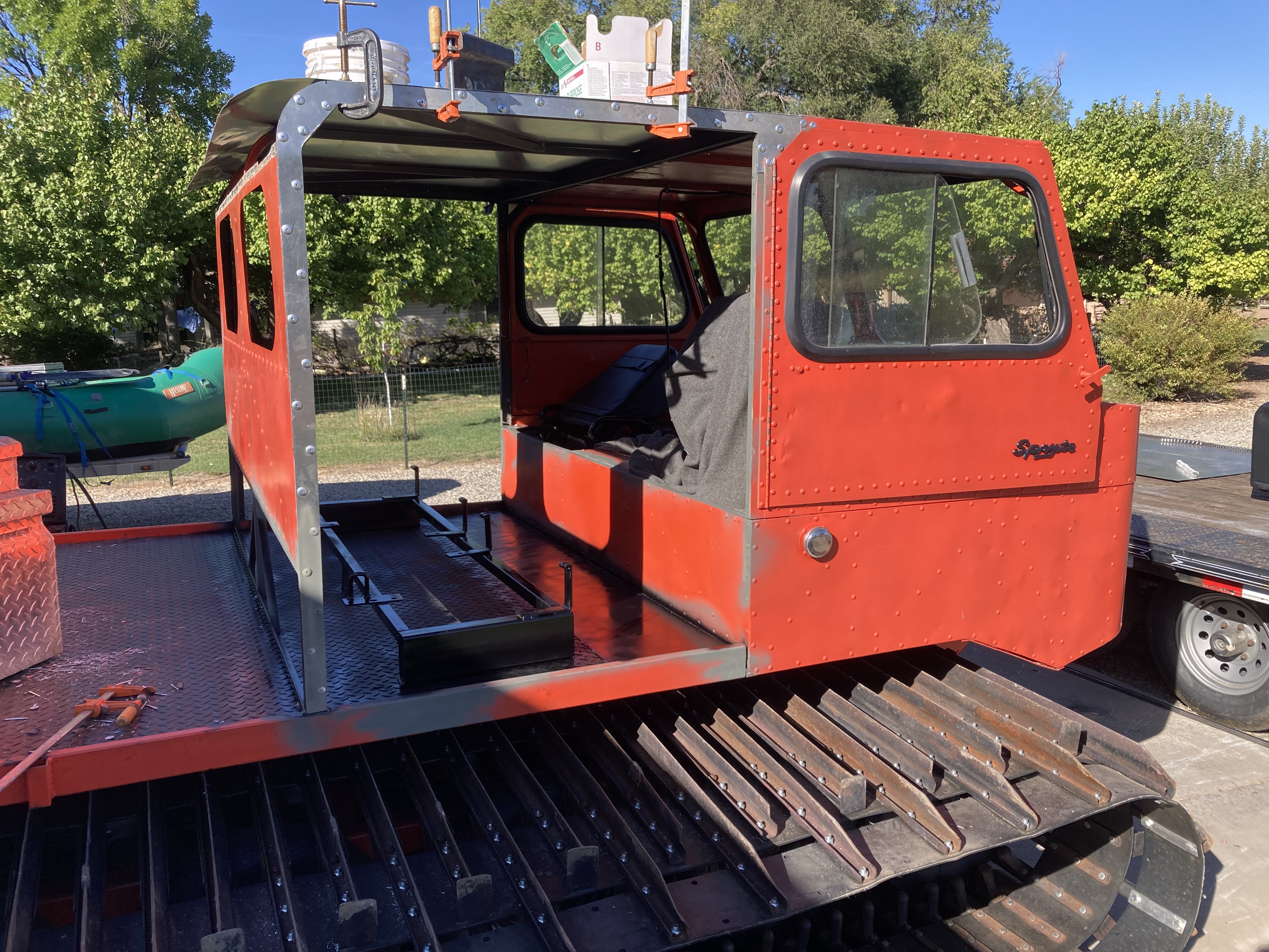

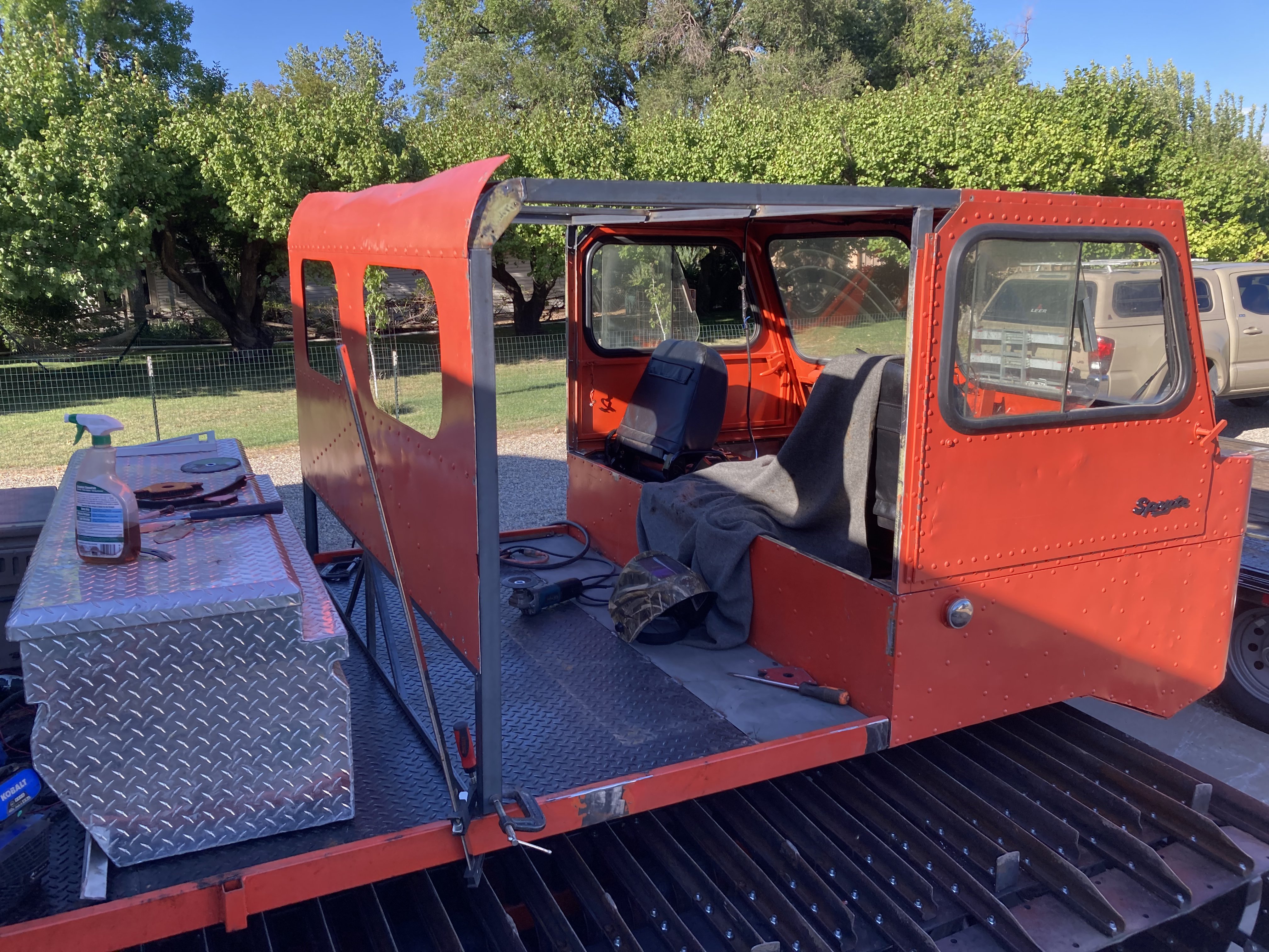

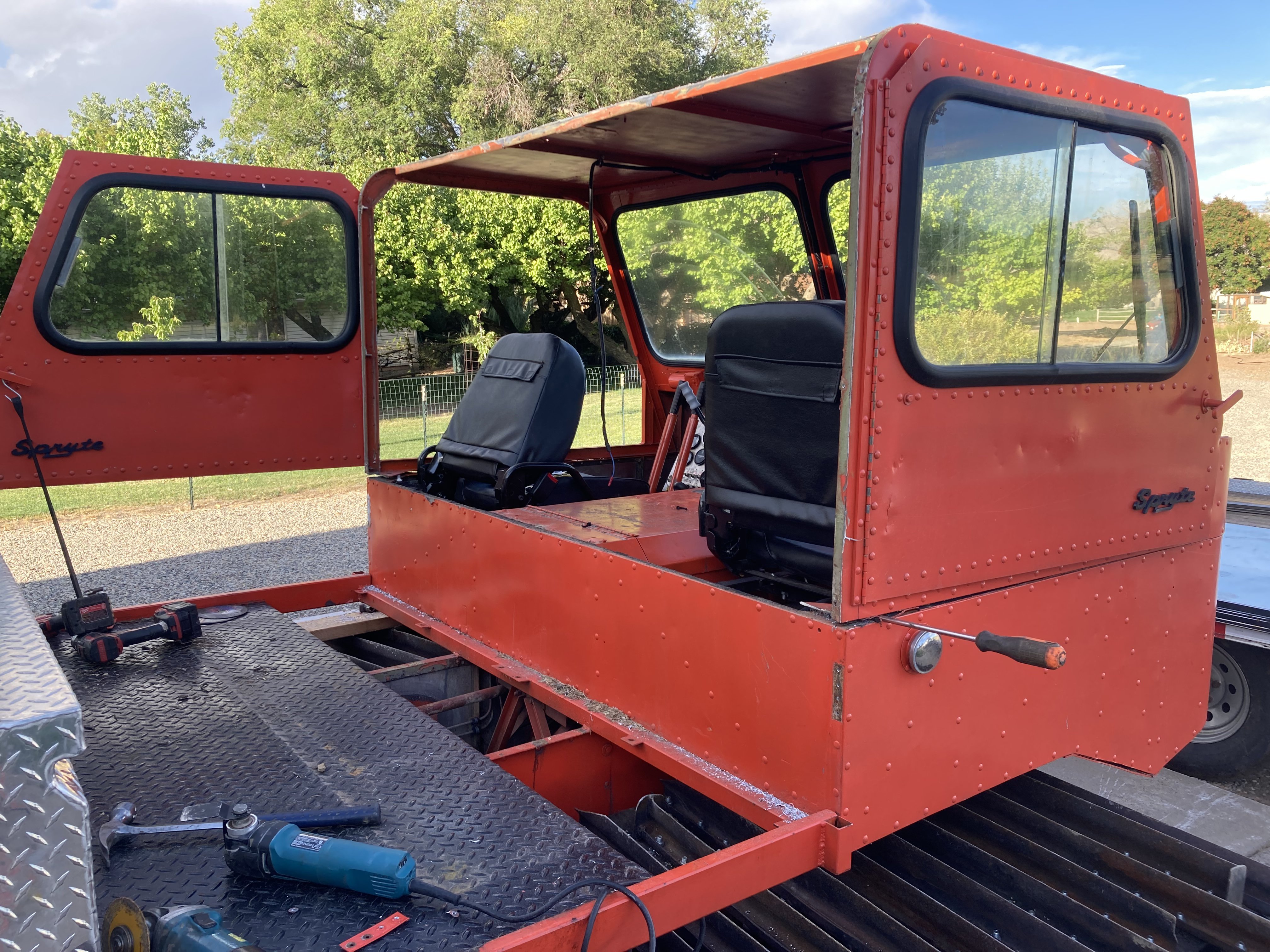

Had a productive day. Will have a few more days next week to get more done

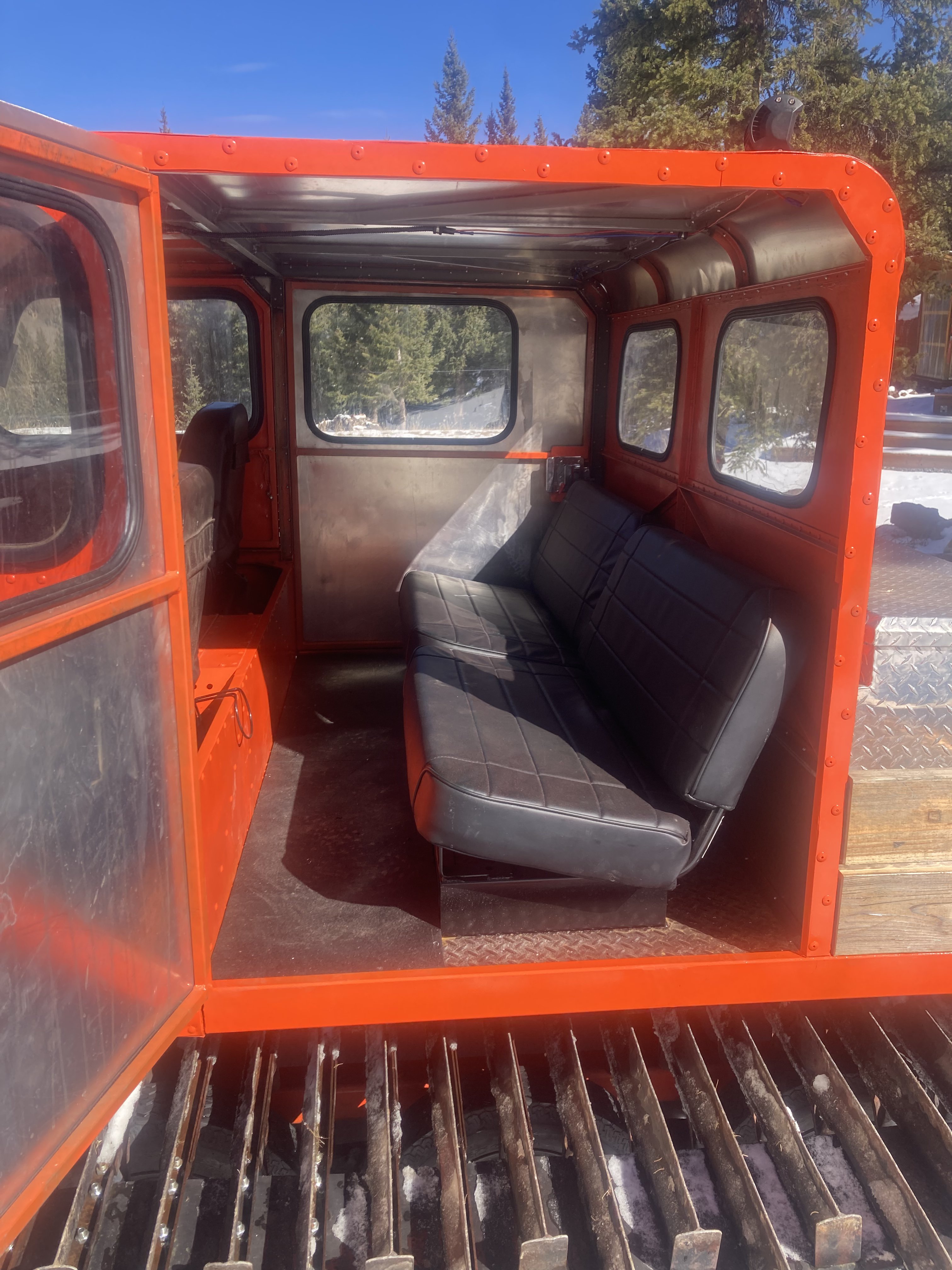

This is looking great.....
The rear passenger section looks very comfy.
Body work is superb .....
What rivet tool you using ???? Manual or air operated ??

Thanks! Started with a cheap drill rivet tool attachment but quickly destroyed that and upgraded to pneumatic one. Using 3/16 wide flange pop rivets. I couldn’t imagine what my hands would feel like doing it manually. Right around 225 rivets at this point.
Doors mocked up. Now prep/paint…..
