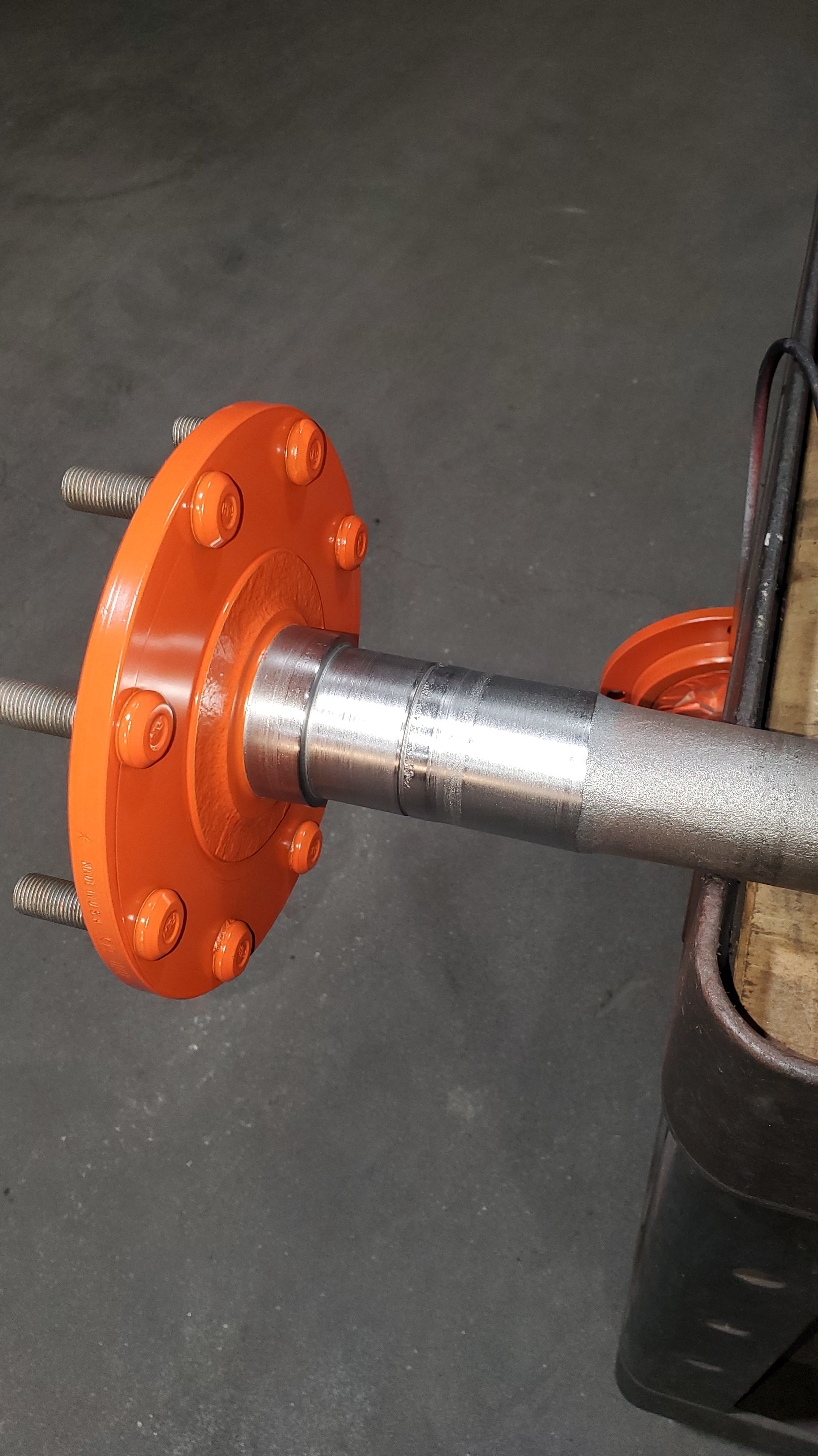

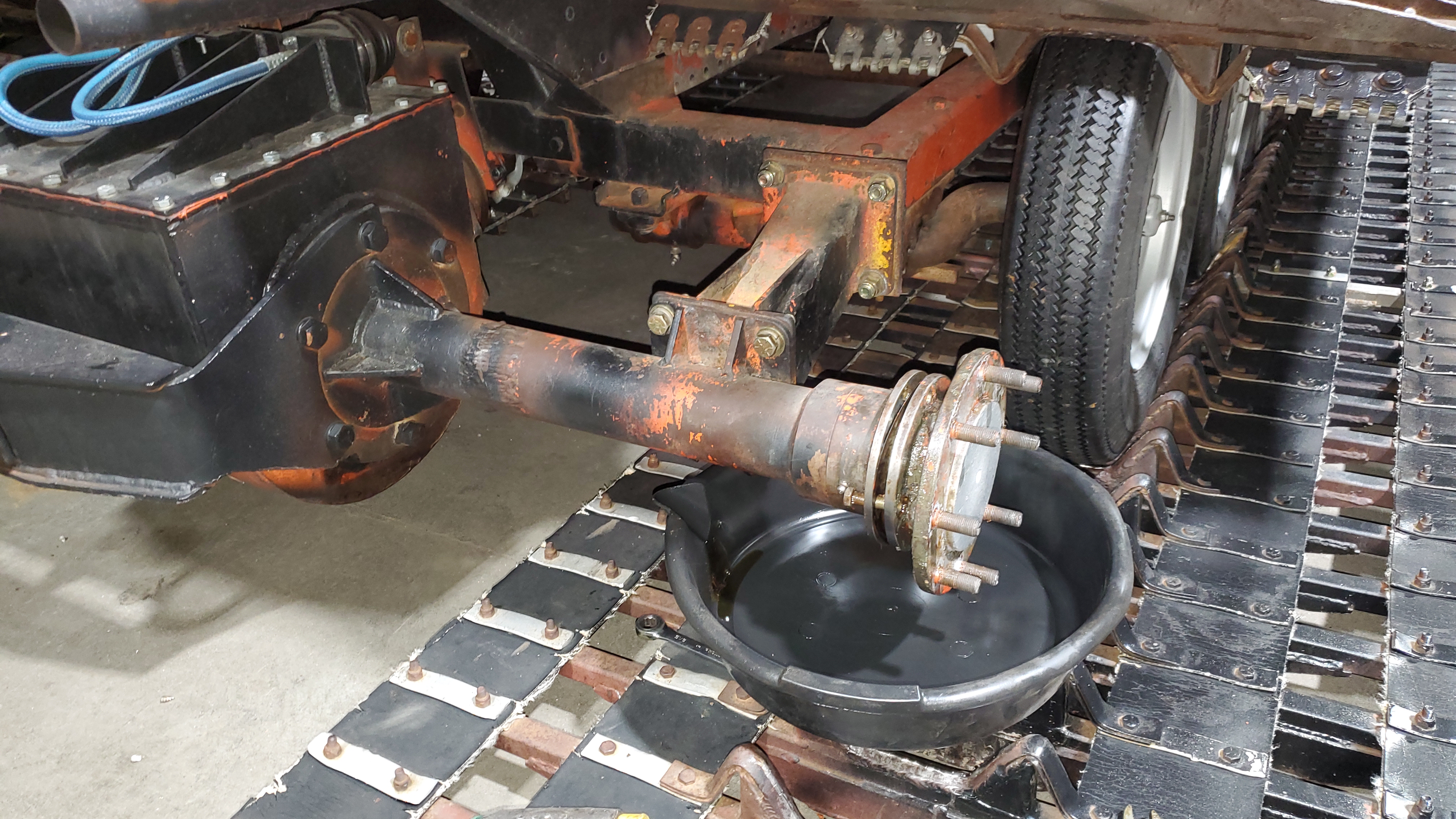

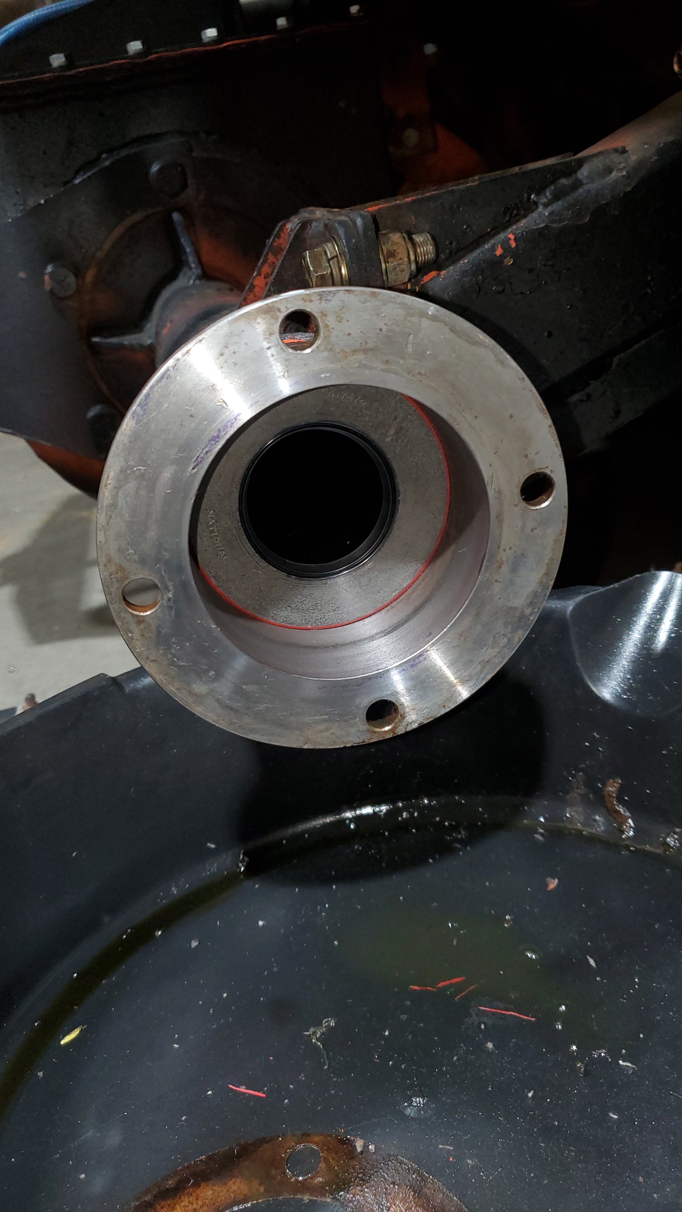

Not to bad of a job . I called Nancy at Spryte Improvement and she got all the brgs , seals , snap rings and gaskets for me. The old stuff was definitely worn out.

Thanks for posting pictures and update. Nancy at Spryte improvement has been a great help for me. I have the same job to do on my Spryte. Is the bearing a press on and press off? If so any tips or tricks?
The bearing is held in place with a snap ring. You will need a seal puller one with a slide handle hammer action to pull the seal out of the axle tube.
