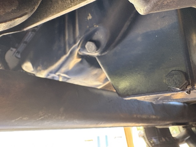

Okay, I went out and took a look at the mess, I mean the project. There was no way that pan was coming out! The deep sump got trapped behind the front axle. SO.... What I did was opened up the tracks so I could drop them over the front wheel ? axle. Then I pulled the axle out. The oil pan then was free at last! From the photos, you can get an idea as to how things went. I think the pan is toast! I'll attempt to fix the crack with a weld and test but am wondering what your thoughts are about just going with a standard oil pan? I'd need a new pickup tube but oh well. I think I can find a replacement standard pan for a few dollars.

Note the amount of drop, not gonna clear the axle.
How I got the pan out.
The mangled mess. Goober welds as I attempted to weld in place and kept getting bound up due to limited space.IMG_3463 Medium.jpegIMG_3464 Medium.jpeg
You have a center sump pan.... nice job liberating it.
