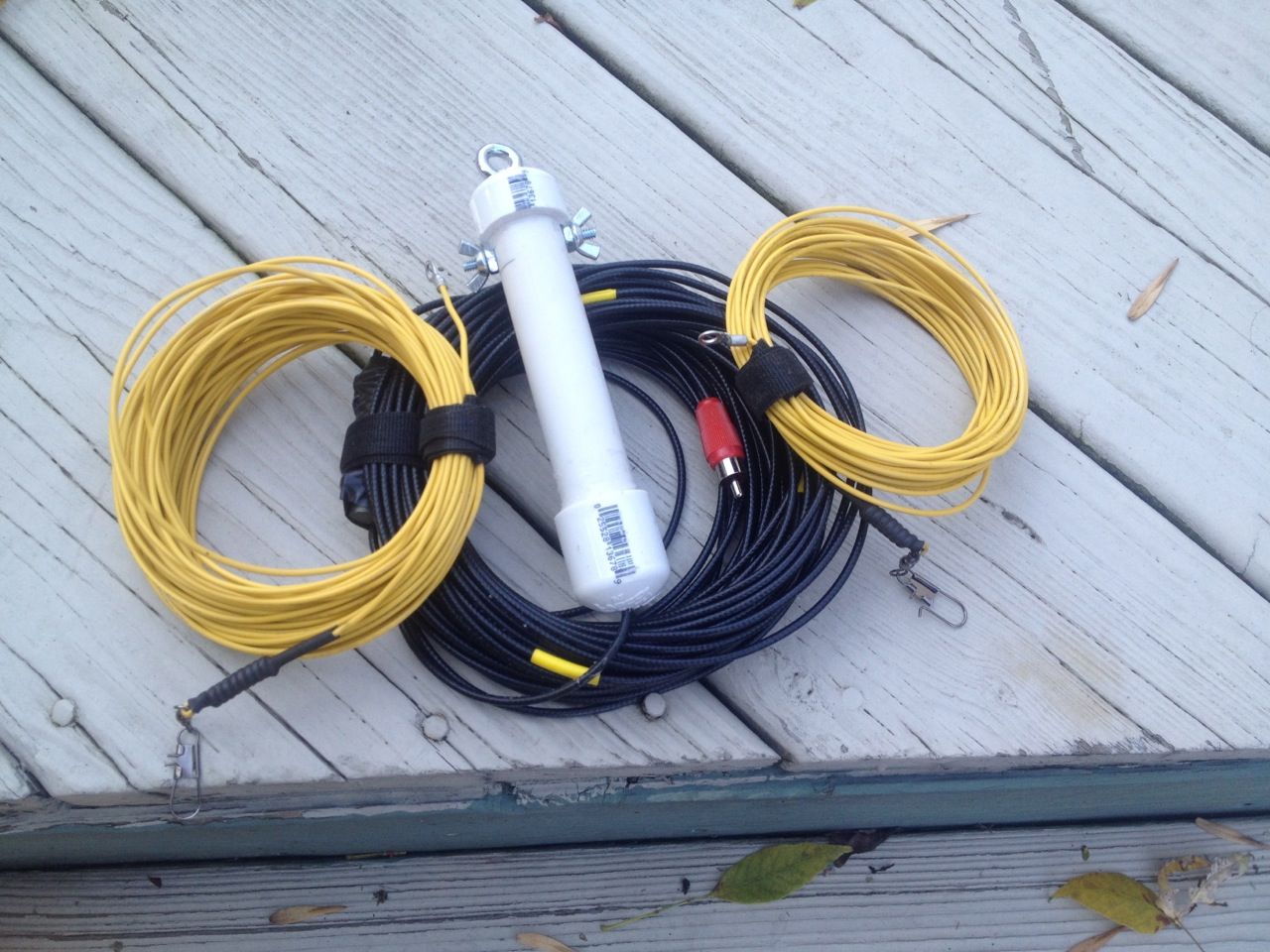

I need a 12-step program to curb this addiction to antenna building. Here's the latest arrow in the quiver for QRP portable operations. It's called a New Carolina Windom, and is another entry into the micro coax line of antennas that I've built. I made one 40m contact yesterday, 25 miles to the East of Washington DC before the monsoon came through (I guess I should look at weather before going portable), but will put it through its trials this morning while waiting for the water company to show up and swap meters for the "drive by" reading type.

DESIGN CHANGE....
I Hate ugly designs, which is what I created. Aside from the fact that the antenna performed exceedingly well (DX contacts into Belgium (2) and Ireland, and domestic contacts into FL, MI, AZ & TN yesterday on 5 watts), it's basically an ugly, open to the weather, ugly design. Plus, the antenna wire was THHN, and a real bitch to try to roll up.
Sooooo, I stopped at the surplus place and bought 100' of 20ga with with a more supple insulation coating that rolled up nicely. Wire problem solved. Then it was back to the bench where I wound a new 4:1 balun, and manipulated the wires to fit inside of 1/2" PVC pipe with 6-32 x 1/2" screws to attach the antenna wires to. Nice clean design that is easy on the eyes, and provides a weathertite, protective housing for the balun and feedline connections. Both end caps were filled with silicone to seal the eyebolt and coax holes before sealing the caps to the pipe.
I took it outside and ran it up into a tree at 30', and made a few local contacts to confirm the connections were all solid and there were no shorts. Now I'm a happy camper with a better looking balun/center support unit.

And the redesigned product...
