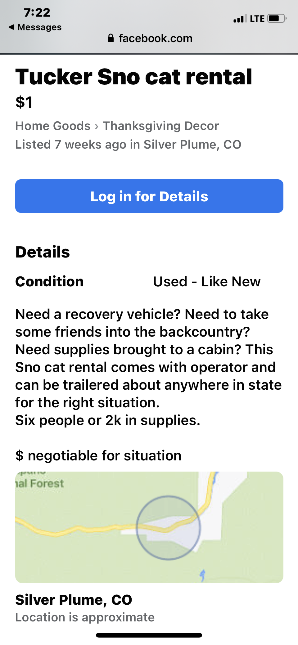

This ad is on Facebook

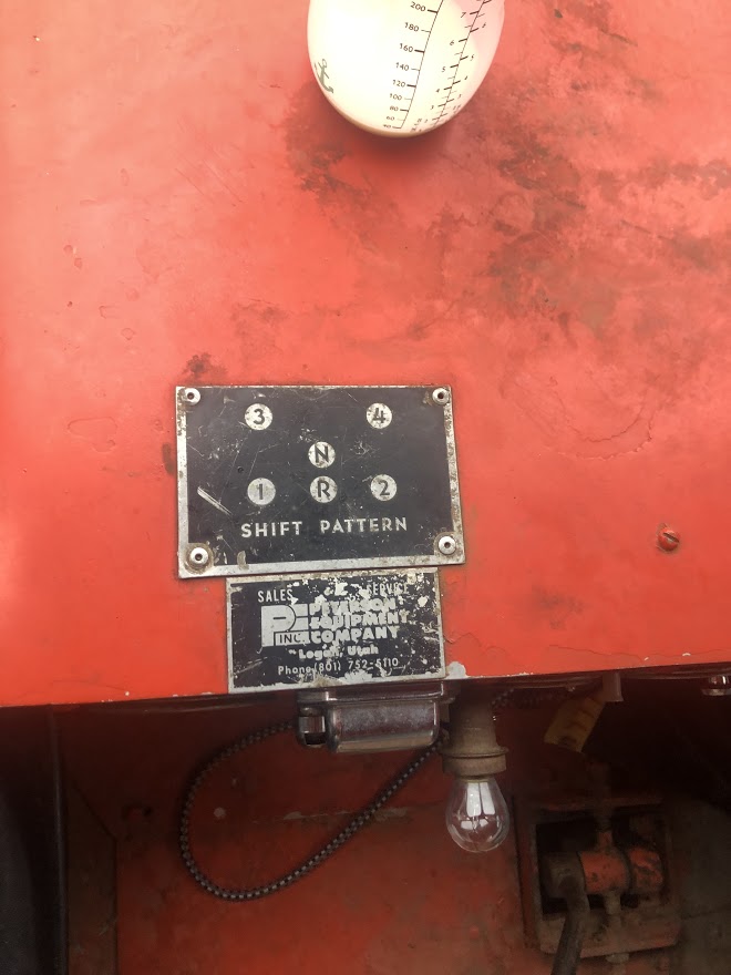

Does your Imp have the 4 speed rear axle and 3 speed tranny? By chance were you in too high a gear in the rear end?
With 12 gears available, I wouldn’t think you would be powering out.

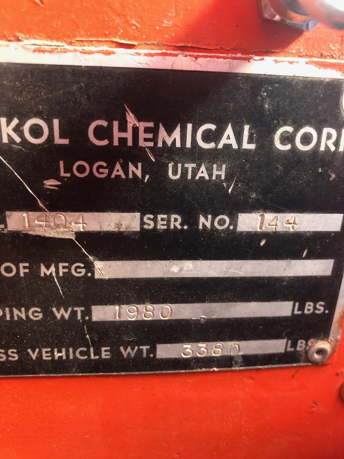

Serial number would help a lot in figuring out potential issues.
With both gearboxes in first that Imp should climb walls.

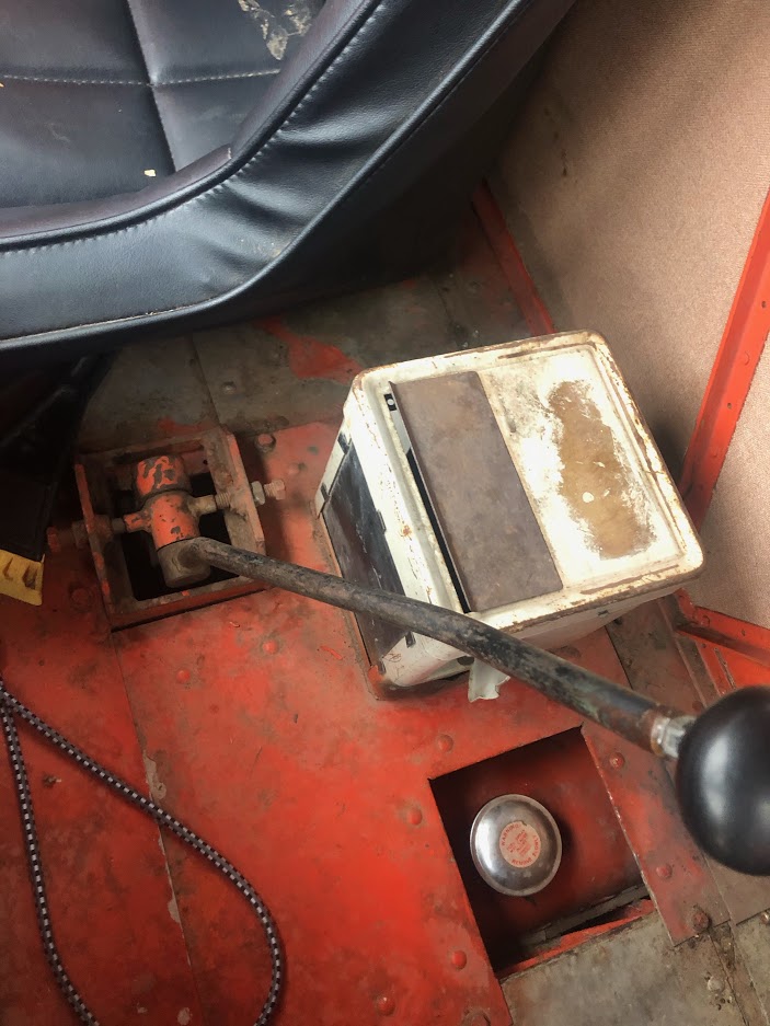

I believe this imp only has one gear box as there is only one shifter in the cab. We kept it in first gear the whole time we were climbing, we were able to put into second when it flattened out.
I've attached a picture of the info plaque. According to it its the 1404 model serial # 144 . It doesn't say the year of MFG but supposedly it's a '64

Ok? Looking at picture of front of cab. It basically slopes from the bumper to top of cab with an extension, protrusion
for the radiator. In search on google for 1402 and 1404 Imps I see no pictures with similar cab! Also the bumper/front of belly pan is different than most of 1404 pics.
The Goldcorpmines manual references machines from serial ?474? on I think so is this maybe a 1402 to 1404 transition machine using the last of 1402 parts??

I'm not with the imp so I've been having someone else take pictures of it. Here are some pics of the cab and shifter. I'm not sure if it has the shifter in the front of the diff, I'll have to check that tonight. Peterson equipment doesn't have a manual for this serial # but they said they have a history sheet that they were going to send me.
