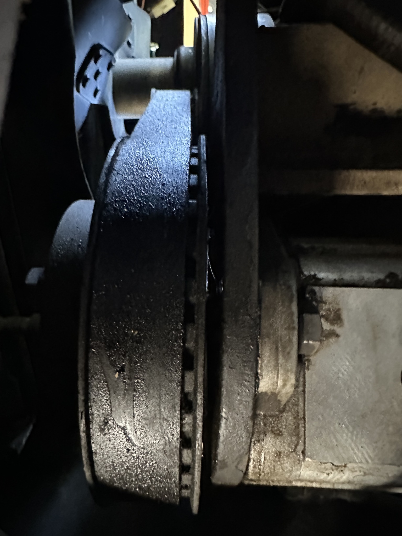

Anyone have an idea how to loosen the belt for the hydraulic pump on the LMC1500? I'm trying to install a new v-belt for my alternator, but can't get around the hydraulic pump belt. Thanks!
I ended up taking off the the threaded support rod on the right of the pump and was able to get the belt off. Unfortunately, I found out that my threaded rod receiver was completely stripped (not sure how it was still holding) and ended up ordering a turnbuckle style connector so that it's a little bit easier to loosen/tighten in the future.
