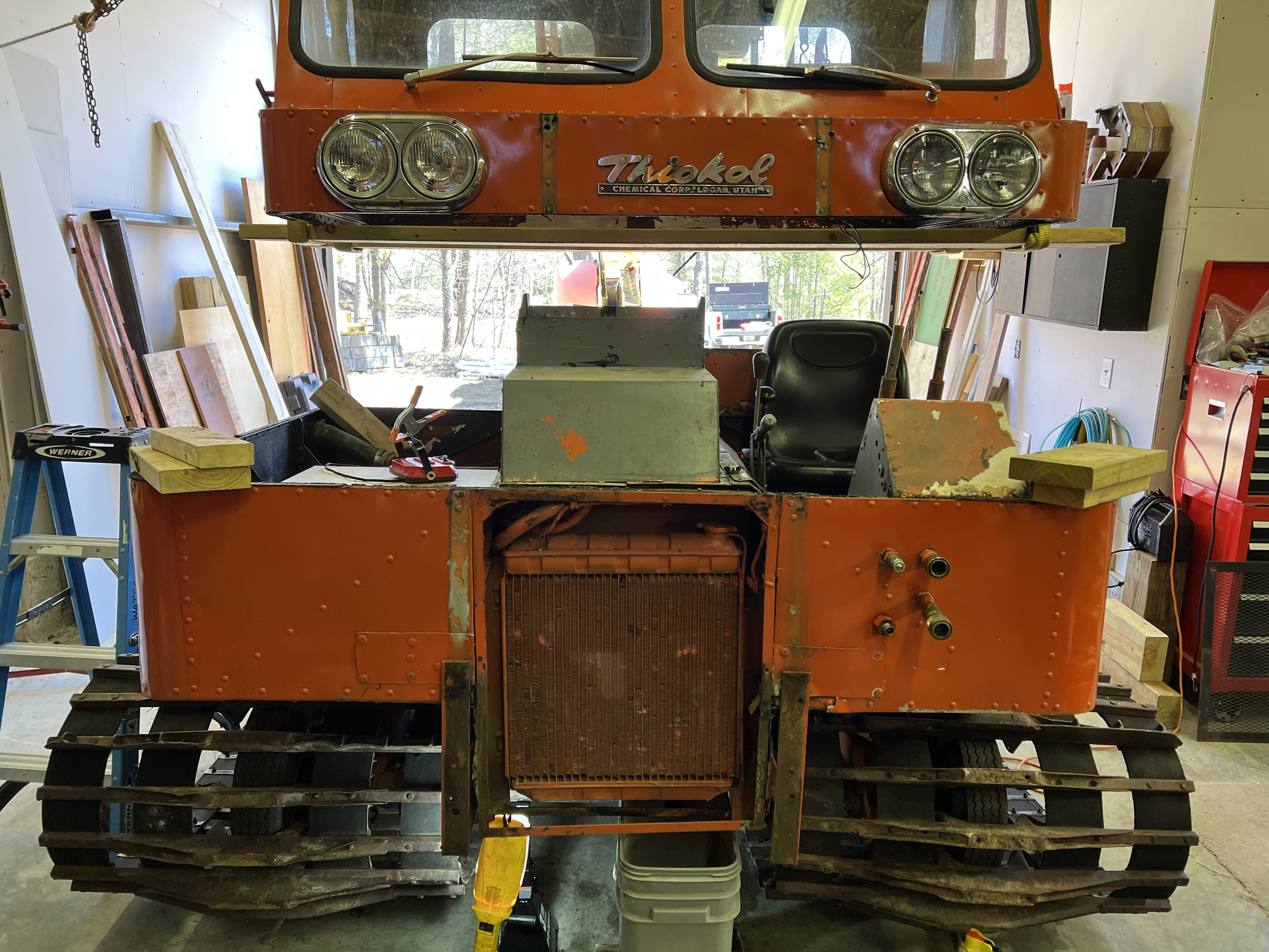

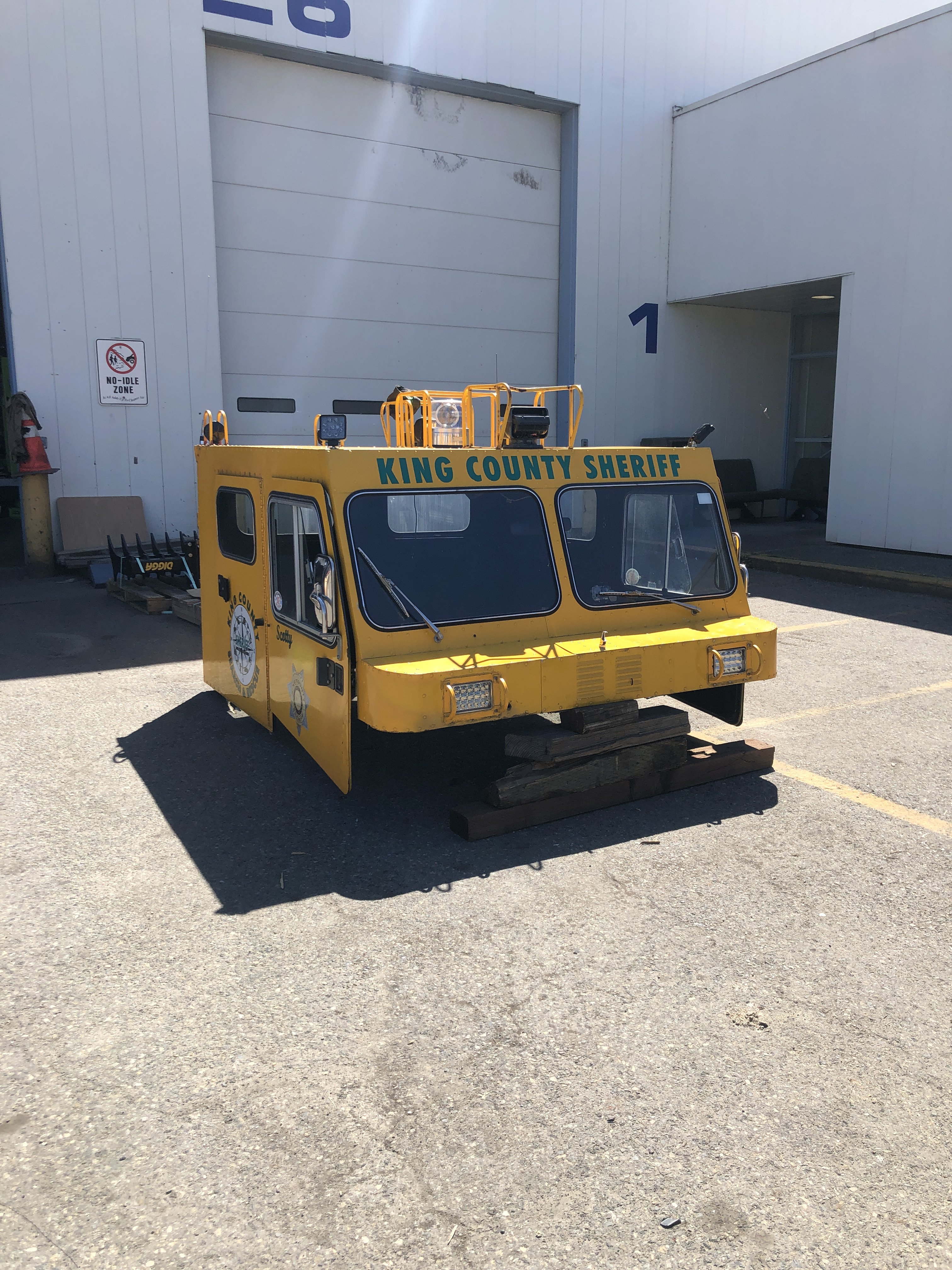

I believe the cab top has to come off. Like this one. Shouldn't be too tough once they get started on it.

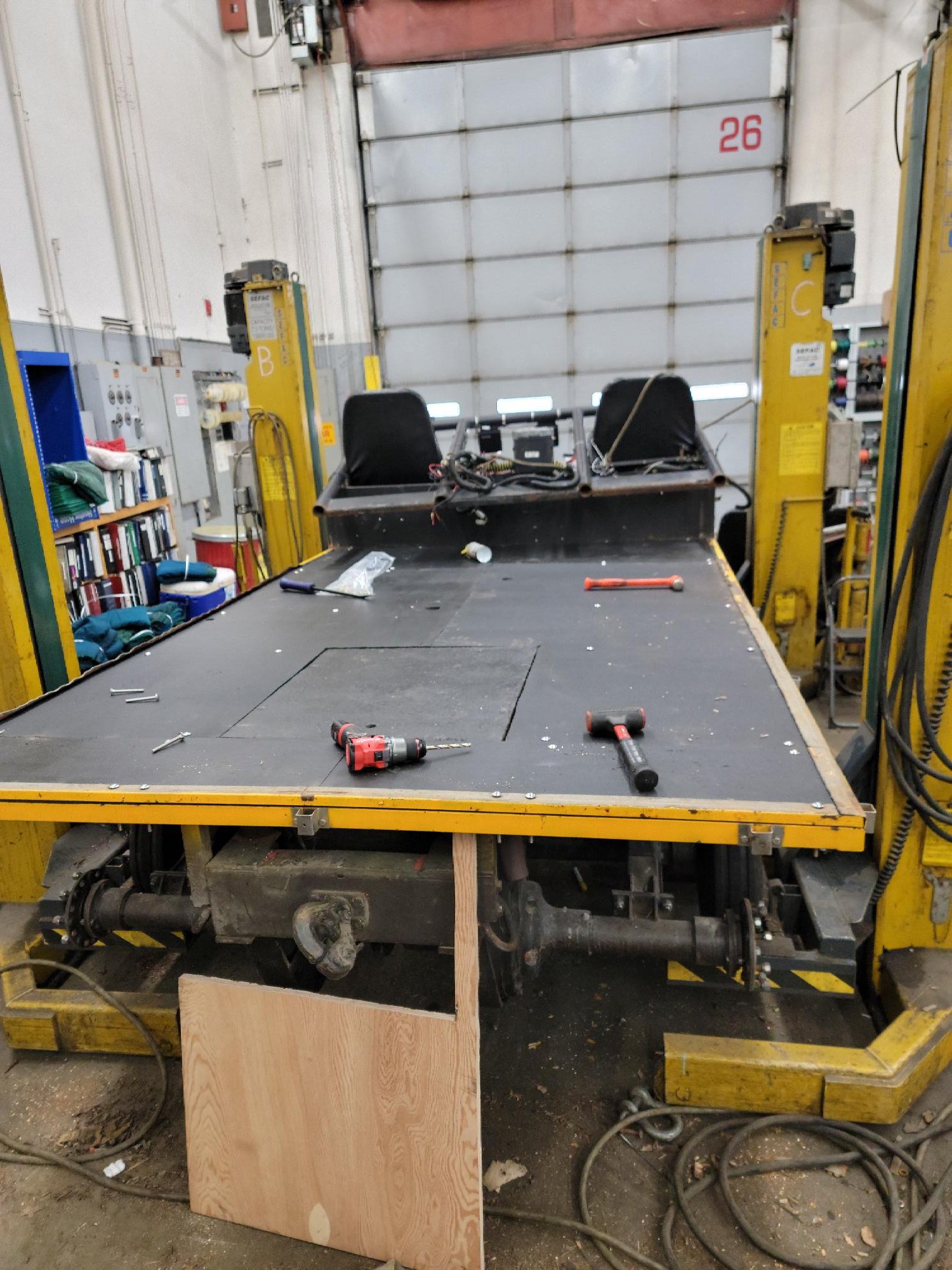

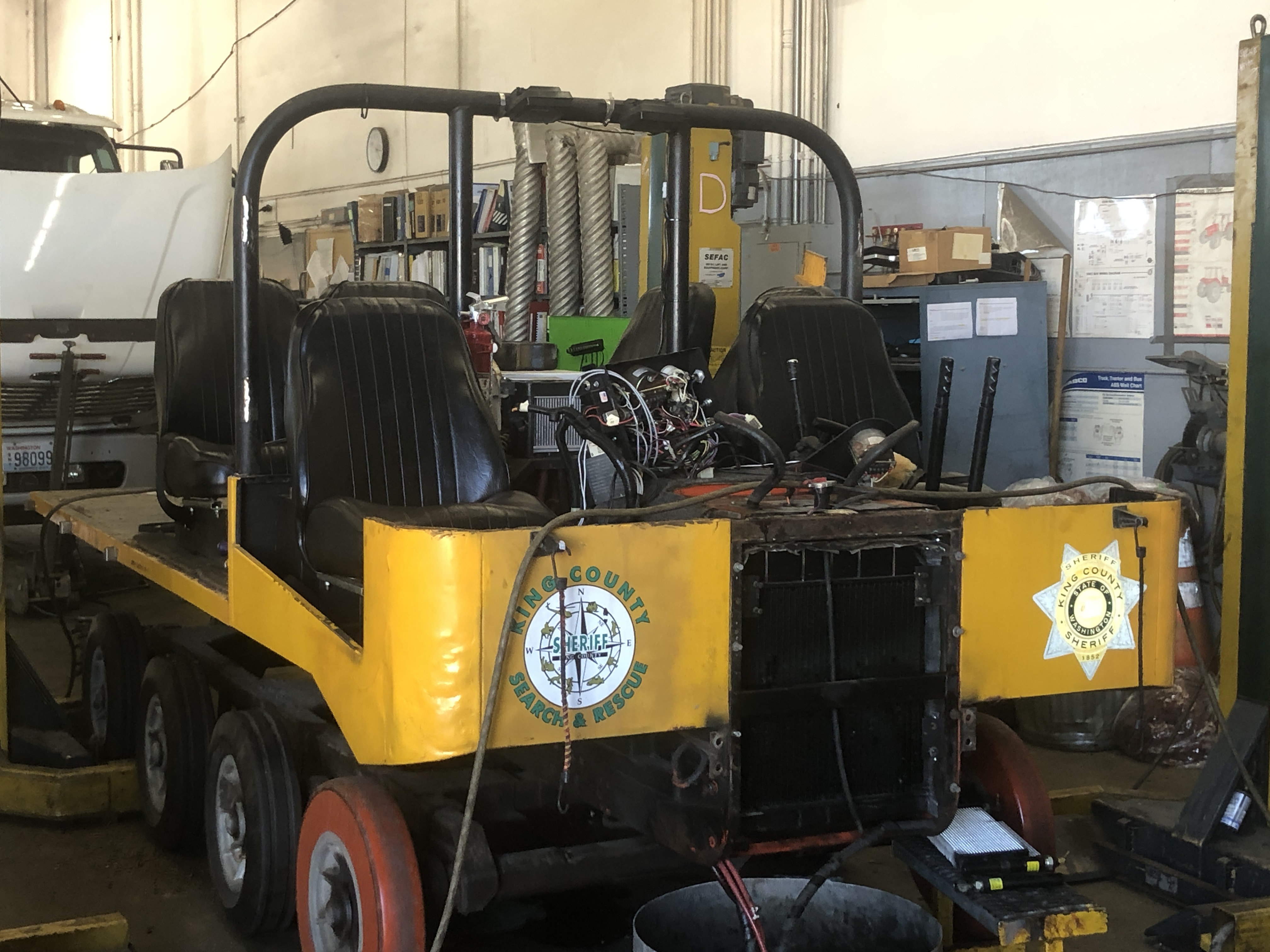

Cab split, motor out, transmission at the rebuild shop. Gonna change the pan gasket and rear main seal while it's out. The front and valve cover have been done. Also found the plywood deck under the rear seats has rotted away. That will get done too. Any thoughts on plywood vs some type of plastic?
if it were mine, I'd use pressure treated plywood. I think plastic thick enough and rigid enough would be a pain to work. I like pt plywood over paint for wet applications though if you cut it to fit and then payed close attention to edge sealing it would probably work fine painted.
I'm tending to agree with you Tom. The original deck lasted 35 years. 35 years from now I will probably have shuffled off this mortal coil and it won't be my problem.

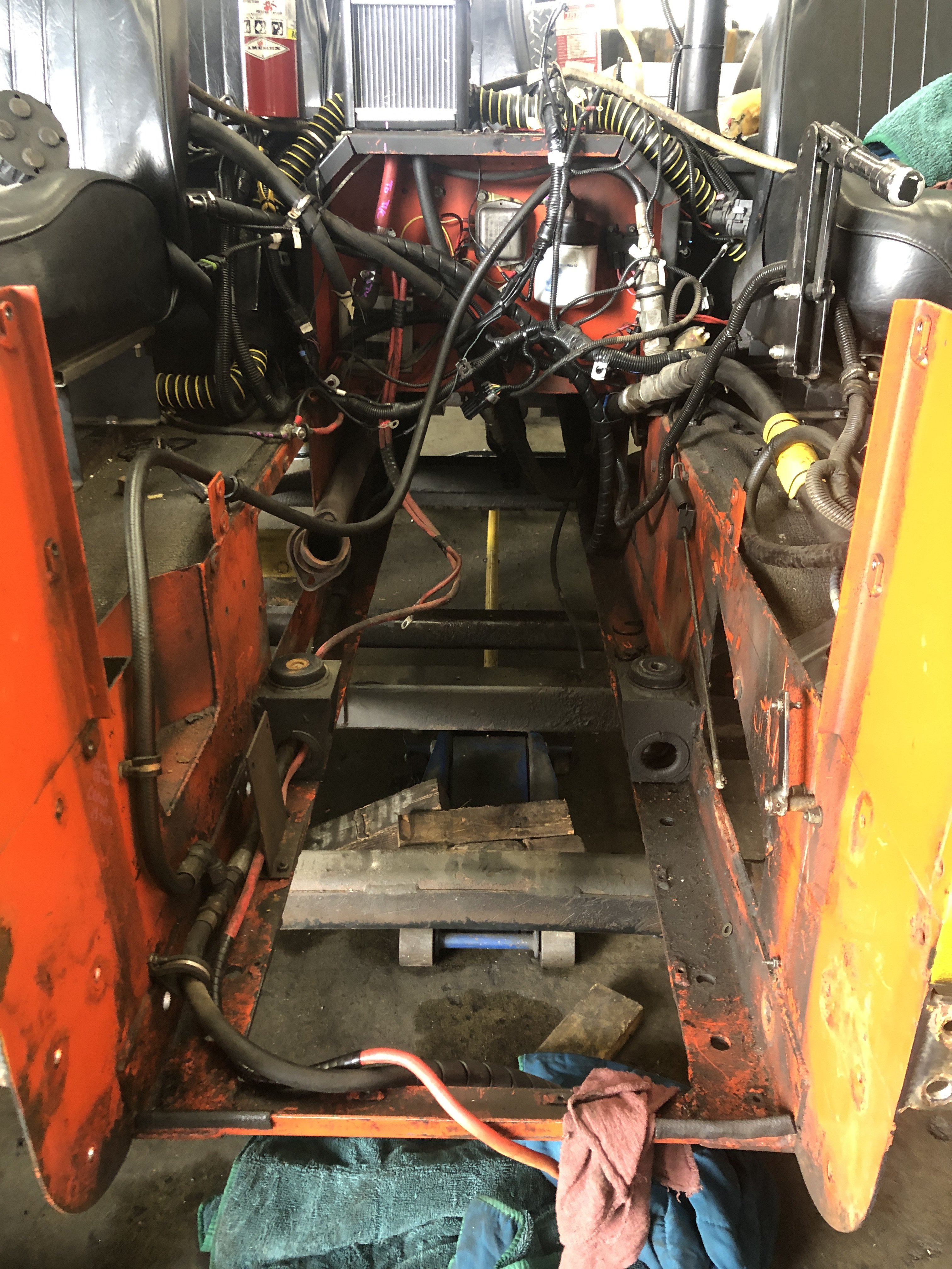

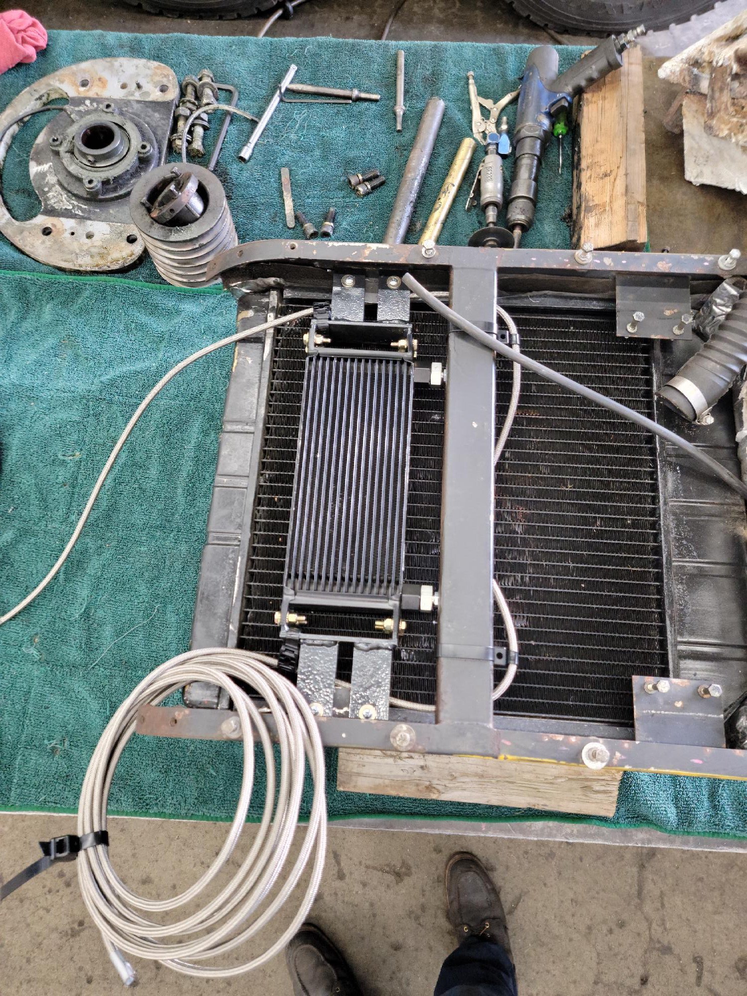

New deck. Used marine plywood and multiple coats of bed liner like material. Engine and transmission back in. While the motor was out the mechanic resealed it. Discovered that the prior owners had gooped the oil pan with orange silicone. It had pooched out of both sides. Found it's way into the pickup tube and the oil pump. Dodged a bullet. The transmission cooler was completely redesigned.
