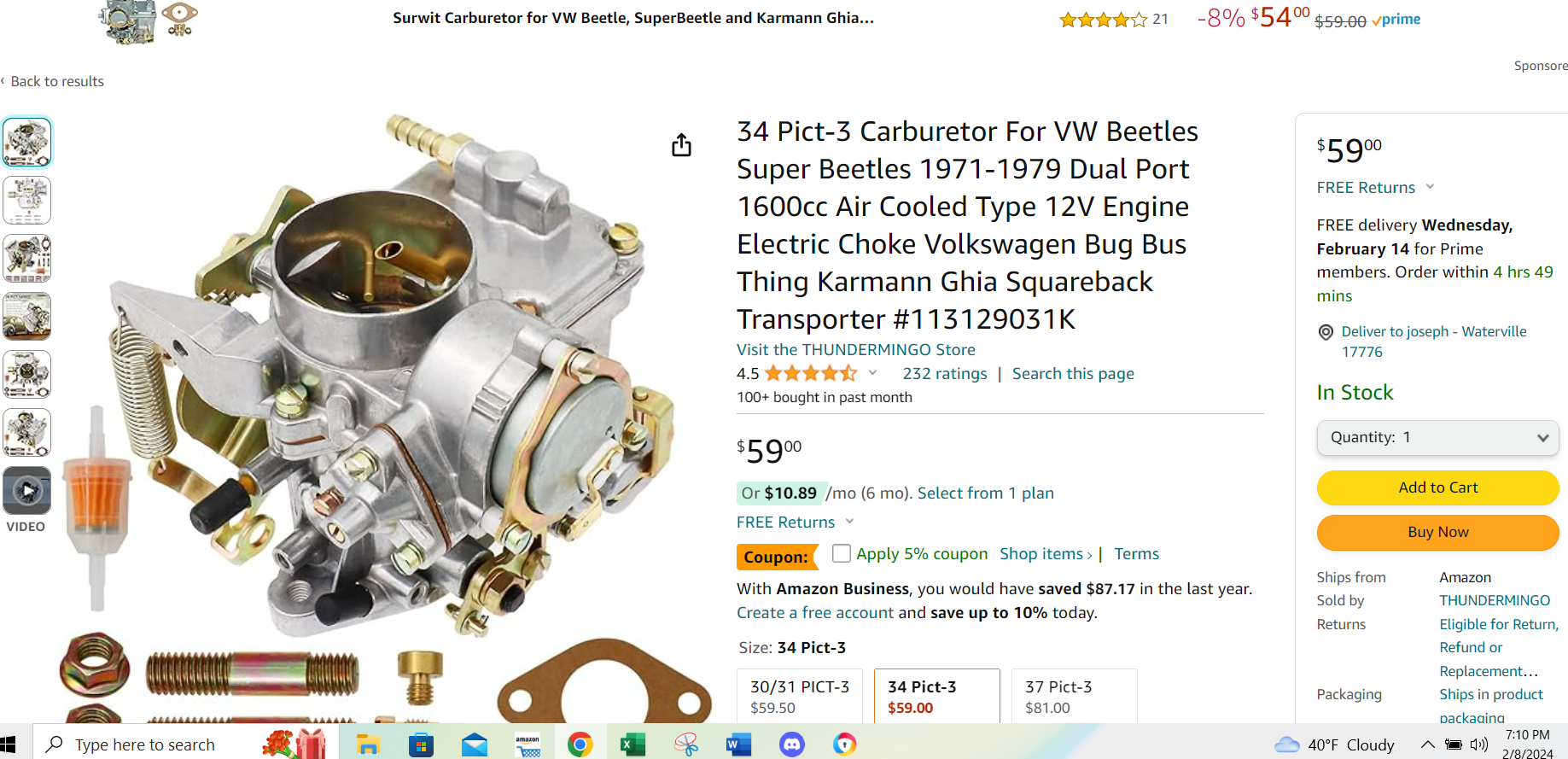

I'm assuming you need down draft carb ???
I got looking for one for my polaris and this popped up for Volkswagon's
link
I'm focused on Webers only, not some unknown brand made in some country other than Spain that perhaps starts with a C. Yes, must be downdraft. 34PICT's were typically used for dual carb setups on VW's. Would require a lot of rejetting and no idea what venturi size they used. Late in the Ford V4 Essex history they switched to a Weber 32DIF...good luck finding one.
