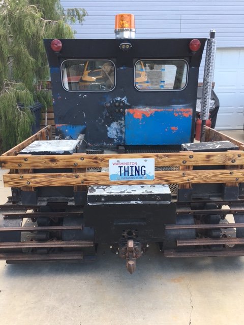

My tank sits on the bed against the passenger side cab. Just guessing but it's probably 30x24x8 rectangular, low enough to sit a few inches below the window.
Here's a shot from before painting

Does the fuel tank have a opening on top to add the fuel? Or did you create a custom fuel neck delivery system to add fuel to it?
On my Imp, one of the previous owners removed the fuel neck that exited the cab in the middle of the rear deck.
If they had left it installed, you would add fuel to the onboard tank from the rear of the Imp, instead of creative funnels between the two front seats.
There's a cap left of center on the top but can't really see it in the photo. Where the stock tank would have been (I guess) instead I have a hydraulic oil tank and controls from the front plow and rear attachments.
