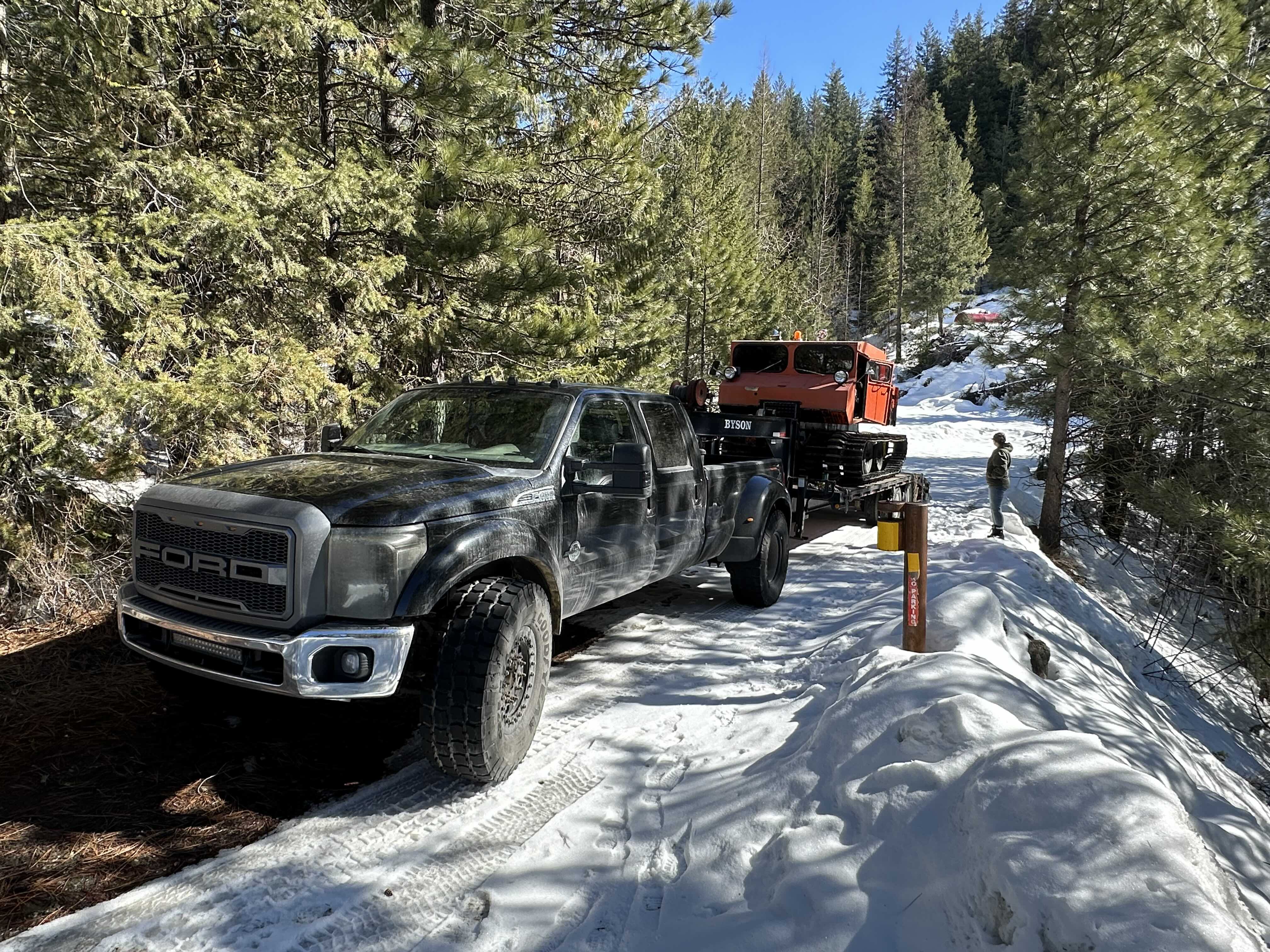

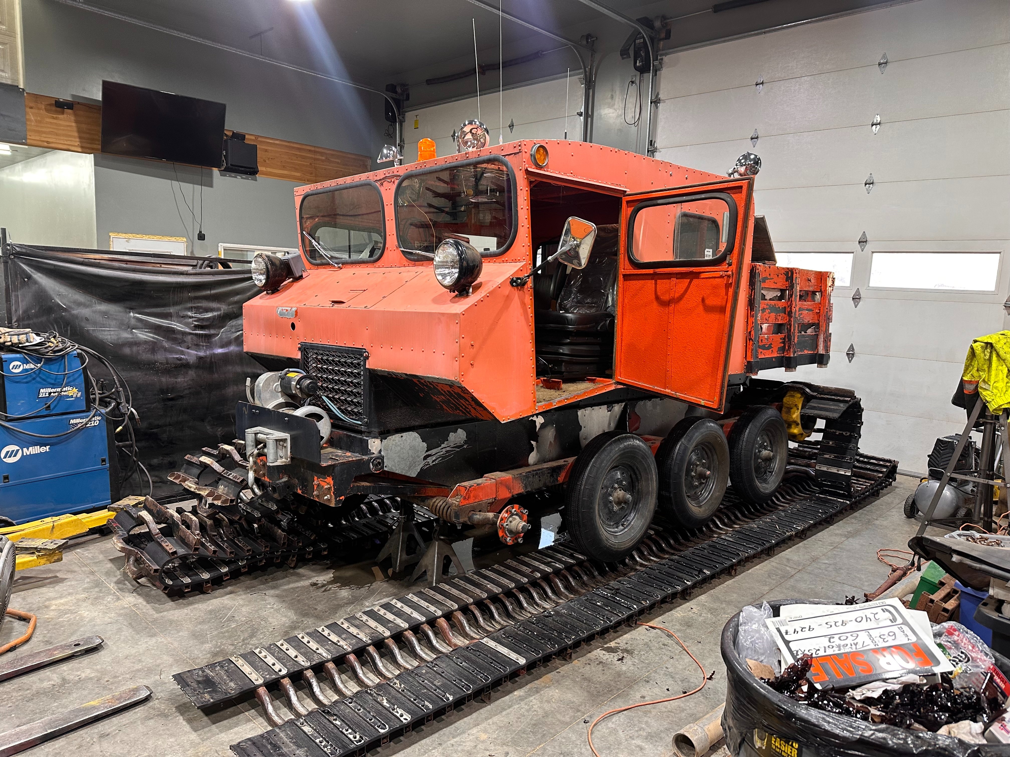

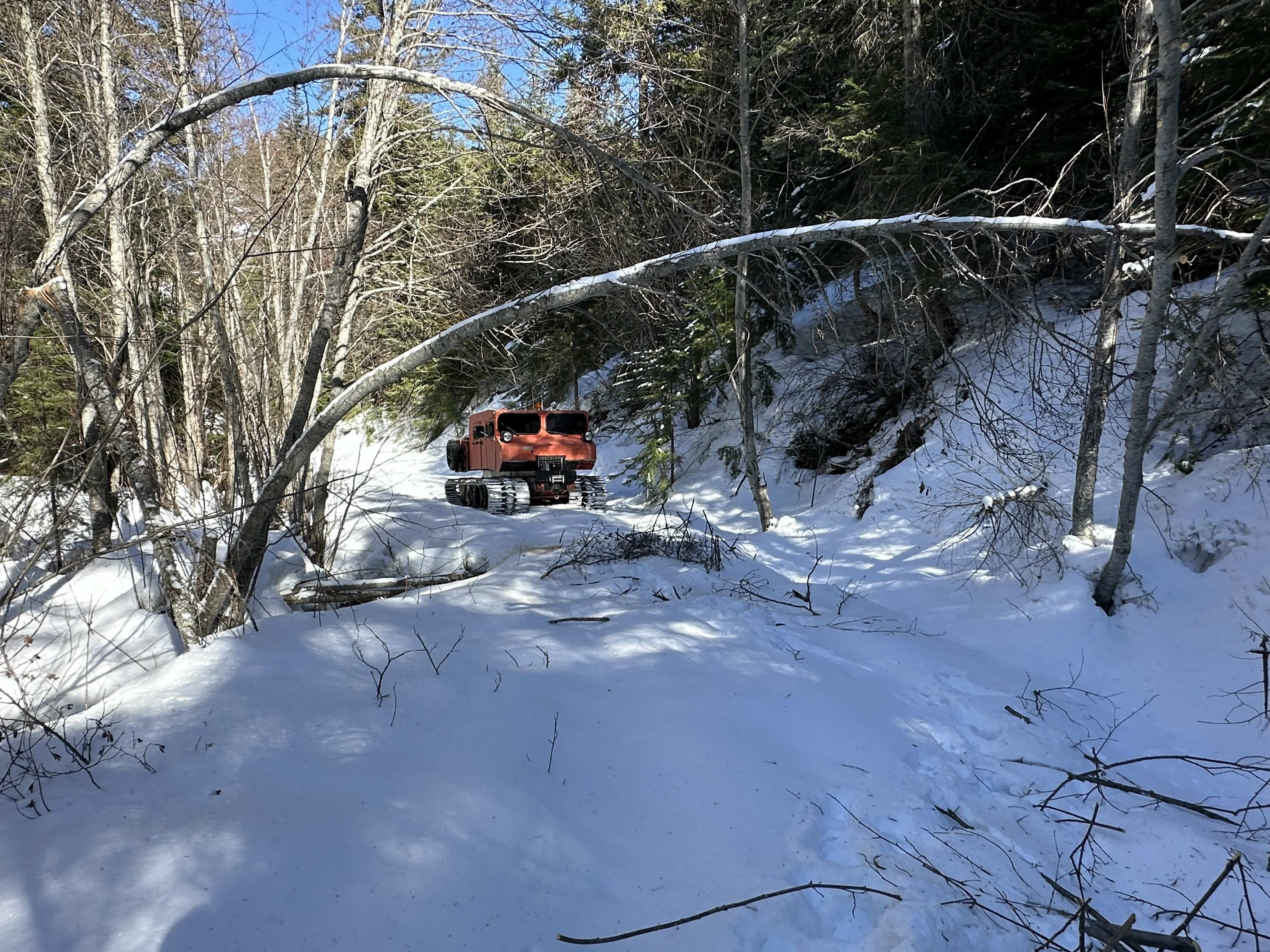

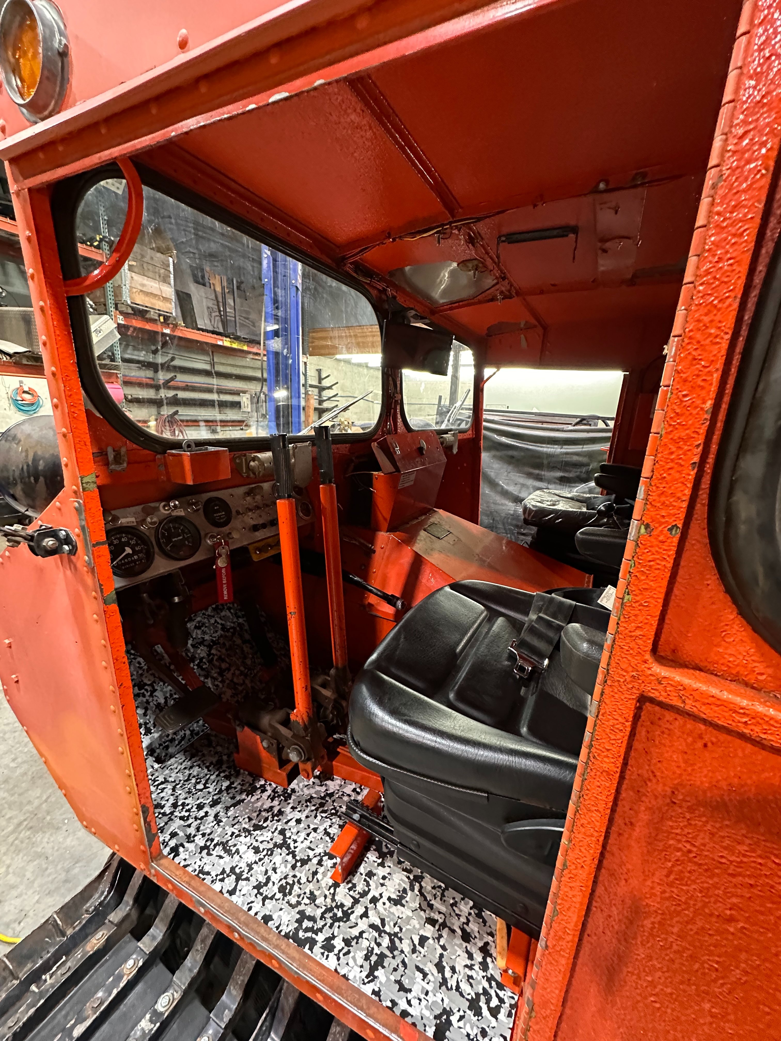

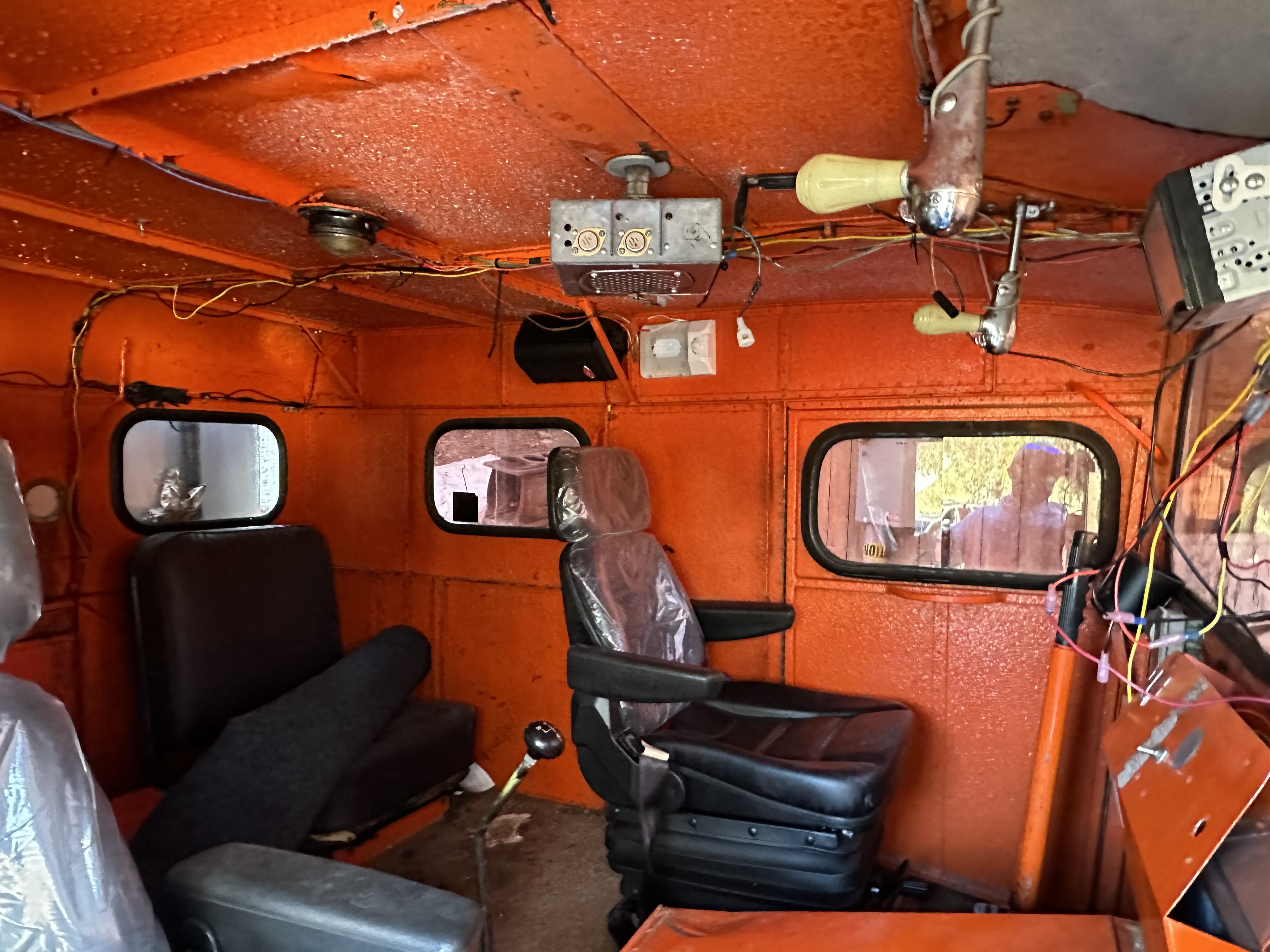

Here are some pictures of the machine I just bought...

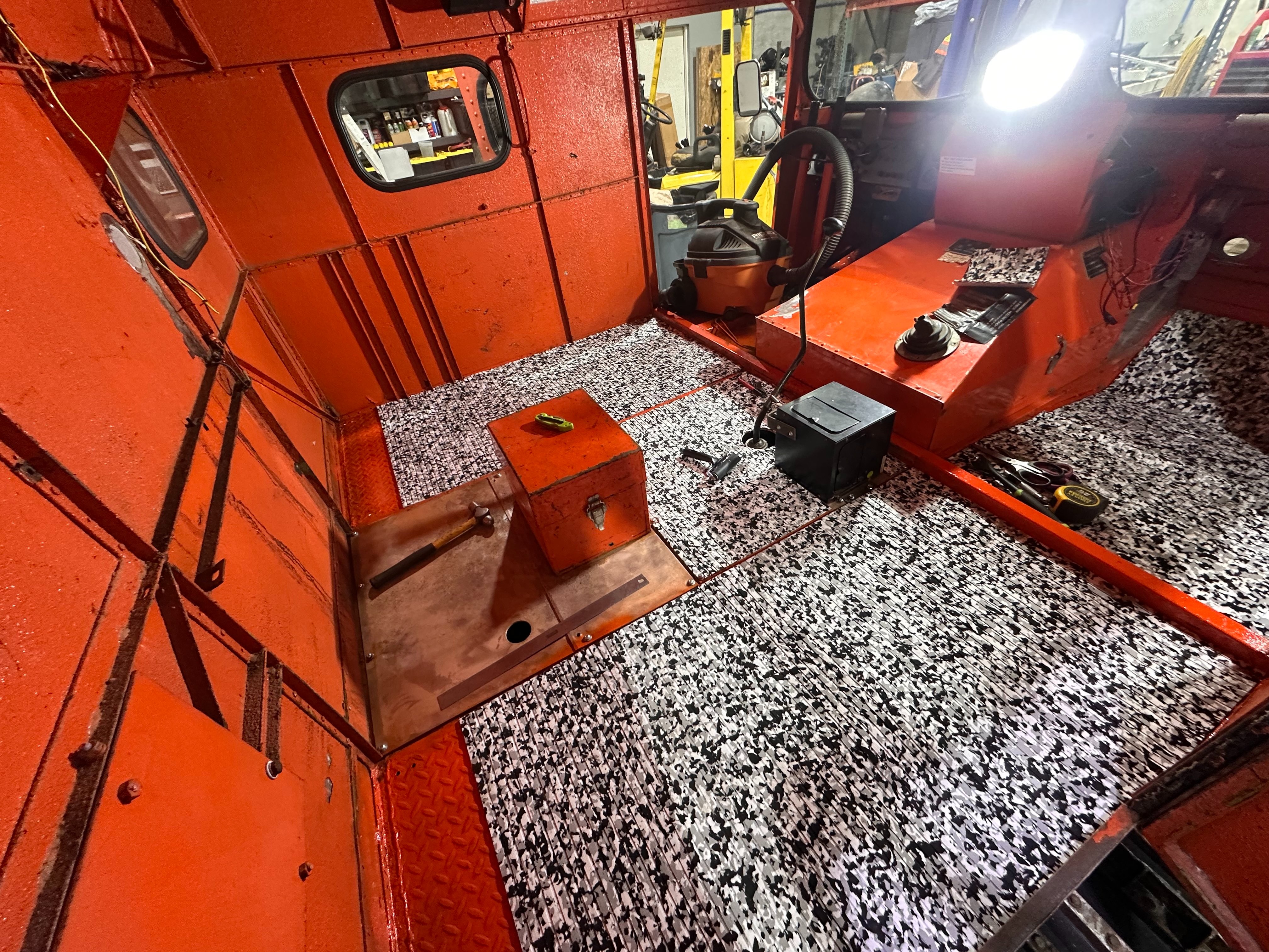

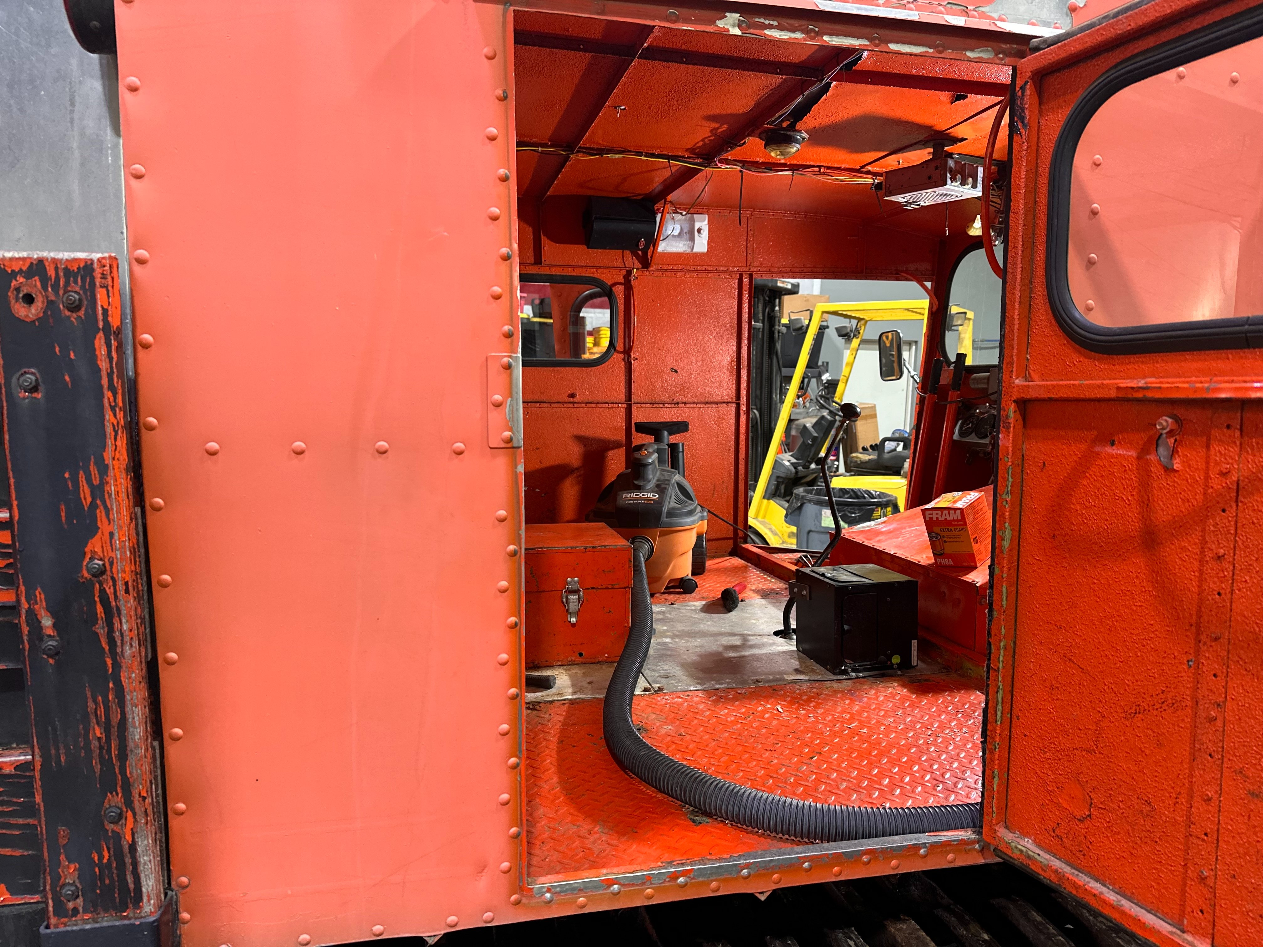

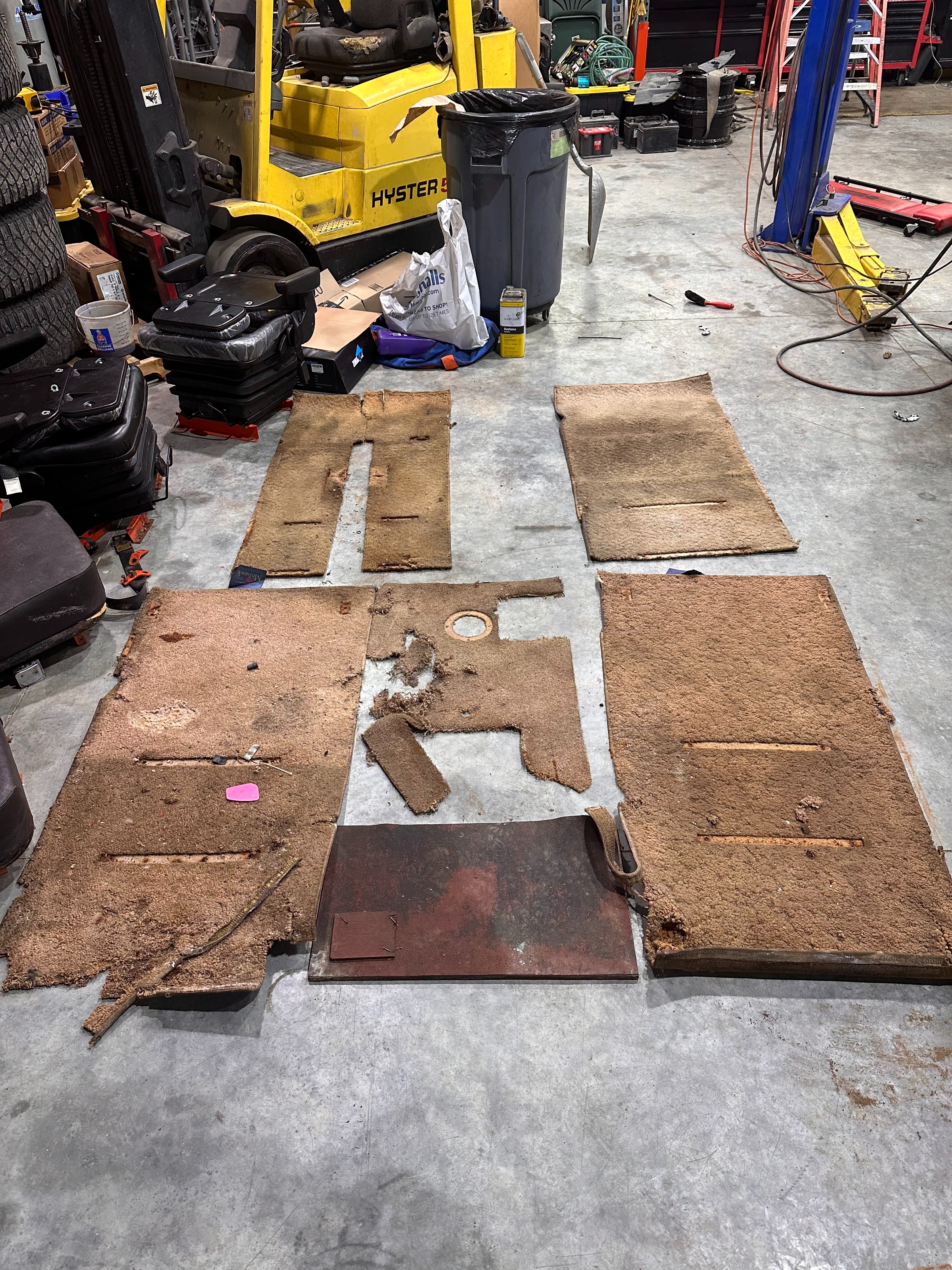

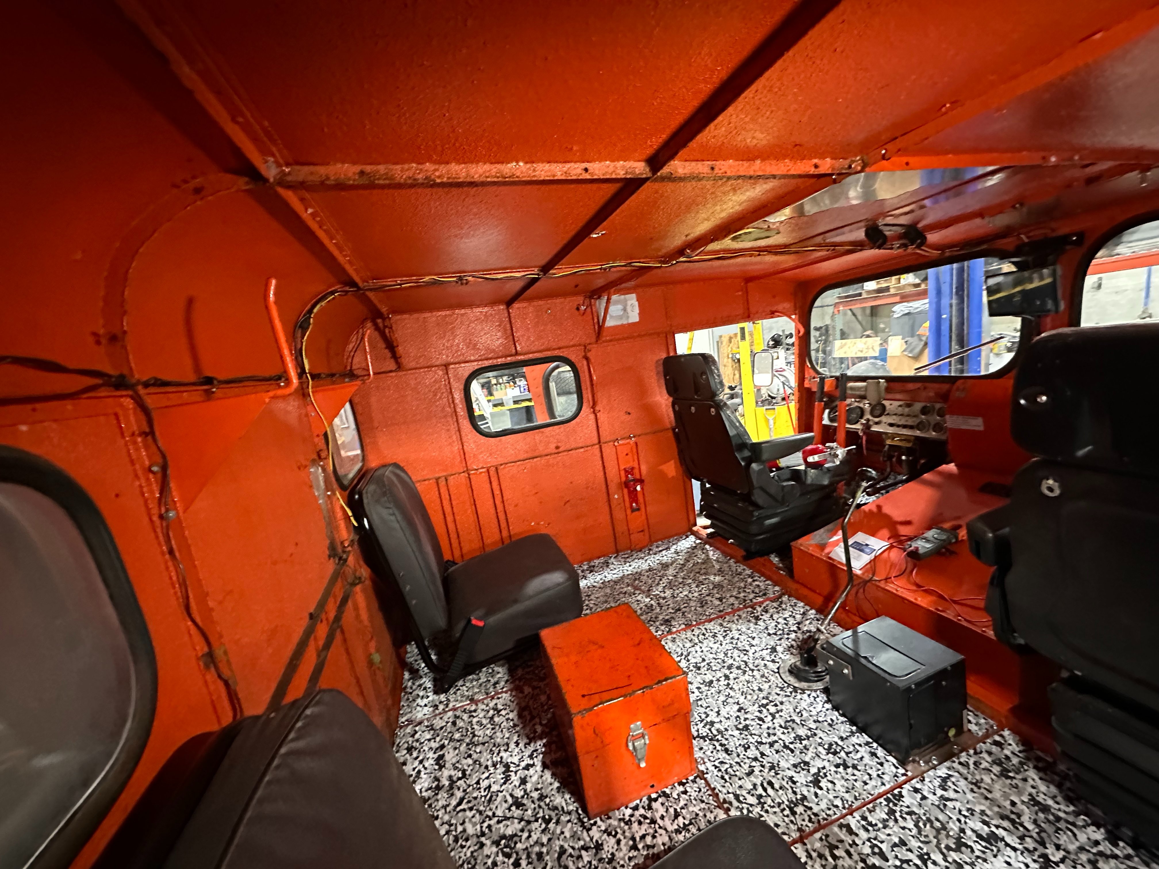

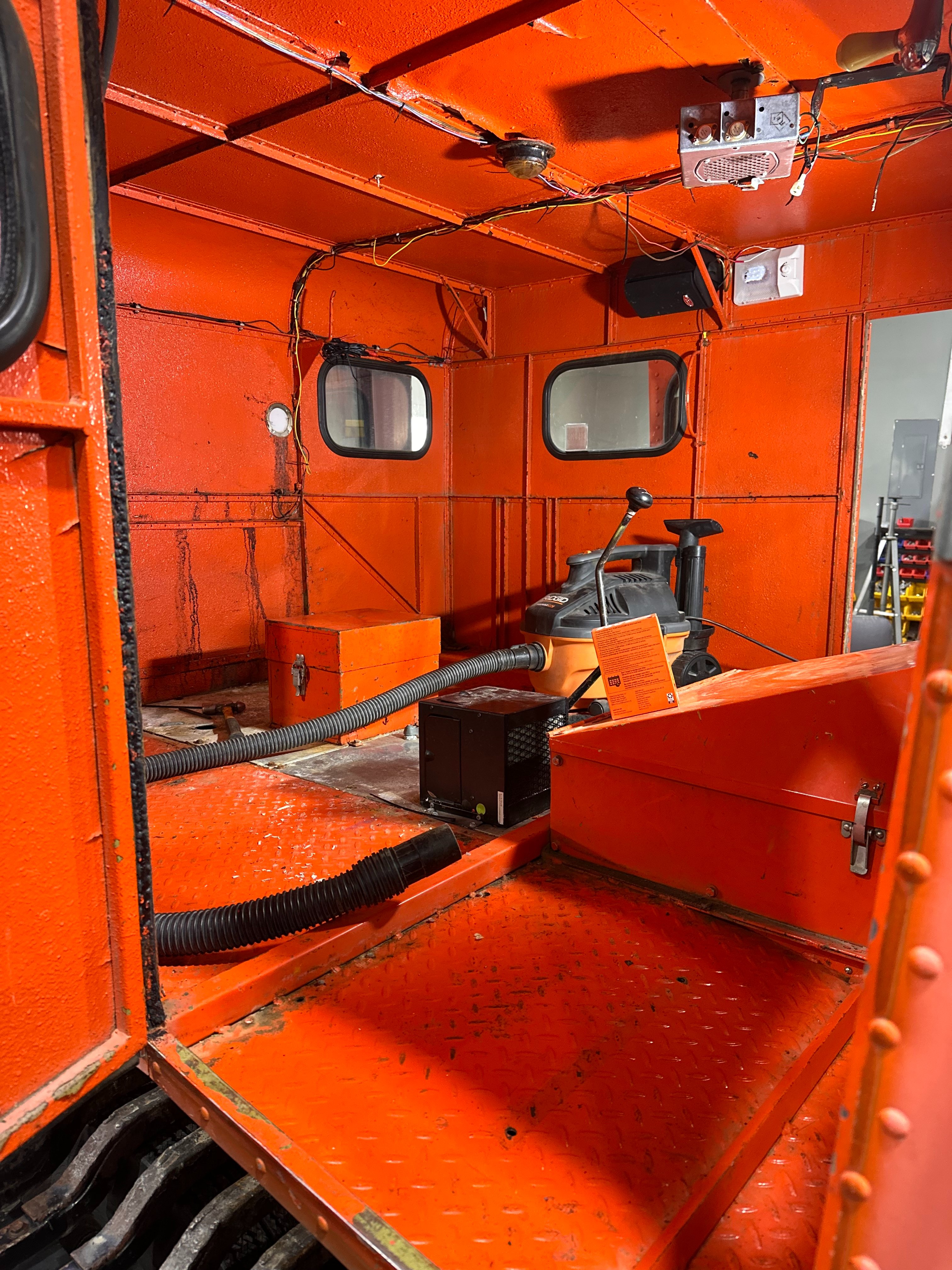

My work season was very busy last year so unfortunately the machine sat all summer. Since winter is my offseason, I was finally able to pull the machine into the shop and start doing some needed maintenance on the tracks, clutch and brakes. I had multiple broken grouser bars, broken backing plates, leaking brake slave cylinder, and leaking clutch slave. The interior had 80's shag Mohawk house carpet which just absorbed moisture, and made it musty and moldy. Thankfully the floors had minimal rust started and when it was removed I mitigated the rust spots, primed and touched up the paint.
I decided to try out boat deck foam. I wanted something that worked well in wet environments and was fairly easy to clean. So far I'm quite pleased with the decision. We will see how well it holds up over time.

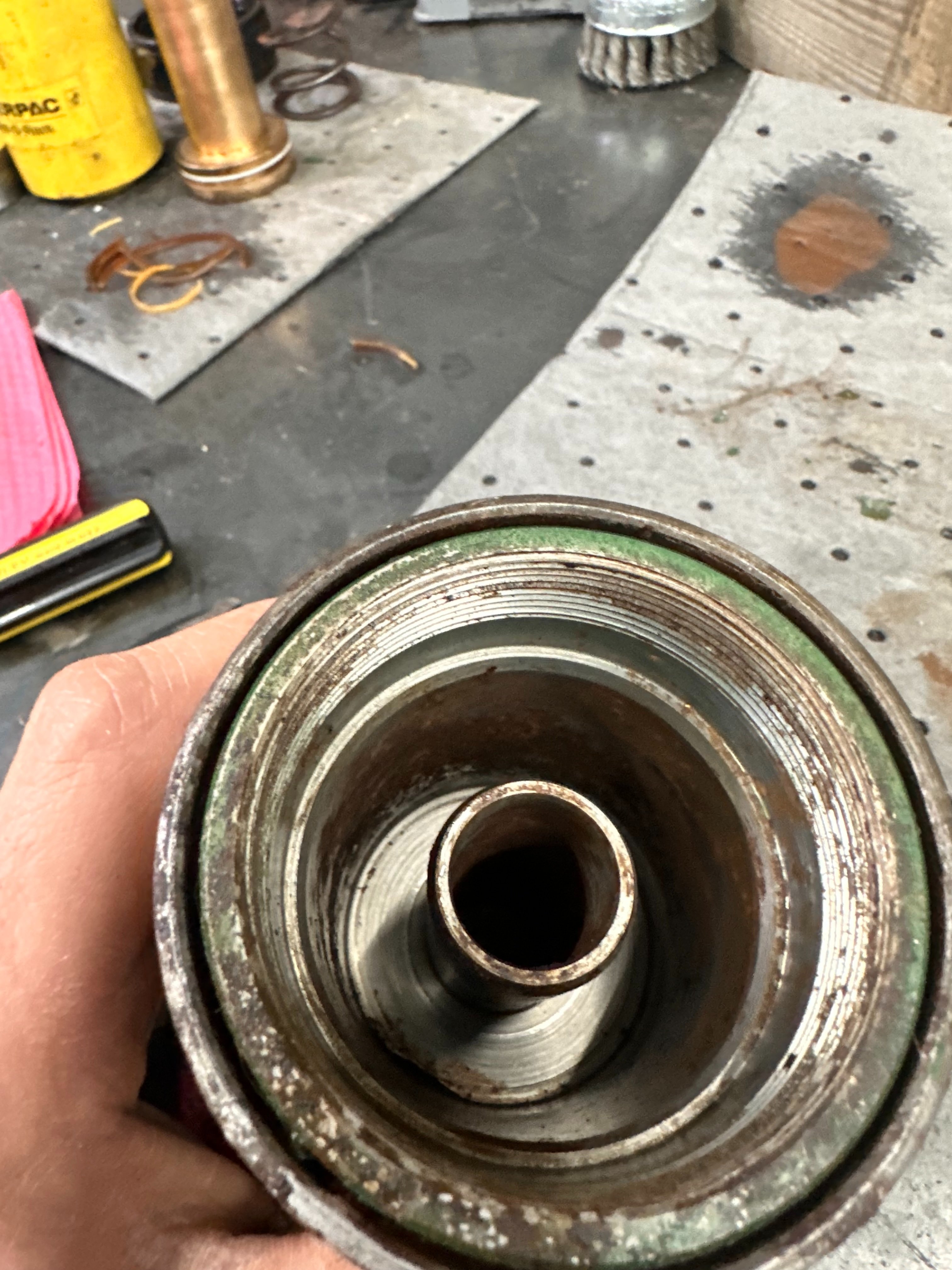

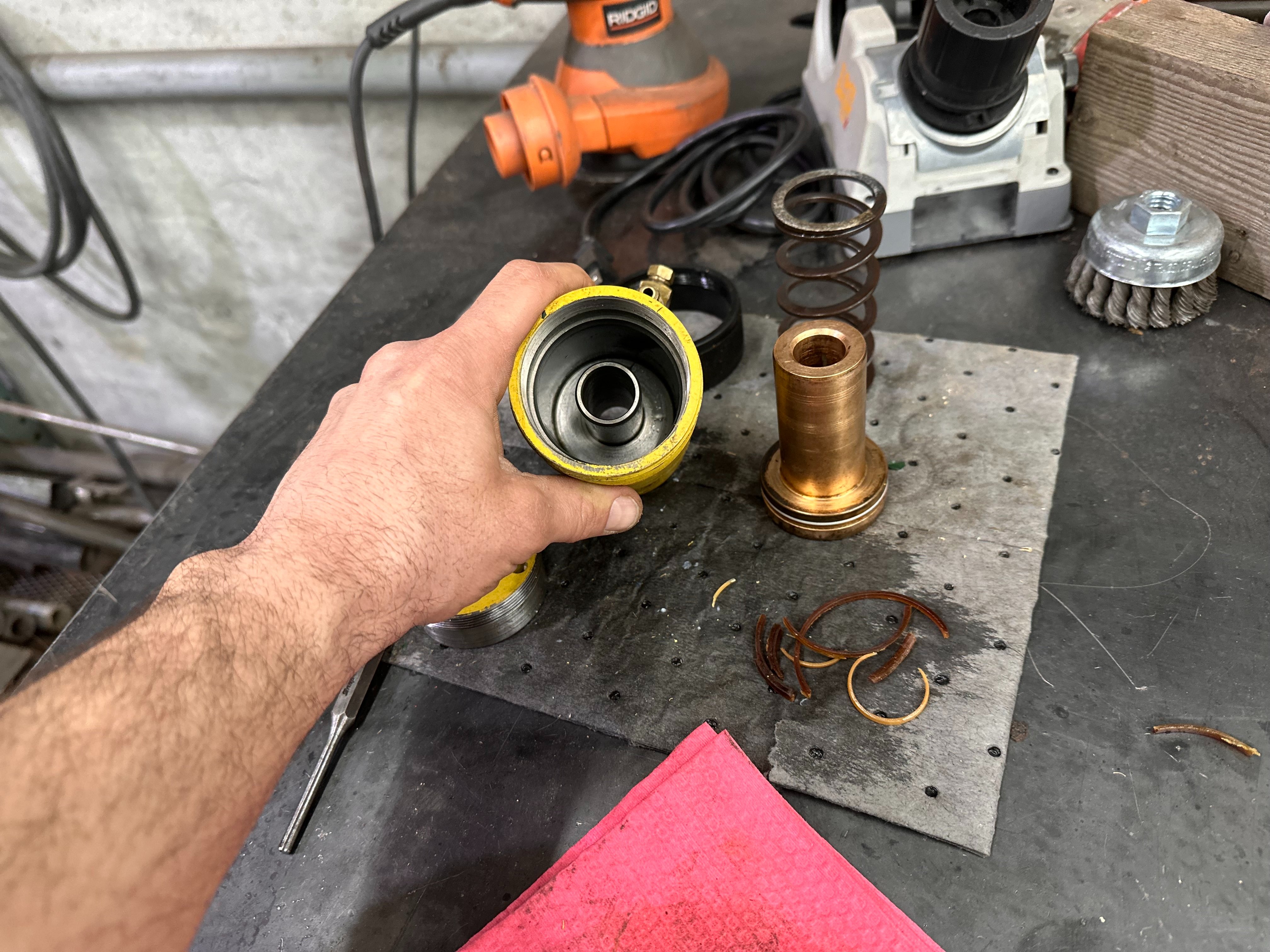

After purchasing it and installing the new one, it sprung a leak and defeated the whole purpose of the new purchase. Not wiling to buy another one, I ordered a seal kit and pulled it apart. The new one just had old seals that I think went dry sitting on the shelf and I can't get too mad on it for failing. Just for curiosity sake, I pulled the old one apart and found that it had pitting on the cylinder walls and was un-usable anyhow, making my purchase for the "new" ram worthwhile.

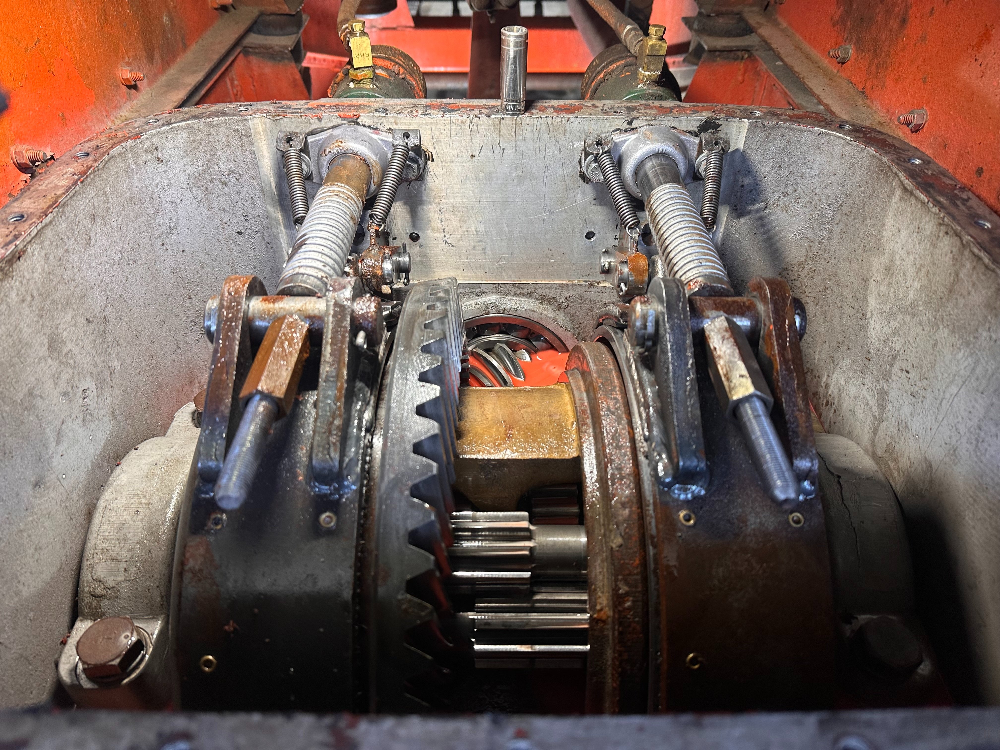

To remove the brake cylinders, it requires you to pull the diff cover off. I had seen pictures of these and knew from the size it was a big differential, but I didn't expect to truly massive that OC15 is. Another bonus was getting to check on the condition or the brake bands to see if they needed to be relined. Upon removal of the cover, I found a differential, filled with over a gallon to 2 or water along with oil. It drained at minimum 2 gallons of water before the milkshake started to drain out. Seeing this I was able to figure out a good reason my brake effort was so incredibly high.
After flushing out the housing with 10 cans of brake clean, I checked the brake linings to find them in near new condition. They must've been relined at some point in its lifetime. Rust on the components was minimal and the bearings seemed to be in ok usable condition. I'm at a loss how this much water got into the housing.
Since I service most of my heavy equipment, I thankfully had 10 gallons of the proper wet clutch differential oil on my shelf for my D6. I got everything all cleaned up and ensured the diff cover was properly sealed this time.

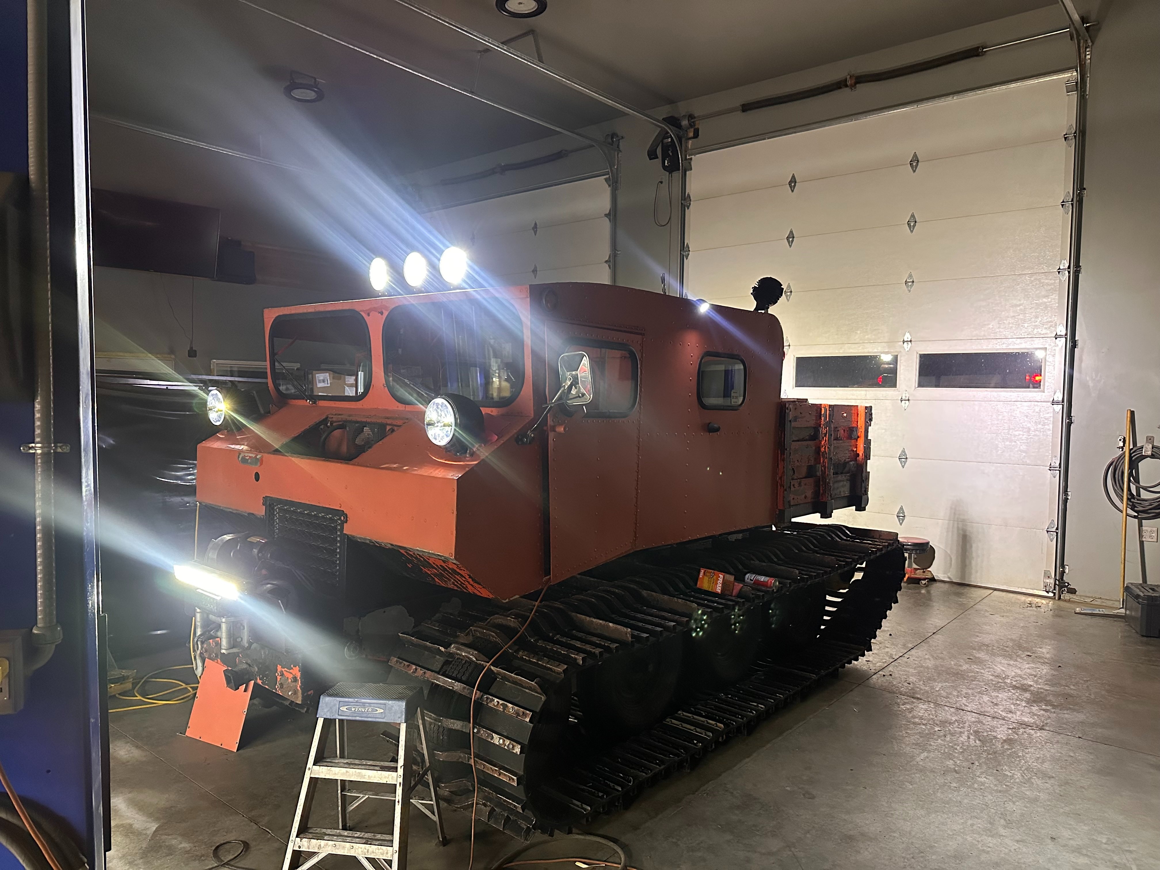

Another area I wanted to address was the lighting system. There's no reason to use incandescent lighting on anything these days, and I would always rather have more than not enough lighting on a vehicle, especially offroad and remote. I didn't want however to take away from the nastalgic look of the vintage era of the Thikol, so I kept round lights on all exterior lighting. The original headlight buckets have been updated to clear sealed LED units with functioning high/low beam. The overhead round lights replaced movable searchlight units. I also removed all the old antenna's which were abandoned previously. I will update the coms radio shortly with a new 10w shortwave unit i have.

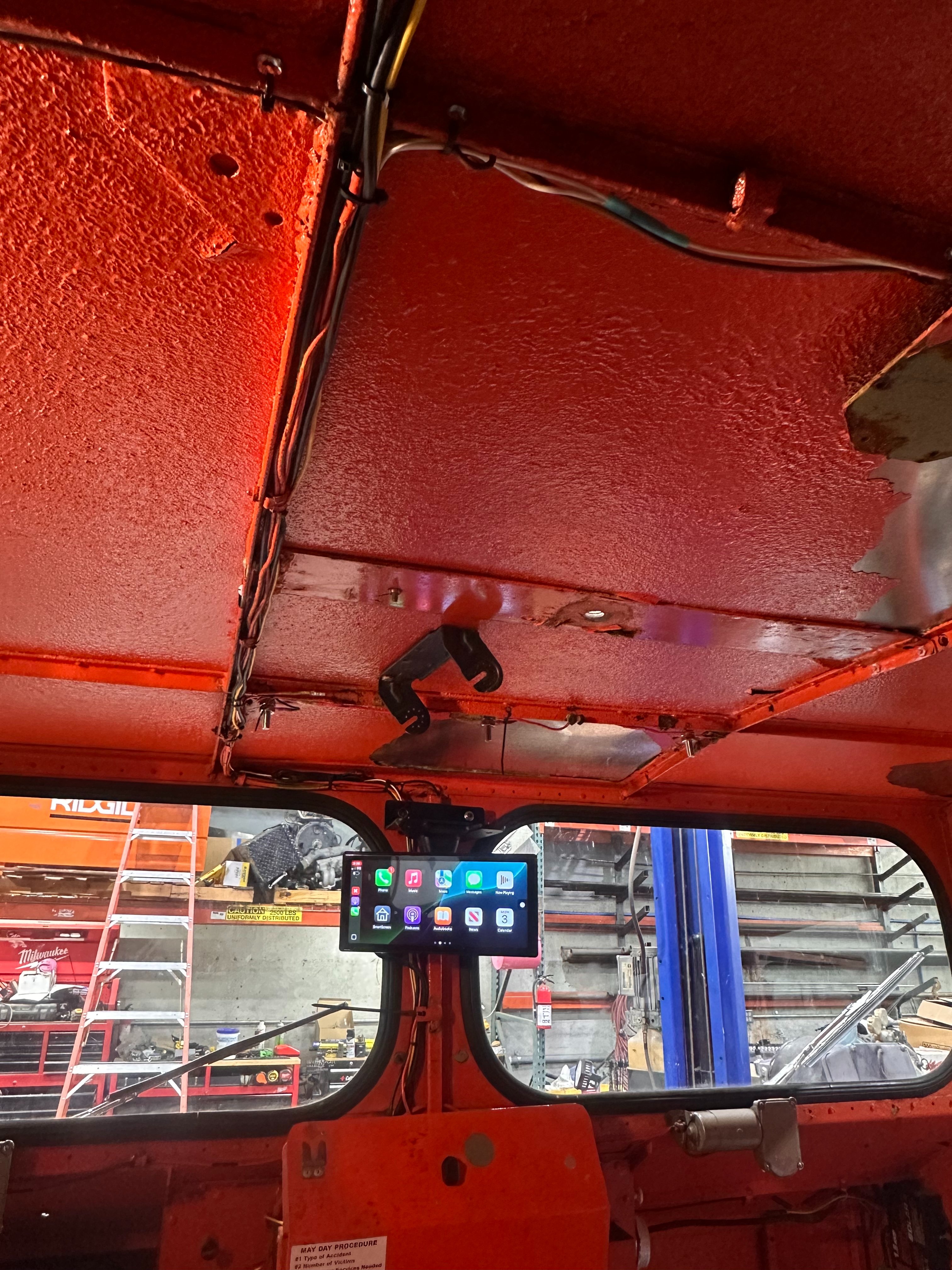

Another real drawback on this machine is the limited rear visibility with the 80 gallon fuel cell blocking the rear windows. I always add good camera systems to my heavy equipment and found this great 10" unit with a 4 camera capability last year. What I really like it the ability to sync my iPhone to is and use my OnX mapping on the screen. I don't need some car stereo head unit and just want simple camera and mapping capabilities. I only have 1 camera hooked up at this time but might add side cameras as well. If someone wanted to, this can also record the video feeds as well. Not a bad system for around $150 (Ignore the lines in the screen shot of the camera feed its the frame rate of the video feed picking up the shadows of my ceiling fan. Its completely clear to the naked eye)

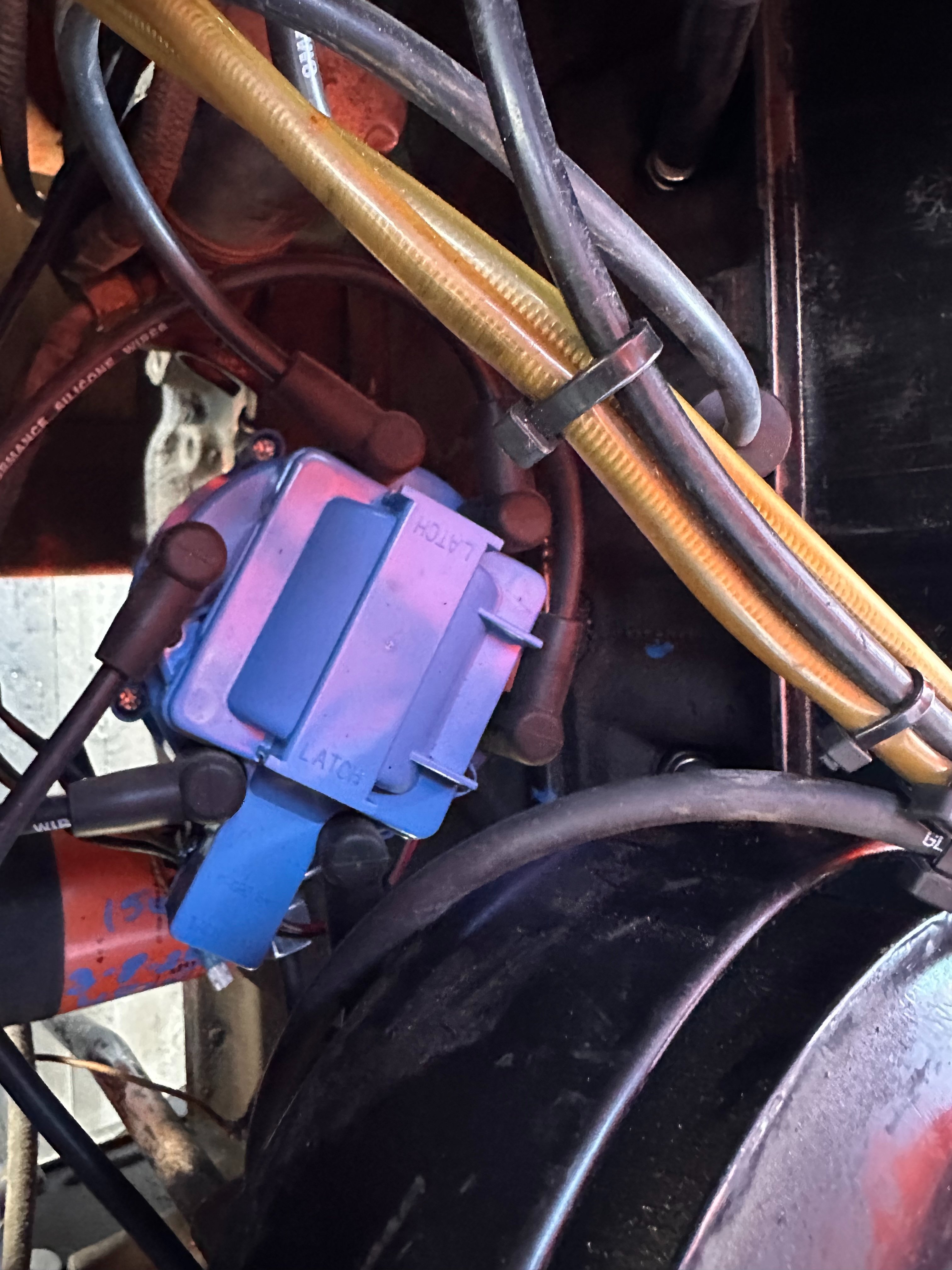

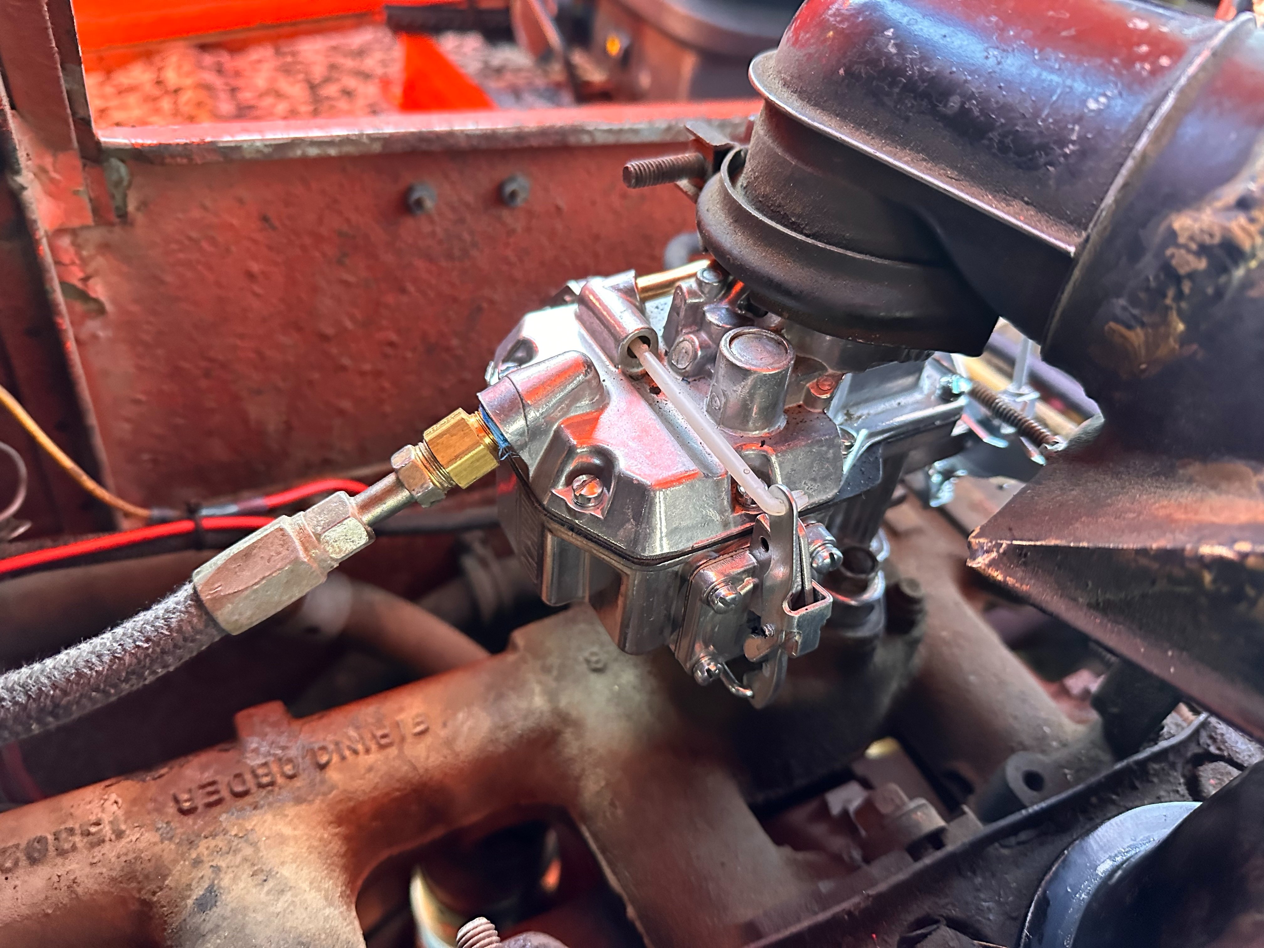

Lastly, I wanted to try and tune up the motor some more. I found that the stock Motorcraft single barrel carb was leaking and enough that it likely could've caused a fire being right on top of the exhaust. I did a little digging around and trying to rebuild the carb seemed like just buying a knockoff on Amazon was likely be more efficient use of my time. I got that replaced and plumbed along with an HEI ignition conversion with new plugs and wires.
I haven't noticed really any noticeable power advantage, but maybe after a few more miles, I'll see if theres any noticeable improvement. Another upgrade I'm likely going to do is an electric fan conversion. By doing this I will not only pick up the HP loss made by the fan, but get rid of the plain obnoxious noise it makes. Any RPM over 1000 it gets very loud and adds a lot of cabin noise. The machine always has stayed nice and cool, so hopefully getting the largest electric fan installed will be as efficient as that mechanical fixed fan is.

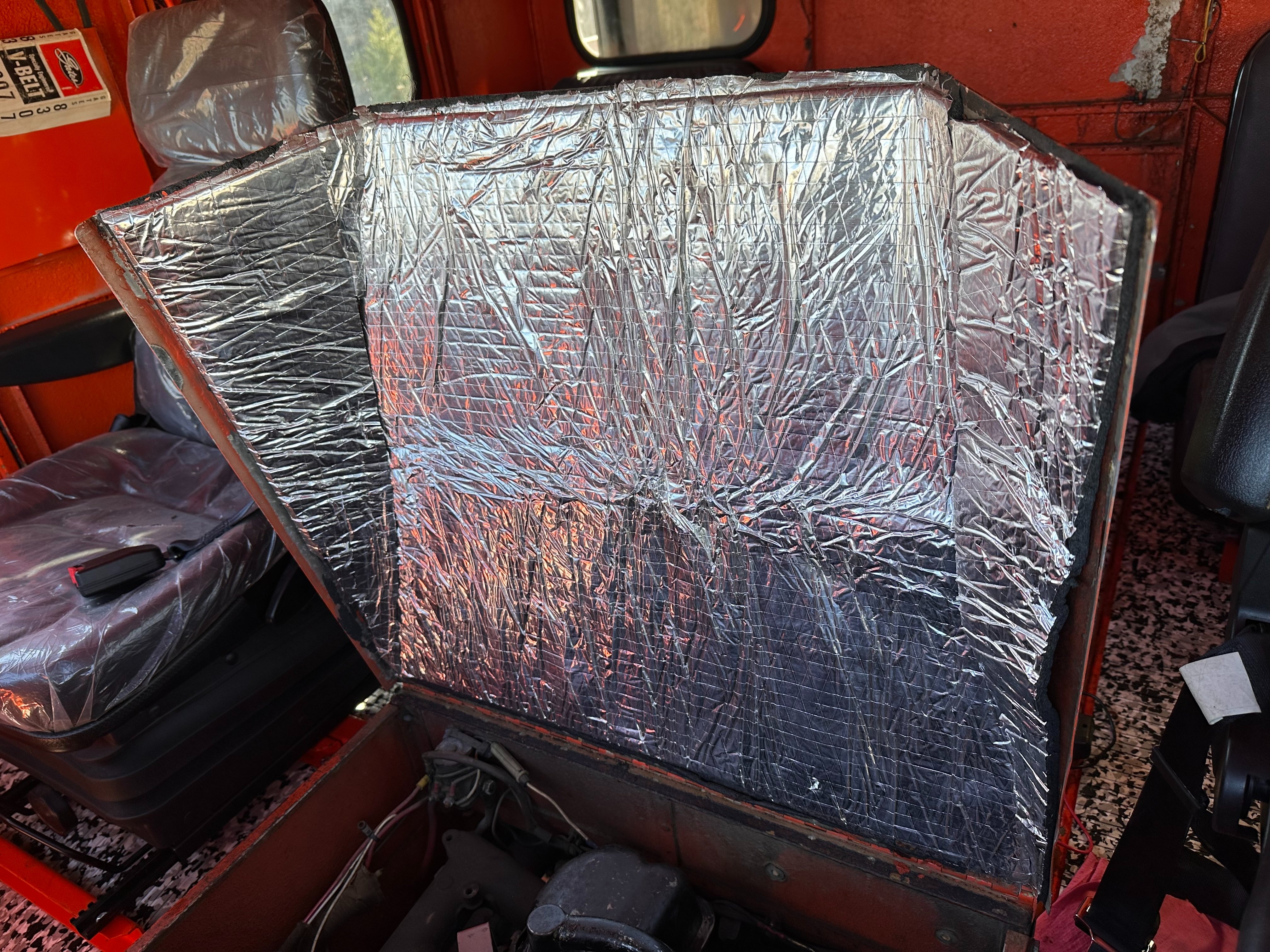

To help with the noise and engine heat, I covered the engine cover with some reflective foam heat shield. I am very impressed with how much this did help quiet down the engine noise as well as reduce a lot of heat coming off the engine. I haven't used the machine much yet, but the times I've had it up, I care barely keep the doors shut while driving it due to the heat radiating off the engine cover. I'm sure in a super cold environment the heaters would be needed but maybe this will help cool off the cabin until the heaters are needed.

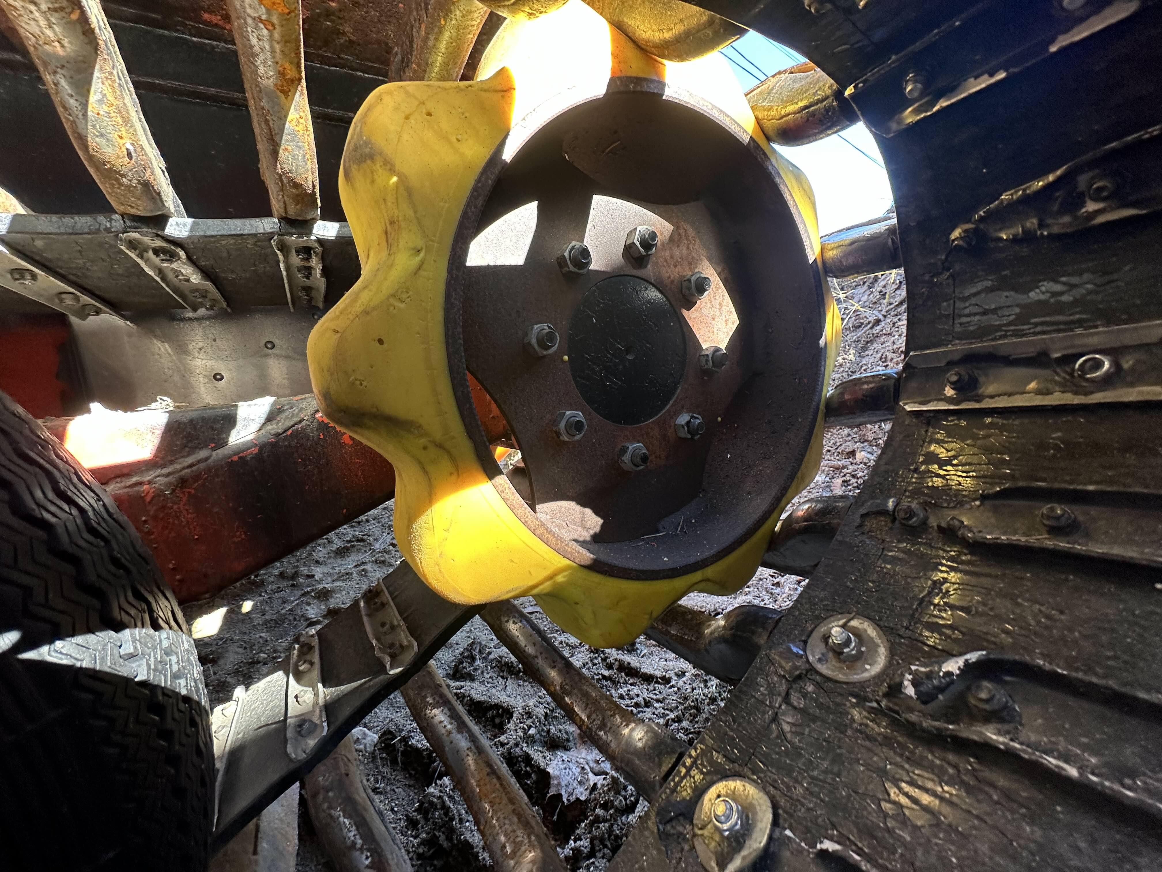

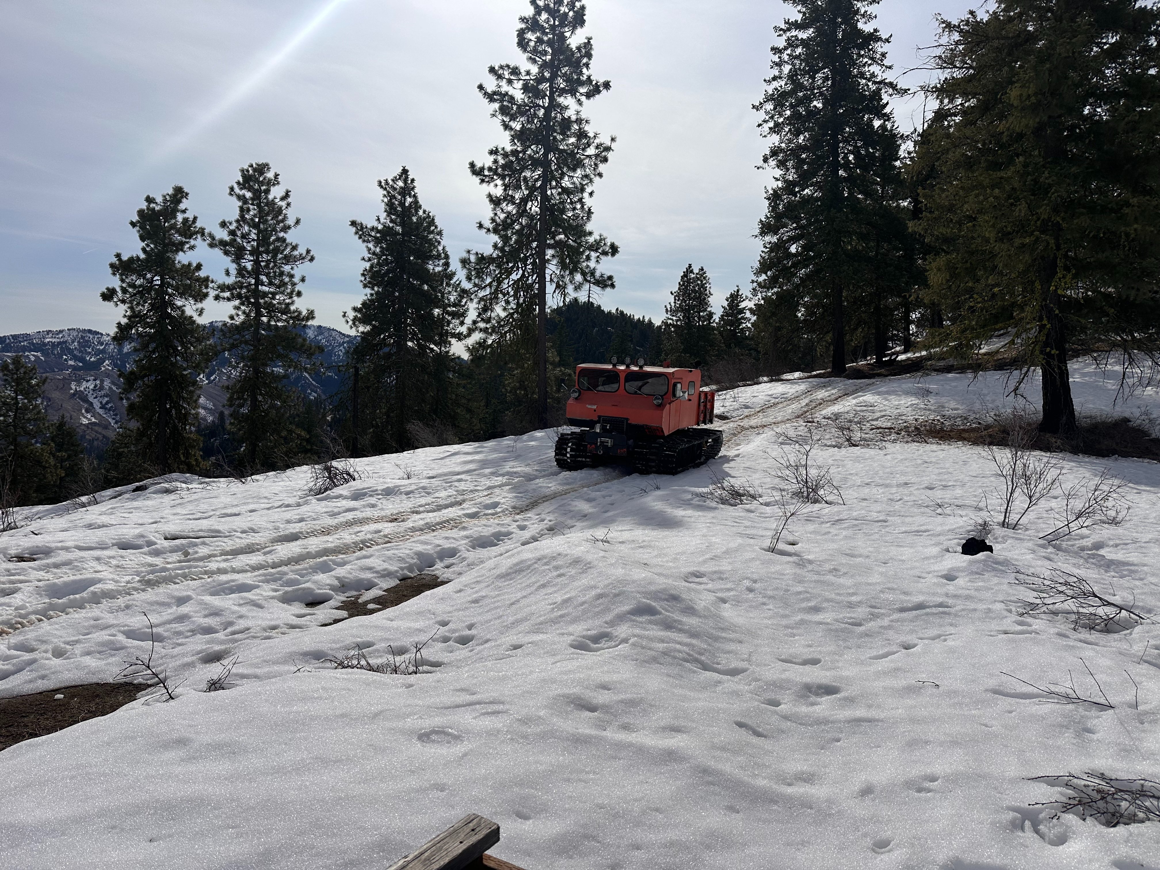

The last pictures are from my front test trip out. The tracks needed a little bit of adjustment do to slipping but overall good test rip. Brakes worked a lot better. I've learned the faster you go the better the brakes work. It still is no skid steer maneuverability but a little more enjoyable than last year when I took it up.

Nice progress. Getting hot in the cab is an issue with two 3700s I operate. Then condensation on the windshield is another problem when it is cold. I was looking into small heaters with fans that I can direct towards the windshield. Used one last year, but am going to try two this year. I will be tackling the lights this year as well.
Welcome back glad you are here. I was hoping you would stay convinced our rear diff was an oc 4. (Giggle giggle) now that you figured out what you have get that v8 jammed in there. Your electric fan idea will burn up the 240 pretty quickly so just get to the v8!.
If you do go electric, bring your mechanical, fan and bolts and 2 gallons of liquid with you. Electric Fans just move the load to the alternator and do a poor job unless properly shrouded. (You know this) most folks dont realize that when the fan motors get warm electrically their resustance goes waY up. Fan hp goes down 4x and air moved is not at the advertised rate.
