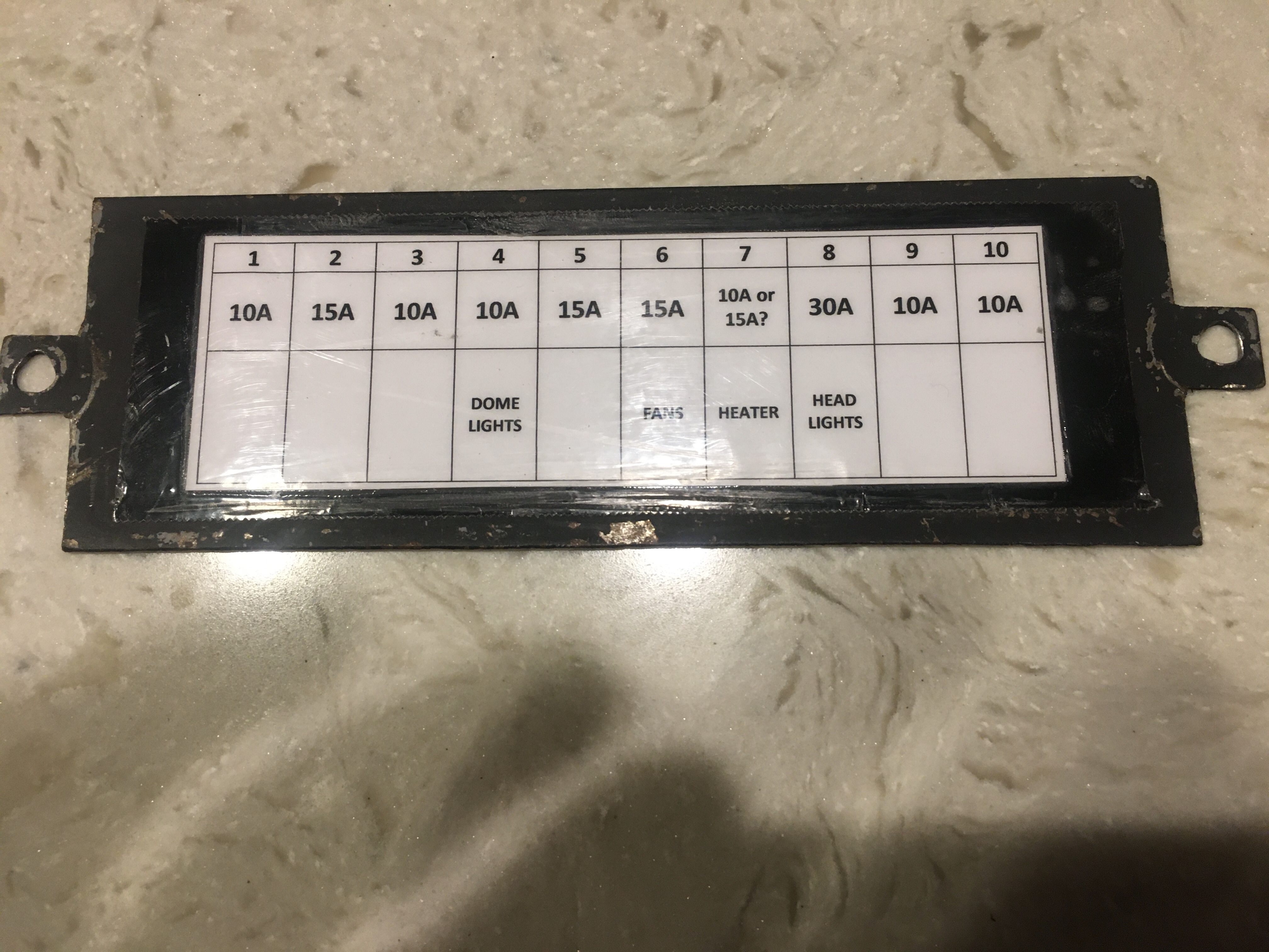

Couple of things to look at when you find the fuse block. Is the fuse just melted, or did it "blow" and the arc coated the inside of the fuse with the metal? THe second case indicated a true short. the first is an oveload. Next look at what ever is holding the fuse. see if the treminals are discolored. If yes, that indicates they are getting hot, and not making good contact. that by itself can cause a fuse failure without an actual overload. if you can get access to the fuse connections easily the old mechanics trick of using test leads to wire in a self resetting circuit breaker may help you trace the fault. It will allow some current for testing, but protect the wiring harness.
Your fuse box is located on the top right of your instrument panel. There are two thumb screws to remove. Inside is a row of bus fuses. Most are 10 amp but there are a few 15 amp fuses and the headlights are 30. Super easy to access. The headlight fuse is in position 8.
My 1200 started blowing fuses. The glass fuse holders were loose which created heat which blew the fuses. Post a pic of your fuse block.

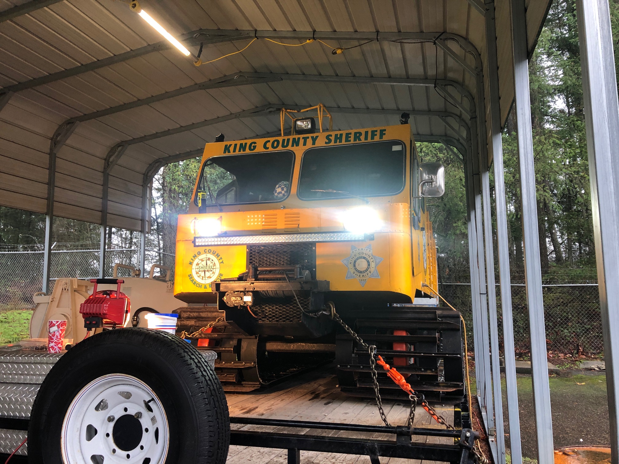

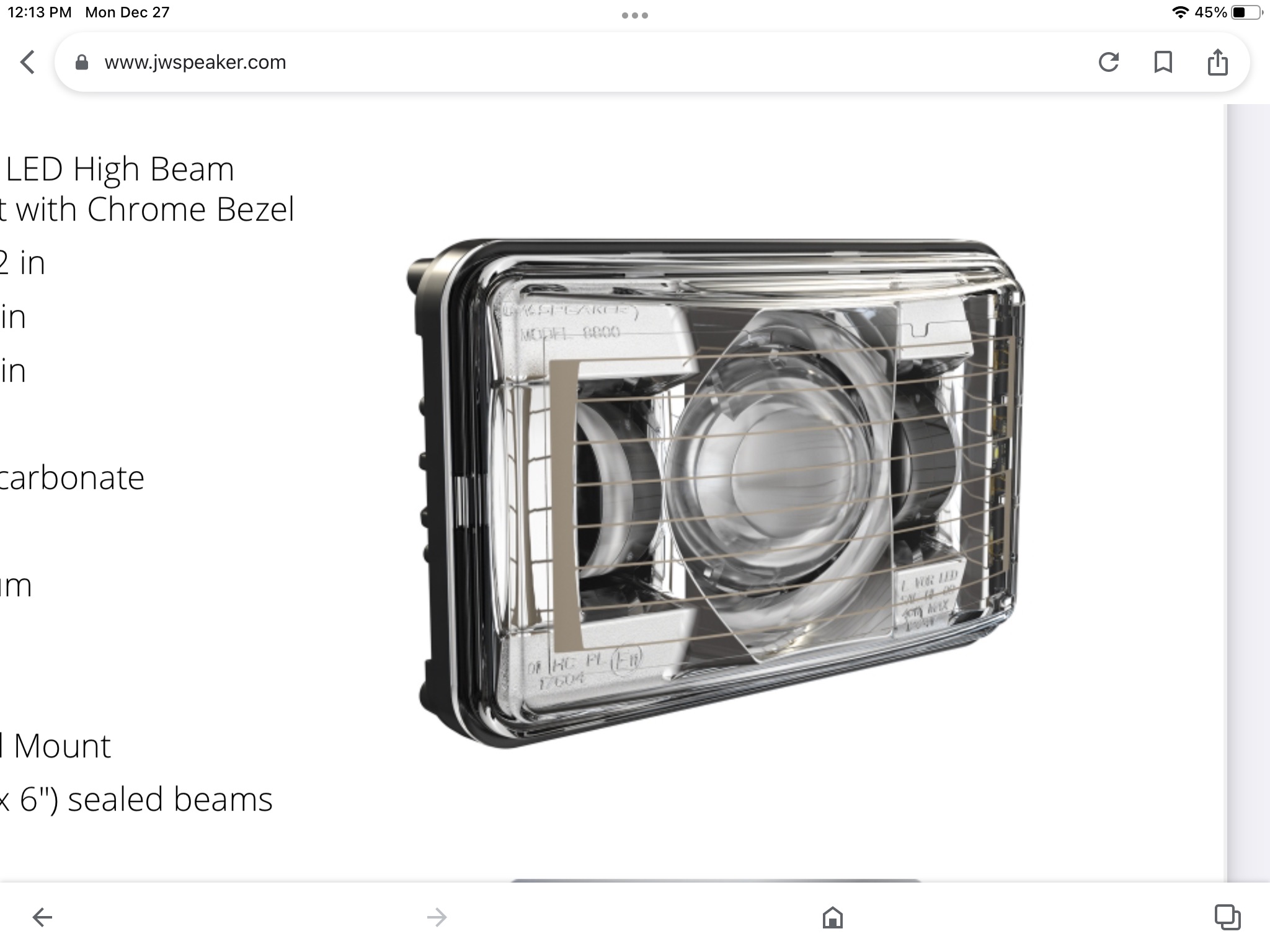

First on the list for 2022...an easy upgrade to 4 LED headlights for our 1985 LMC1500

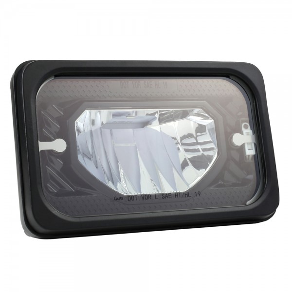

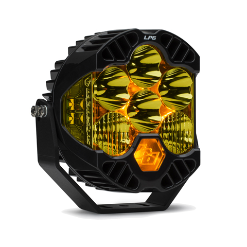

I think what you want is something with an amber lens for snow?
Those look good. I would definitely cary the original lights with you just in case you run in bad weather and the LED’s don’t work out. Switching them out is relatively easy.
