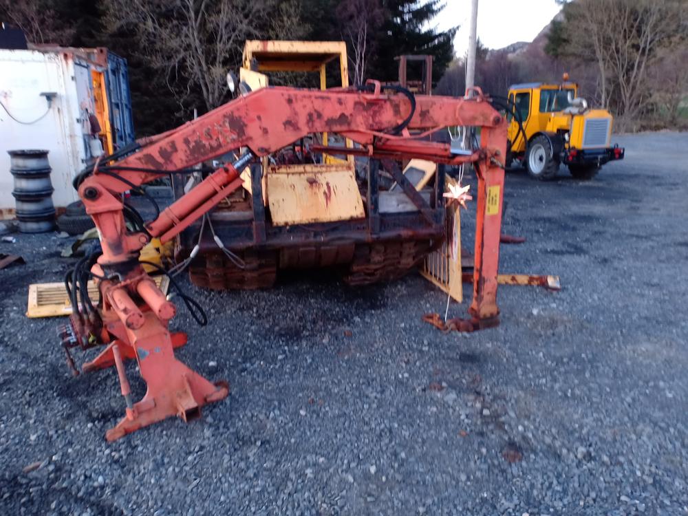

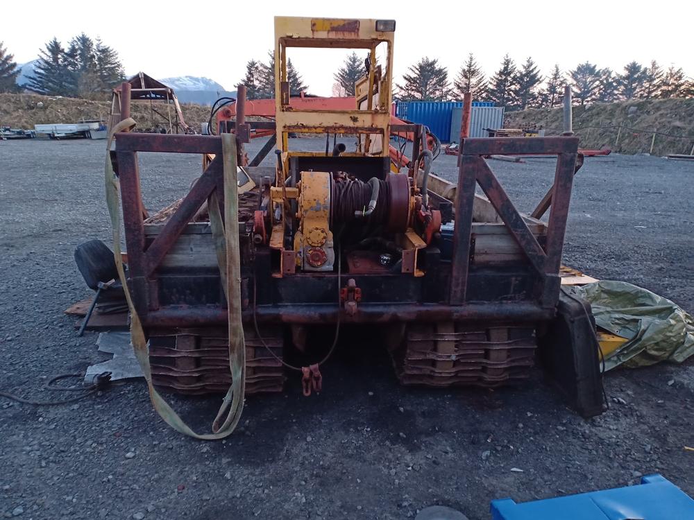

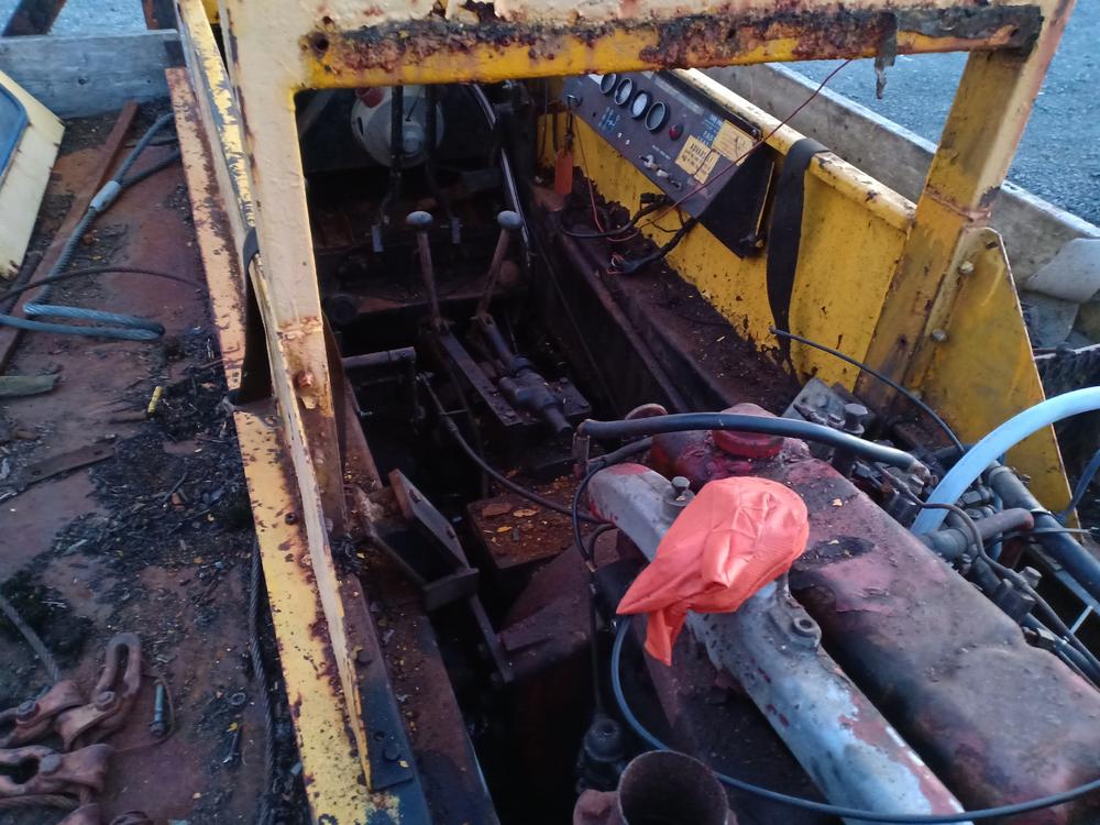

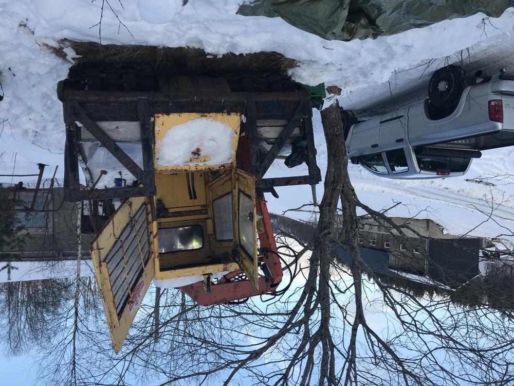

Hi yall! I am a Norwegian that are currently starting to fix 1 of 3 Muskeg carriers that i am in possesion of :) ( you might think, what would Canadian Muskeg`s do that far overseas? well, in the 60s-90s they were very populear machines for the power industry, related to the construction of powerlines,and construction in rural areas)
I will post some pics of whats going on here,
Info about the machine : 1971 Bombardier Muskeg carrier, it has a crane and Swedish sepson 3/6 Ton winch. Engine : Perkins A4.236
issues : Tracks are very worn and in need of replacement, engine does not crank, starter broken, dynamo broken, 1 fuel injetor broken inside the engine head, in general porr condition ( currently in negotiations of aquiring a perkins T4.263 engine )
More info : the poor Muskeg had been stuck in the same place for atleast 10 yers + when i bought it, so everything needs a checkup

I do have hydraulics on the machine, and I would very much like to swap out my manual steering levers, and replace them with hydraulic steering instead, info on this, anyone ? :idea:

Btw: The machine, yea i know it`s in dire straits and could really need "a hand". however as far as cosmetics go, i have a sandblasting& painting company so that bit will be covered with ease, but with reegards to the technical state of the machine, now thats another story:yum:

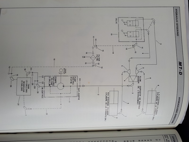

Hi, Thanks for your reply, I have also heard some other Muskeg owners tell me the same thing regarding the hyd steering. However I am quite interested in acquiring such a type hyd steering, I am also trying to plan on how to build that system, However I am a little stuck on the Cylinder part, because i would probably need a cylinder that would retract fast into normal position after use, any thoughts on that? Or maby there exits som good drawings from the original hyd system?
If you do a search on this site, Muskeg Hull Rebuild and Muskeg Steering , threads will come up, with lots of info. I'll post a pic of the manual hyd flow chart , basically your lever is blocking the return, causing the cylinder to apply fast. Generic cylinders like I used require a fairly strong return spring, something I had to change after testing, other than that, I had no problems. Dialing in the pressure to suit the weight of the vehicle was the last step.
