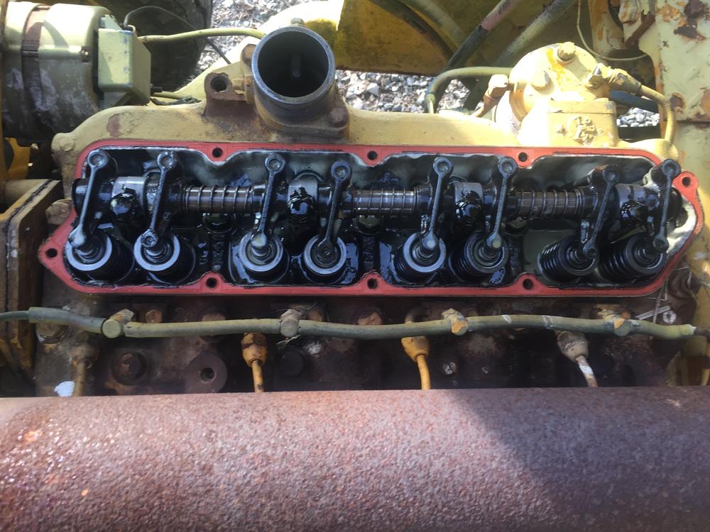

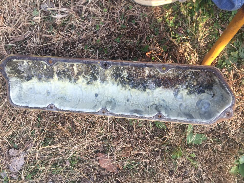

Well, I got the head off and I know nothing more than I did yesterday. The inside top of the valve cover had a lot of creamy milk looking stuff. I'm guessing oil and coolant mixture. It was getting dark on me but I snapped a couple of pictures that I'll post in a bit if I can remember how.

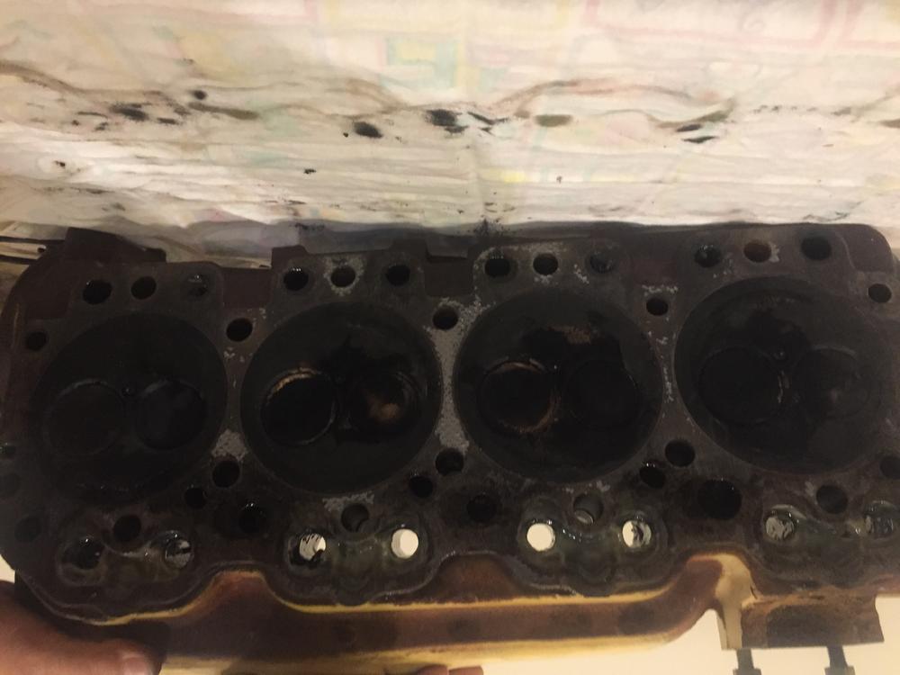

I looked over the head and top of the block and all looks ok besides the milky cream. The tops of the pistons looked good. On the bottom of the head where the pushrods go through there was a lot of the creamy milky stuff. More research is on the way for me.
I'm still open for any and all suggestions/comments.
Pictures. Please make any needed corrections to them such as size

Take a good close look at both sides of you gasket. look for cracks near the coolant holes. Check your head and top of cylinder block for cracks or worn places. Might be just a cracked gasket. I have found spraying both side of the new gasket with high heat paint and installing before it drys will seal a lot of little worn spots.
Do you the reinstall specs for your motor? You have to tighten the head bolts in a certain order. Best of luck!

all that "icky" stuff is emulsified oil....... it has undergone a chemical transformation.
it will never separate back to oil and coolant.
while the engine is running, the oil pressure is higher than the coolant pressure, so the oil will get into the coolant side.
in your case, the coolant leaked into the oil side, sooooo, that means it happened while the engine was not running. which rules out a lot of problem areas.

I would clean the sludge with Diesel or solvent unless it was something I could pressure was like the valve cover. Once reassembled I would run the engine to operating temps and change the oil and filter. Oil samples are always a plus too to follow trends but I would imagine you would get high silicon levels from the antifreeze for a while.
I didn't see any thing real obvious so get the head checked for cracks before you re assemble the engine I would rule out oil coolers as the oil pressure is higher than cooling system pressure if the oil cooler fails the milk will be in your radiator
Going to get the head checked tomorrow. When I drained radiator and block, coolant was green with no signs of any oil. Also after thinking about it, the head bolts seemed really tight, compared to what the torque specs are. I had to crank on them pretty good with a 1/2" breaker bar to get them loose. I'm wondering if the head bolts were over torqued which could lead to gasket failure.
