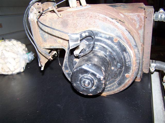

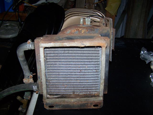

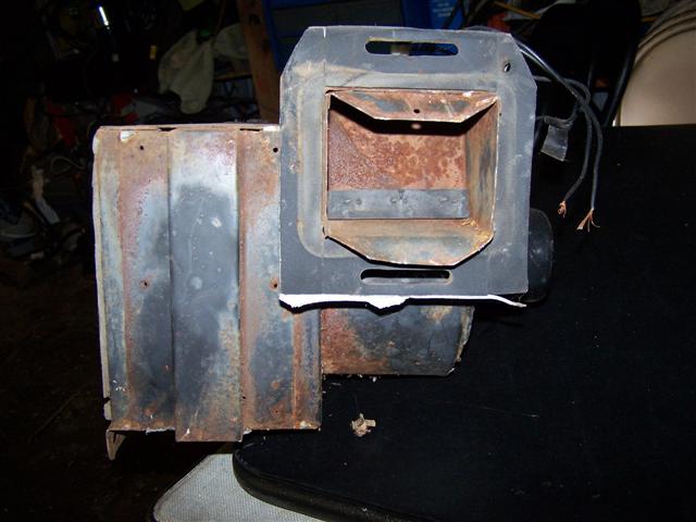

Here is what is going in My merbi. I am going to mount it behind me in the engine compartment although I think it will fit behind the head lights easy enough.
I use these in many builds around here. I have put them in early broncos, Toyota land cruisers, Boats... IH scouts are hiding behind every barn here in the upper midwest. Junk yards are full of them and the heater blower and heater core seem to be one of the only non drive train related items that survive the elements of time on a binder here in the salt belt.
The resistor pack on the top easily allow multiple speeds. the blower motor is easy to service. Flow valves allow easy metering for temperature control. 4" square output is easy to convert to round if that is your thing.
Mike
