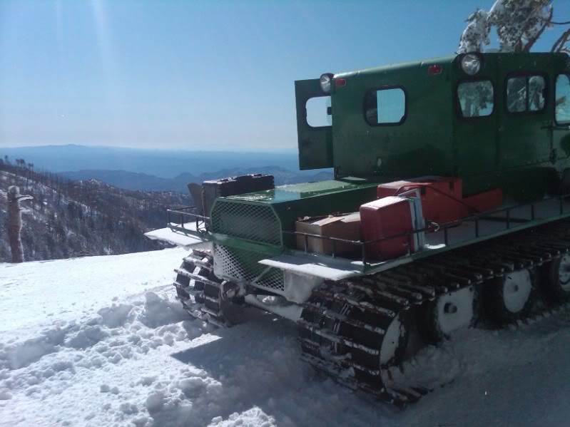

That is a model 201 Thiokol they do fine in the snow unless severely steep with front drive they have the tendency to lift the front which is good for running in a swamp not as good running over a hump on a steep slope. I've includes a picture of one in snow.
I think the price it high for a machine that needs a clutch installed but the important part is the differential and the track condition those are the two that can cost the most to repair

Hello Tater-
The pic Boggie posted is actually my 201. Its a real simple machine to work on with tons of access to the driveline. Because of the larger straight-6 170ci ford used in this cat there is no need for an auxiliary transmission like some others have. Replacing a clutch would be very easy as its only dropping a driveshaft and then a bellhousing/scattershield instead of a heavy transmission. Also since the drivers position is directly over the transaxle the shifter and steering levers come straight up through the floor with no linkages or hydraulics. Thats 2 less master cylinders and slave cylinders (4 cylinders total) to have to worry about leaking. Torsion axles make for a smoother ride and less fuss when changing tires. Track adjustment is done via screw vs the messy grease pressure method of others. Motor parts are super easy to find as they are the same as any similar year ford 170ci- mine is a 1963 so when looking for parts I buy them for a 1963 Ford Falcon. I have never had any performance issues with the reversed style of this cat as the weight of the passengers is still over the front of the machine- and in my case that weight is SUBSTANTIAL.
The only issues I have with my little 201 is that the cab is just little. I am 6'5 and I have to crouch over when sitting in the cab. I have thought about cutting the seat riser down but haven't gotten around to it and honestly it doesn't bother me enough to actually do anything about it. Also the cab is interesting to get in and out of as you have to climb up onto the deck to do it. Lastly is storage or ease of tool/equipment carrying. The narrow deck around the cat is OK but if you need to carry something big it gets awkward.
I have thought of replacing the motor hatch with a full-width flatbed but again the time/energy to modify it is not justified by the small hassle.
