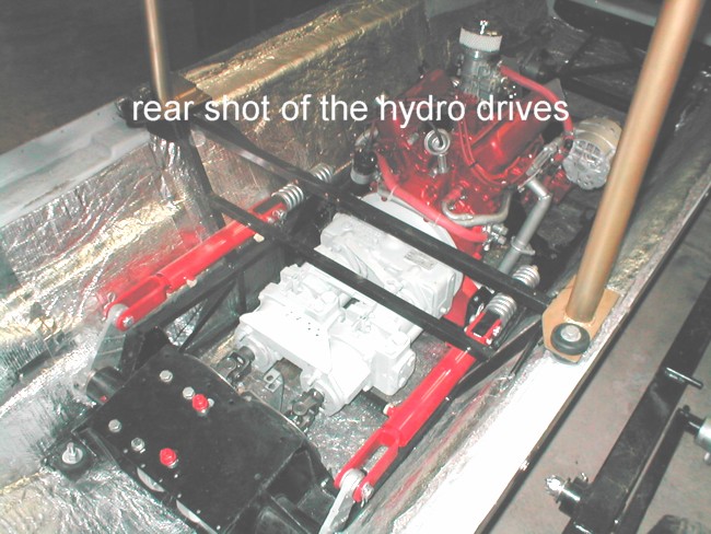

Ok I understand that . These two transmissions mount by a short ujoint directly to the right angle gear drives that hook to the track spocket . There is no other pumps or motors !!!!????????? Should not these me call automatic transmissions ??????
Ill post a couple pictures of these two Hydraulic transmissions . This is it . there is not anything else to this drve system .

Here's my guesses then....
Purple box is the two hydrostatic pumps, as evidenced by the levers to control the swash plates. Yellow is the hydraulic motors driving your tracks. It looks like they merged the pumps and the motors into a single assembly, with the plumbing all internal. What does the assembly in the green box do? Looks like some sort of link between the two drives.
This is not an automatic transmission becuse you still have all the benefits of a hydro, such as revering flow, and no meshing gears. An automatic trans only has the torque converter as a means of de-coupling the mechanical drive at low RPM, and not stalling the engine.

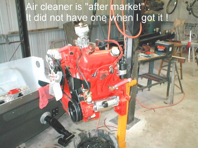

Picture of Hydraulic body tilt pump..

Sorry ,I misread the post . Hydraulic pressure for the Body tilt control is supplied by a small pump on the motor . see prior picture
Ahhh...OK then. The "T" you are concerned with seems like it is on the tank side of the system, and is just a plumbing decision made by whoever designed the system. I would guess you could keep the "T", or plumb all three pumps directly back to the tank, and it would make no real difference.

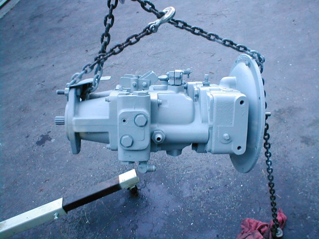

Can anyone tell me which oil port in this picture of my hydro drive is the supply and which is the return to the tank .I do not trust the way it was plumbed before . Does it matter ??? Thanks Allen

Al, Are there any markings on the transmissions that might indicate the manufacturer?
edit: Nevermind, I can read it in the picture "Funk Manufacturing"
OK...after much searching and deciphering, plus a little scotch and water and throwing a chicken bone over my shoulder, I am reasonably certain that port at the bottom of the housing (the elbow fitting) is the tank return, and the one on the side is the supply line. The check valves for the system are located behind the plugs that look like hex head bolts. Hopefully, there is also a 5, 10 or 25 micron filter somewhere in the system.
