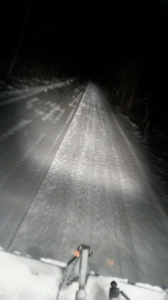

The snow on some of our trails is still full of air and I know that's part of our problem with the side trails, was out on Friday grooming our rail bed which is so hard it's like concrete. Actually sucks to ride on it in the machine, makes for a very rough ride. Here is a pic of the end result of my efforts with this snow

Doesn't look like there's anything wrong with that.
just not 'picture perfect' that only lasts for the first two sleds anyway. As long as it freezes up flat, you're good.
Are you still bumpy? Blades not able to cut to the bottom of the bumps maybe?
