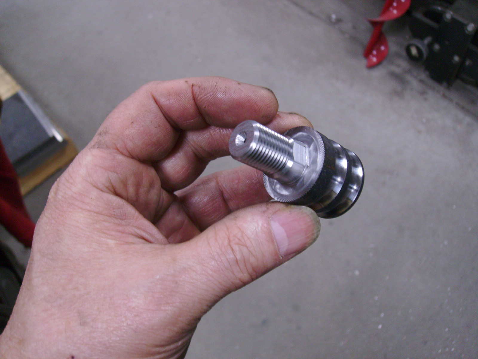

HEY,..... look what I found at work!!!
..... Shall I make a few of these?
(1/2-20 thread......... do these fit your Kitten?)

My first "experimental" batch of roller axles went out to heat-treat today!!!
When I get them back (in a few days) I should know exactly how they fit... and will begin making lots more.
I can't wait....... I really need these. (I'm going to have to start making flanges again, soon..... as well).
They're back!!!
They didn't move like I expected them to, so I need to buy balls that fit..... but I have a source on eBay, need 9.75mm instead of 3/8-inch.
Now I can modify my program and start whippin' em out!!!
Currently, the 3/4 roller is really sloppy and I have five 1.0 rollers that are the same..... but I have TWO 1.0 rollers that fit great with 3/8 balls. I'm going to install them immediately.

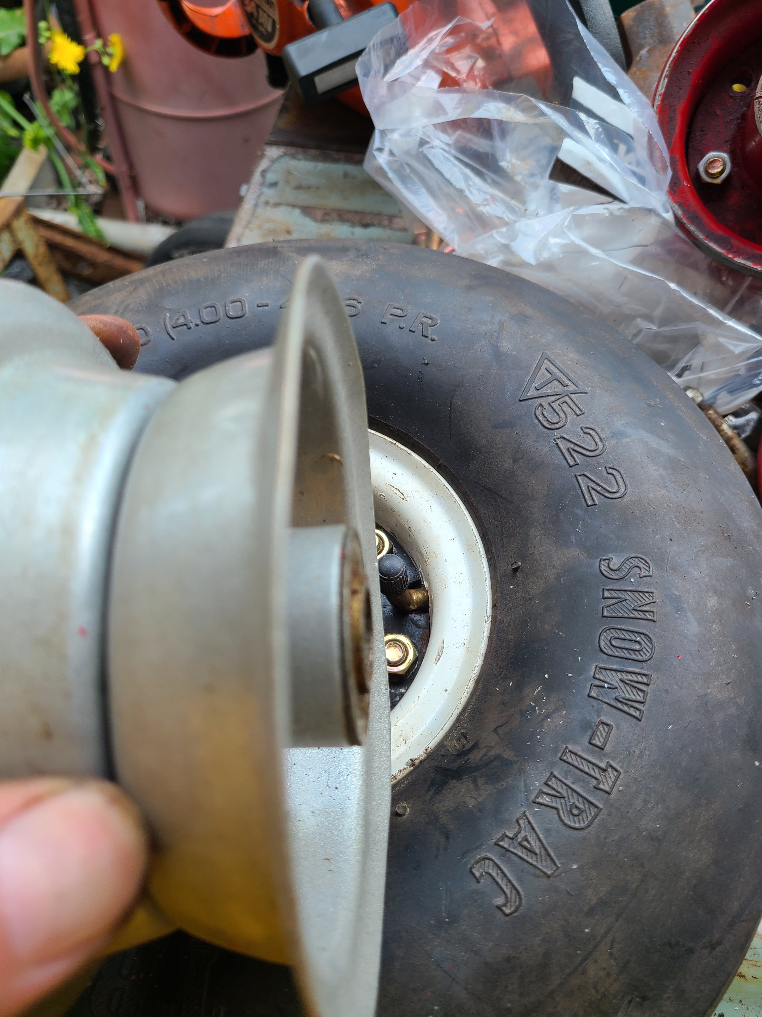

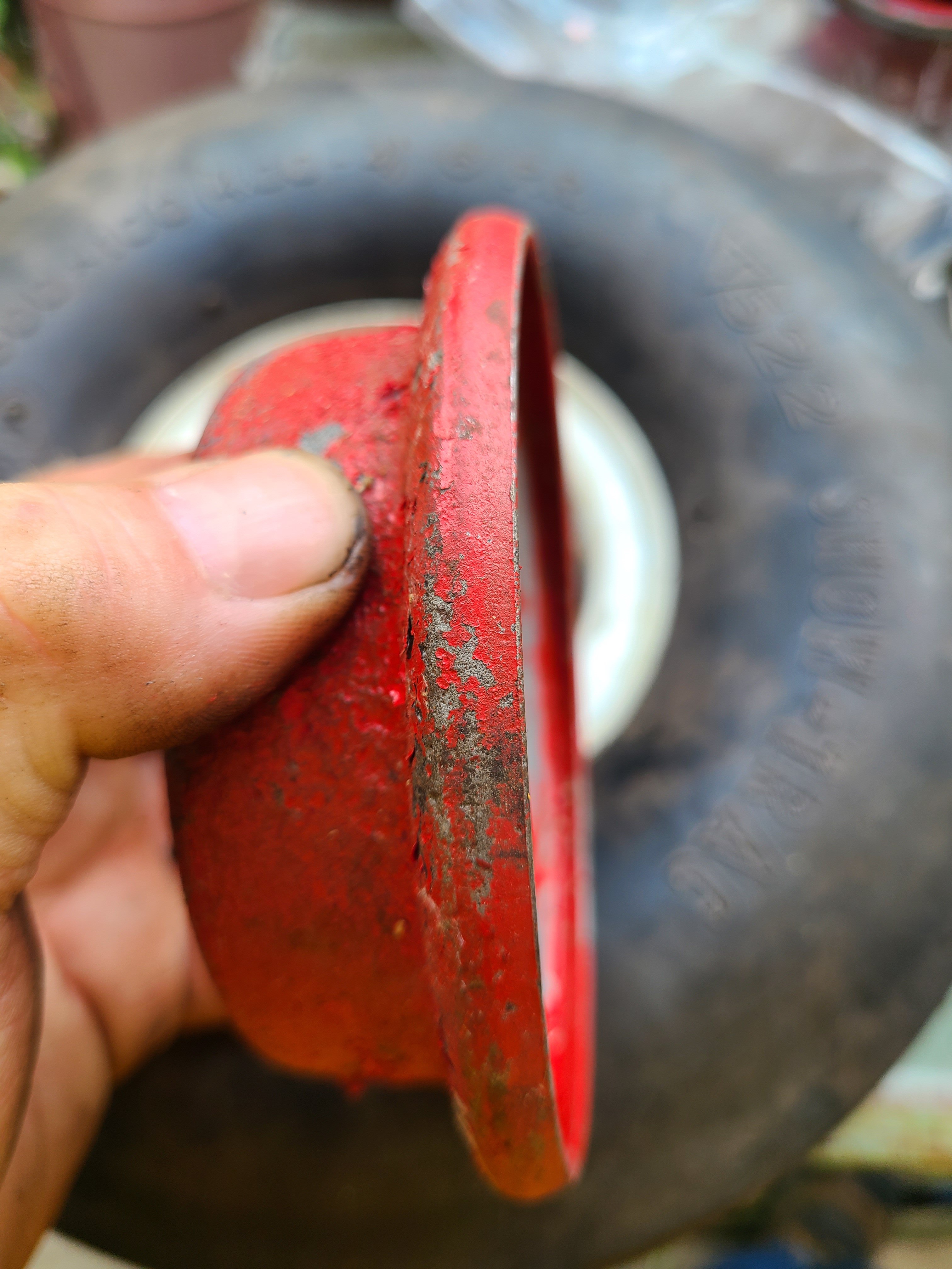

Well i got the indexing head figured out. Got the wheel halves assembled. #60 of air installed and i think the shells or wheel halves will work in 3-6 places in a st4. I will be rolling some rings and welding them on to beef up the beads. My personal position is the wheel guides will work pretty hard on the tires with out the rolled beads that aktiv used. Those tires are too precious to let that wear occur.
ill be watet jetting the rings to help beef up the wheel centers. For now these light weight assemblies will just go in the upper trac return position
the bottom photo is the sqwrl or tree rat created assembly. (Using an oem hub) im milling and drilling on some tree-rat spindles to see if i can create a standard duty hub solution.
