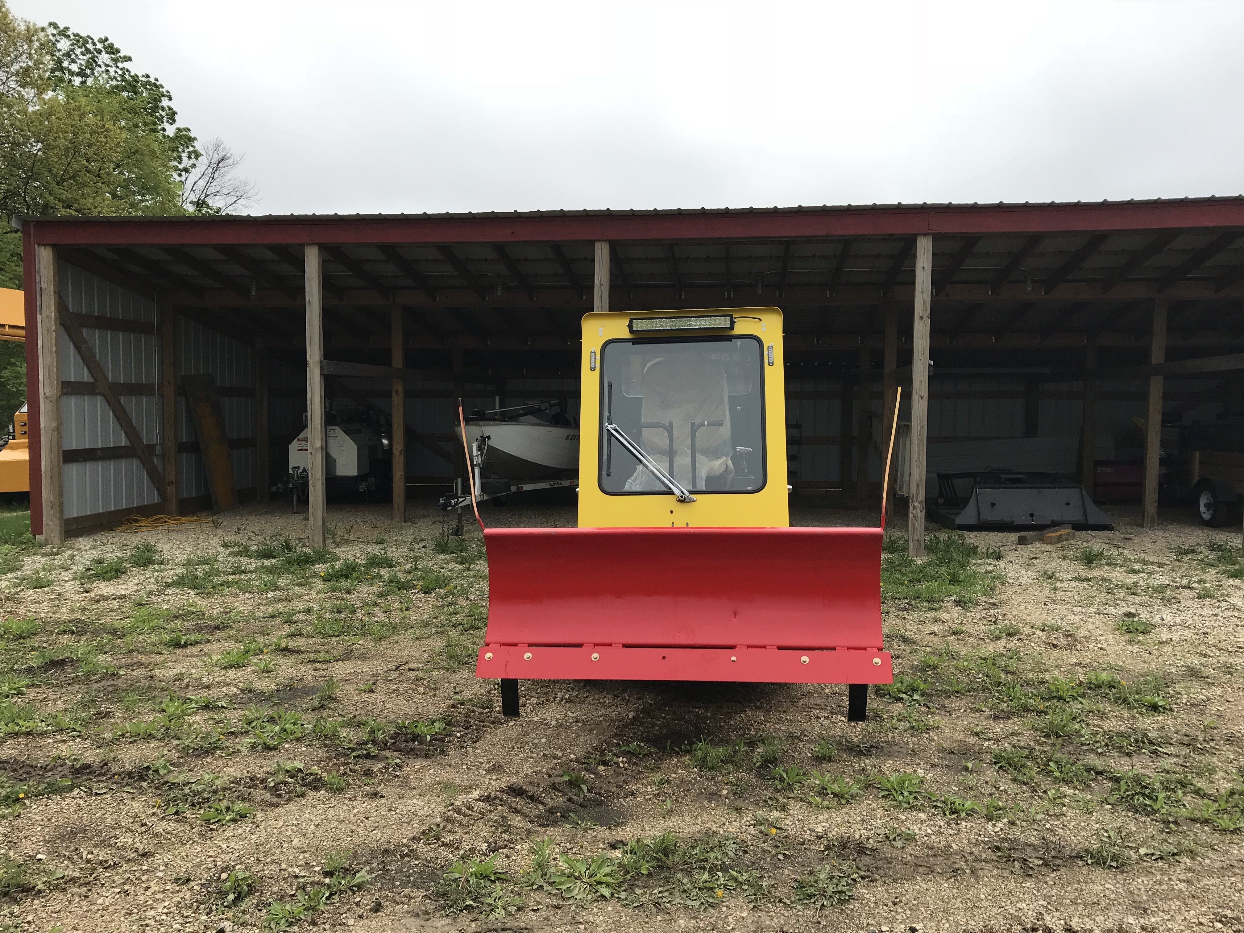

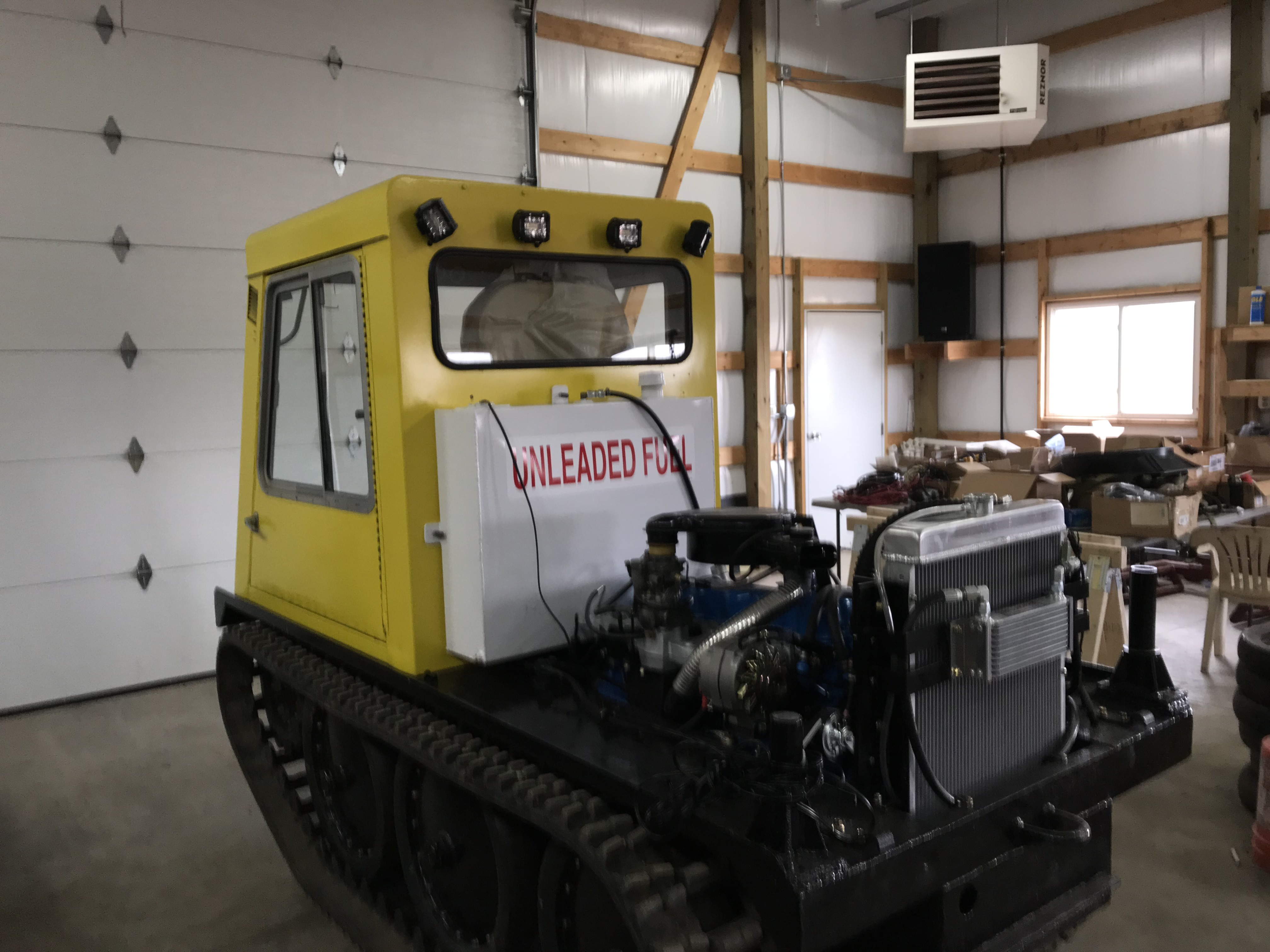

I’d be nervous getting sideways at a grade of 19% (almost a foot of drop per five feet). I’ve attached a couple picks showing width (blade is 4 feet wide) and how much track sticks out from frame. My tracks are rubber….if you had steel tracks….maybe. Roads get icy and a 19% grade would be a tough one with a lot of machines (if plowing). I don’t have enough experience on larger grades (biggest one I have is a 10% grade)….hopefully someone can shed more light on a 19% grade…..
Man that thing is super cool. Ok - I understand. I probably should have been clear that there is only one hill that is 19% grade. One other is 13%, and everything else is in that 12% or less range. That 19% hill does not get plowed today. We just all wait for the snow to melt. So I guess worst case scenario is that it just stays unplowed all winter. I do still have my eye on a BR180, but it is in Edmonton, so super expensive to ship to me.
