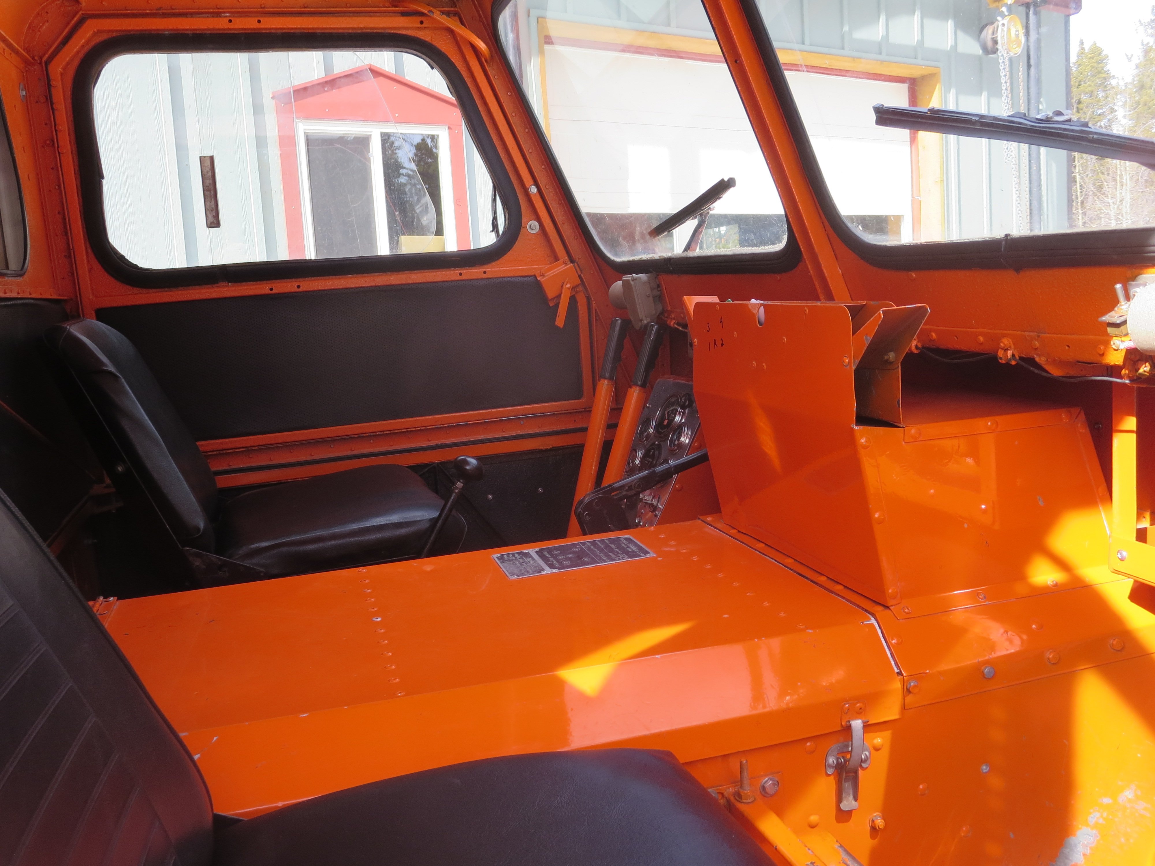

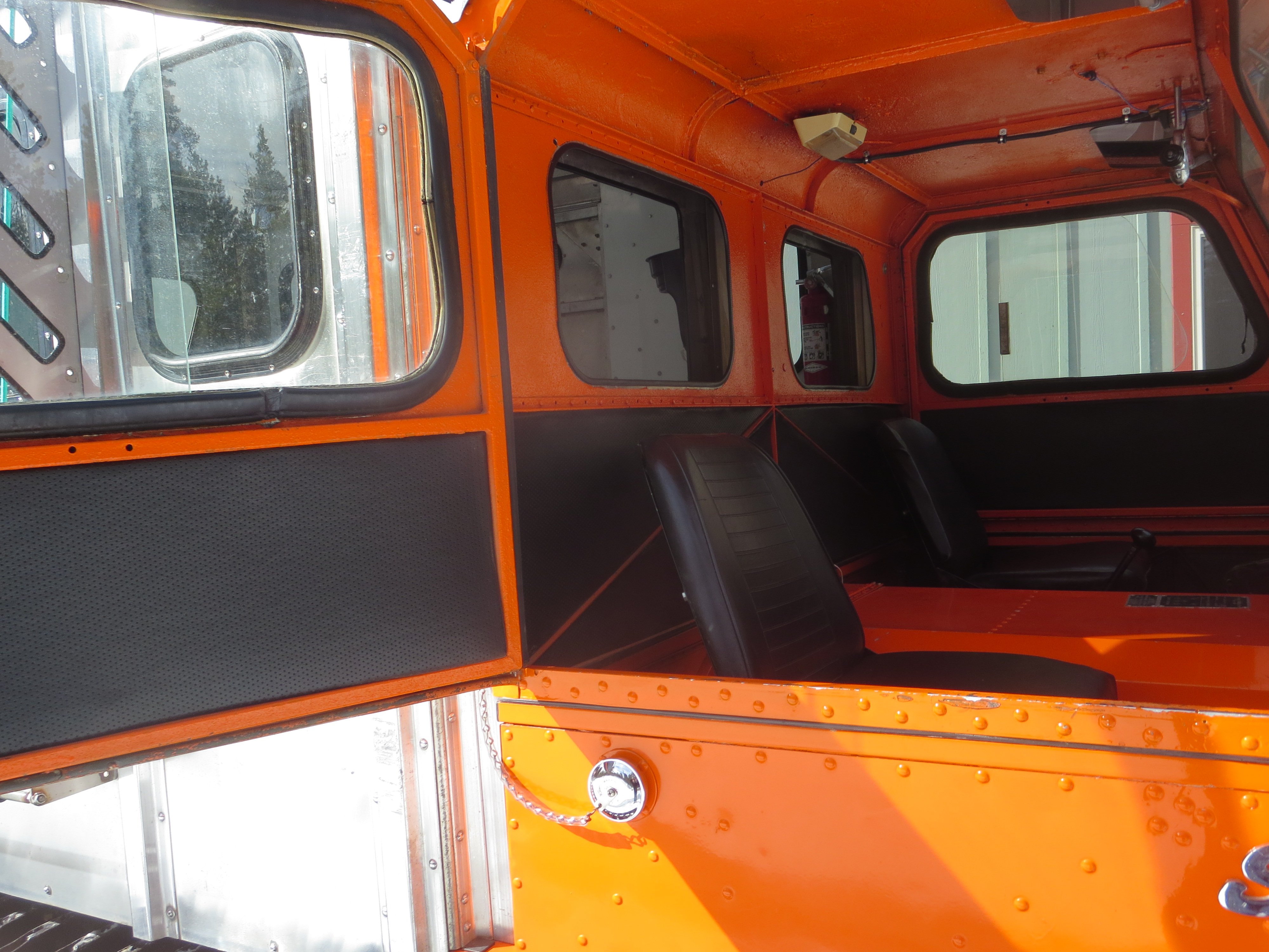

Have you considered a 10" bed extension, or maybe a stake pocket extension for the times you need more cargo room? The under seat tank is mounted under and fastens to the seat bracket (which bolts from the engine cowl to the body tub) and will have an effect on your seat height. In this picture you can make out a 1" square tubing cab riser and a pretty thin seat I put in because of height issues. A-Models and early B's used fiberglass seats over the gas tank that have no cushion.

Thanks for the info and photos. I had to redo the bed last summer as it was bent a bit from prior owner. At the time, I extended the bed so it terminates right about at the end of the tracks. My cowl does not extend to the rear of the front seats as yours does. Looks like I may have to stay with the bed mounted tank or figure something out for a undermount under the rear seat. I notice the fuel filler is below the door, Mine has full size doors so that is also a no go at this point. Once I get the full tank figured out, I hope to work on the doors. I want to do two piece full size doors, think Jeep style. Also would like to be able to remove the doors, either the top portion of the whole door for those nice spring Skiing days
