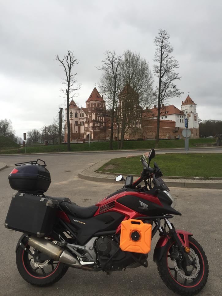

Option #1 - Rotopax, FuelPax and similar - these are flat hard fuel containers. Sizes vary but they are roughly 3" thick, roughly 14" square. Photo below shows orange tanks mounted on a red Honda. Downside is the shape. Clearly would spill fuel in a skid, and mounting next to a hot engine? I've seen them mounted to the outside of the luggage cases, making the motorcycle even wider at the rear. Also seen them mounted to the rear top case and even mounted on top of the passenger seat. None seem like good mounting choices. Roughly $105 to carry 1 gallon of fuel, with a $40 mount and a $65 canister. 2 gallons, 1 for each bike, $210.

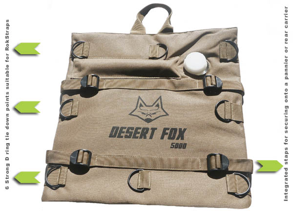

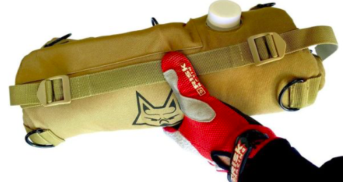

Option #2 - DESERT FOX 6 Liter Fuel Bladder => https://desertfox.bike/desert-fox-5l-fuel-cell/ These are flexible fuel cells. Roughly a square pillow, encapsulated in a Cordura fabric case with lots of lash points. Can be rolled up and stored away when not in use. Can be strapped to the rear seat on the handful of days it is needed. Seems like a reasonably good choice. I found a source in Australia that will ship 2 of the 6 liter (1.5 gallon) bladders for about $185. So 3 gallons for $185.

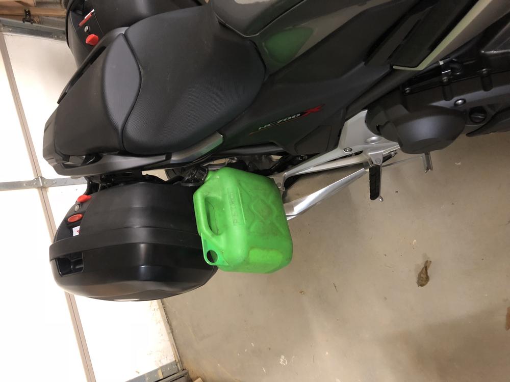

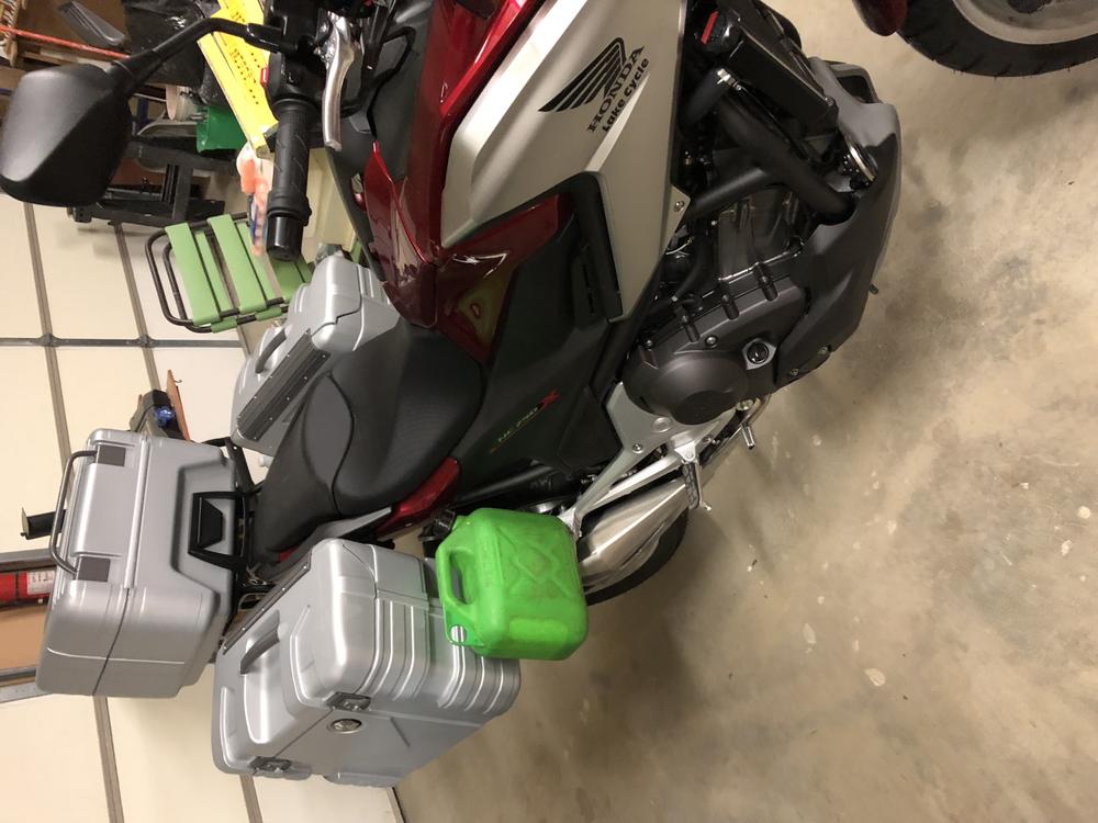

Option #4 - Chinese knock off Rotopax rectangular cans => https://www.amazon.com/YOUNGFLY-Por..._rd_t=40701&psc=1&refRID=Z0GQR1Z89TN7B6E851N6 These are sort of like the flat Rotopax containers but they are thinker and more box shaped. Somewhat easier to mount on the front of a motorcycles side case, at least some of them. I played around with a green 5 liter gas can in my garage. Not exactly the same, but similar size. You can see it in the photos below. I could mount 1 to the front of my rectangular cargo boxes but there is no good way to mount it to my wife's more aerodynamic cargo boxes. These are cheap, 1.3 gallons for under $40 but they are still bulky.

The flexible pillow shaped "fuel bladders" seem to me to be the best options. Easy to stow away when not needed. Strapped on the rear seat with the camping gear when it is needed would center the weight on the motorcycle.
For our planned trip we probably will only need to carry extra fuel for about 30% to 40% of the trip, basically the rural areas on the Canadian side of the border. The population centers are closer together on the American side of the Great Lakes so it is unlikely we'd need any sort of extra fuel, despite the limited travel range of our motorcycles. I like the idea of being able to fold up the empty fuel containers and stow them away when we don't need them, which is most of the time. Having a bulky fuel canister strapped somewhere on the bikes 100% of the trip seems pretty awkward and inconvenient, especially since there is no ideal place to actually mount a fuel can.
All that said, I ordered 2 of the Desert Fox 6 liter fuel bags from Australia. That gives us roughly 1.5 gallons of gasoline for each motorcycle. Total cost is $185 for the 2 fuel bags, delivered. Like I said, crazy expensive. But it is also one of the least expensive options despite being one of the best options.

Well the fuel bladders (I bought 2) arrived today from Australia. Actually arrived a few days ago but I couldn't get to the post office to pick them up until today. Far quicker shipping than I expected :smile:
Initial impressions are very positive.
The fuel nozzle does not screw on, it is a pressure fit. That might be the only real negative. The bladder itself is a fairly thick plastic and it has a nice canvas cover with lots of tie down points and a couple long straps that are sewn into the back of the cover. Looks like it will do the trick. Maximum capacity is 6 liters, or just a bit over 1.5 gallons.
