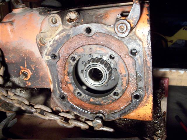

griz
Here is a pic of the fill to plug
AKdadio
Thank you for posting photos griz! I think I will give peterson a call and ask on the "tractor hydraulic". It is one of their guys in the NW who told me you could use it but I will double check. The other stuff referenced above is not really an off-the-shelf item here. I will report my learnings.
