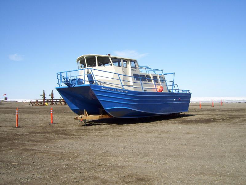

Just pulled this out of the shop this morning with a new paint job and just about everything else in it new too. It is a 40' Catamarian that is a pretty nice ride, should be a bit faster now too....
Pulled the 275 HP Mercury Inboard/Outboard and replaced with New 330 HP Volvo D6 engines and outdrives with counter rotation props on each outdrive.
Has all new electronics, fire suppression systems and a bunch of other goodies. Will be putting the radar and such back on when the boat gets back up to Prudhoe Bay (Alaska Oil Fields) in a few weeks, it is sitting on the ground next to the boat.

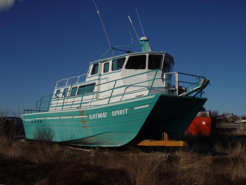

The picture where it is green, is when I went out to King Salmon to inspect it for buying last year, which is out on the West Coast of Alaska. It was being used for taking tourist up into Katmai National Park to see the bears, the market wasn't there and the boat sat for a few years before we bought it.
Anyway, we didn't do much with it for the last year, about two months ago started pulling the engines and going though the rebuilding process... It was "Soda" blasted, they used a course baking soda that cuts the paint, but no etching on the glass, pretty neat process that I haven't seen before.
The new name of the boat is the "American Discovery".

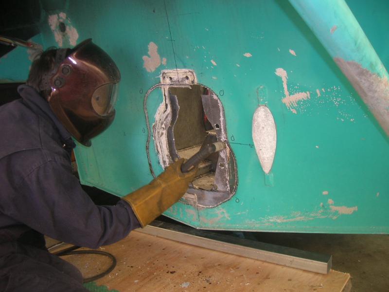

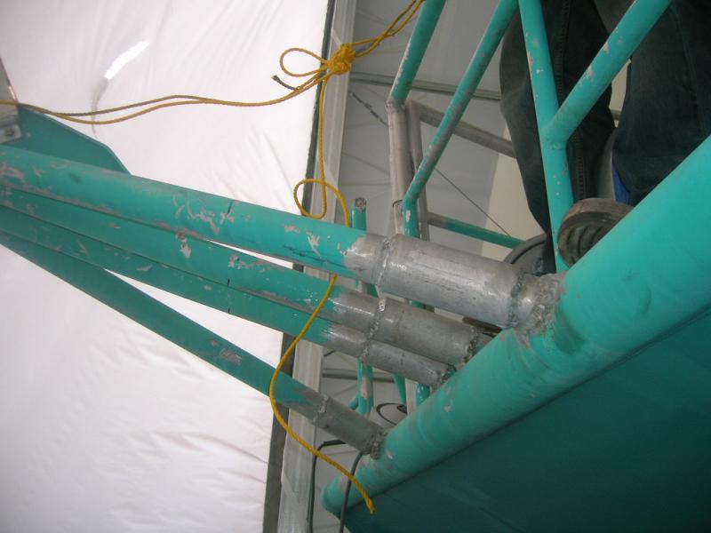

Just about all phases of the boat have been updated for use for hauling passengers as per the new regulations.
Both the new engines required belt covers, so the welders built a pretty nice setup, next year when there is more time to work with, will cut out viewing areas in the cover and put expanded metal to see the belts verses having to removed the cover for inspections.
The bow anchor boom was not constructed properly and had broken off in the past and been "Cobbed" back together, had it shortened by about 18" and reinforced so it should be able to take the swells when at anchor.

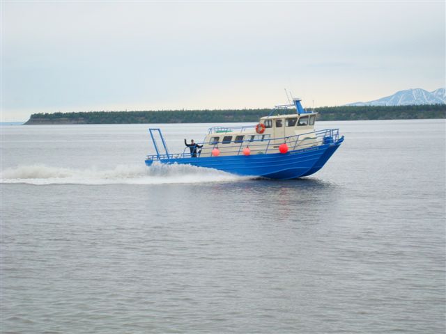

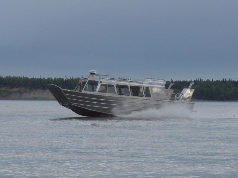

Well yesterday, splashed the boat for a sea trial test run. Was figuring that we would get into the lower 20 Knot area.
Ended up at almost 30+ going "against" the tide that is about 5 knots, so don't know how much faster it will be. Really great that it turned into a speed boat verses sea slug...
The old 275 HP Merc's only got it up to about 12 Knots max. The 330 Hp Volvo engines and outdrives really made a big difference, also the fact that the Volvo's have a lot of low end torque really makes the difference.
The second boat is one that I rebuilt last year, it is a landing craft type configuration, it does about 30 knots also and is a jet drive and can run in very shallow water. We used that one for running up on the beach and picking and dropping off workers in the offshore areas in the oilfield.
Both boats are headed North in a few weeks for the summer, so I get to play with the polar bears again...

Man that's cooking pretty good. Be careful around those Polar Bears, apparently there are only a couple of them left. :bonk:

Here is a video that one of the other guys made of the first sea trials. It isn't when the boat was run at the top end, but looks pretty good.
[ame="http://www.youtube.com/watch?v=xDYlPaGwptU"]YouTube - American Discovery[/ame]

The crew got the other boat out on the water today, it was doing about 30 knots to. Rebuilt both the main engines (Volvo's) that are now about 400HP diesels, should be alot better boat this summer to run the Polar bears over (OK, for those idiots that think I am serious about running over polar bears, get a life).
We do though, have to run patrols at night to watch for the dozens of polar bears that swim up to the drilling islands evey few weeks and catch the crews offguard. They swim out to the ice pack (That isn't suppose to be there) and then to the beach to dine on a few Caribou before going back to the seal diet out on the ice. They are doing just fine....
The fact that the Polar bears got listed on the endagered list is a ploy by the enviormentalist to stop the drilling for oil... So when you get to about ten bucks a gallon, wake up to the fact that the far left is screwing you....

Good video and pics. Looks like both of them will get up and go pretty good.
Beautiful background scenery with the mountains and all. :thumb:

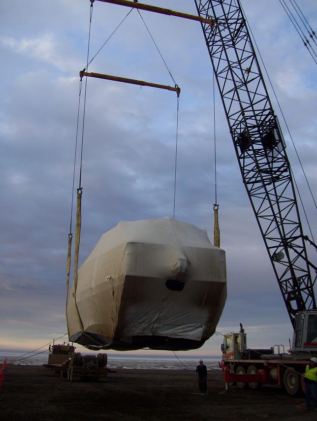

This is the boat that I delivered to the North Slope on June 21 to be unloaded for the summer work of playing around the the "Endangered Polar Bears" that are all over the place, and not really endangered, they have accually increased in numbers greatly....
By the way note the Ice in the background, that is the Arctic Ocean that isn't suppose to be there (You know that Al Gore thing), note again that it is frozen and will be for another three weeks or so and will refreeze by the end of Sept. or there abouts... The Polar Bear issue is so that the Oil Companies can't drill here, again, thank the "Tree Hugger" types for passing that high price of gas on to you and your friends....
We were working the Crane at midnight so I took a photo of the Summer Solstice, you can see the well heads next to the sun just behind the clouds.

When we get this in the water, will post a bunch of the photos of the endangered (NOT) polar bears for you entertainment... Unless of course the newly "attempted" endangered walruses get run over first, then I will post them... Strictly a first come basis....:yum:
Great pics Foggy! Why did the crane set the boat where it did? Will the tide come up to help you launch it? :confused:
Love the midnight pic. Always wondered what it would look like from way up there with 24 hour sunshine. More pics as you can please!!!! :thumb:
