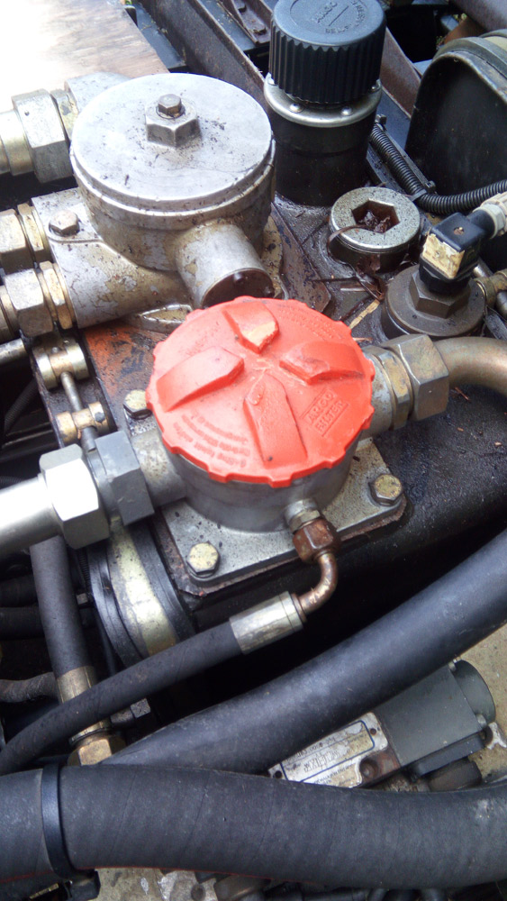

Is there a filter hiding under this? Or it somewhere else
Idris
1992 PB240D
Hydraulic filter.
If it's under here, how do I get the thing off? the center lugs have been chewed up by a previous monkey. I've had a strap wrench round the outside and a 6ft bar on it and nothing.

Hi Tom, yes that is your hydraulic filter housing and yes the cap can be difficult to remove. I use a tool that has a long square shaft that is the perfect fit too wedge between two of the "lugs" on top of the cap. It is about 2' long and gives me enough leverage to break the cap loose. I have no idea if there was a special tool made for this cap or not? I've seen them in much worse condition then yours, just keep trying!
I buy my filters from Pisten Bully p/n 8.216.543.320 and it includes a new ring for the cap. It is an Argo filter made in Germany p/n S2.0923-00 but I have never tried to source one directly. I would verify the number for your machine but I would be surprised if it was different from mine.

it is treaded ,mine looks the same . a long filter is inside .
my part number is different .if you get set up you can look up parts directly and see how it is put together.
the pistonbully wep page has a link to it. I had the pb parts person help set it up for me.
