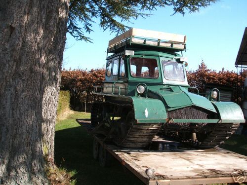

After lots of research (should have done more!)I have purchased a Snow Trac ST4 '63. One more for the Snow Trac camp it would appear...
You guys seem clued up as to where to get bits from and I was wondering if you could help.
The Snow Trac is now in its new home in the French Alps, removed last week from Scotland where it had spent its life on the HRH the Queens Estate, Balmoral.

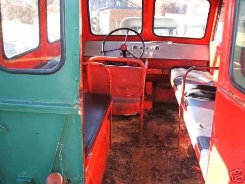

You have the old style drivers seat, but the new style large front wheels. There were only a couple years when those overlapped from what I can recall, but Lyndon probably would be the best person to nail down the production years.
