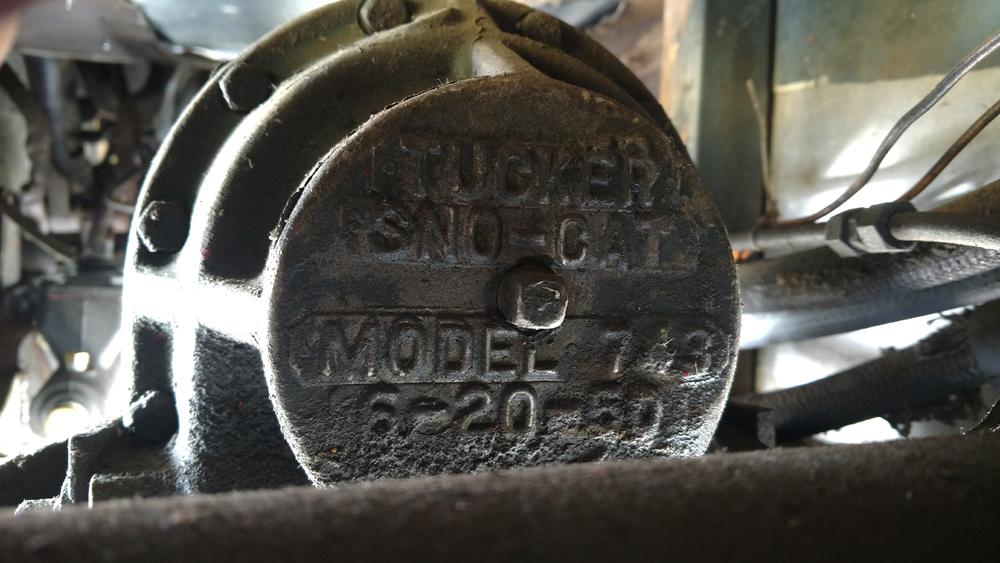

its amazing to me how many parts Tucker put there name on , my cat is a 53 and the transfer case says 50. I thought they didn't make a 743 until 1953 ?
