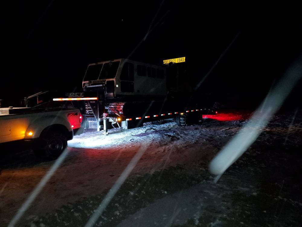

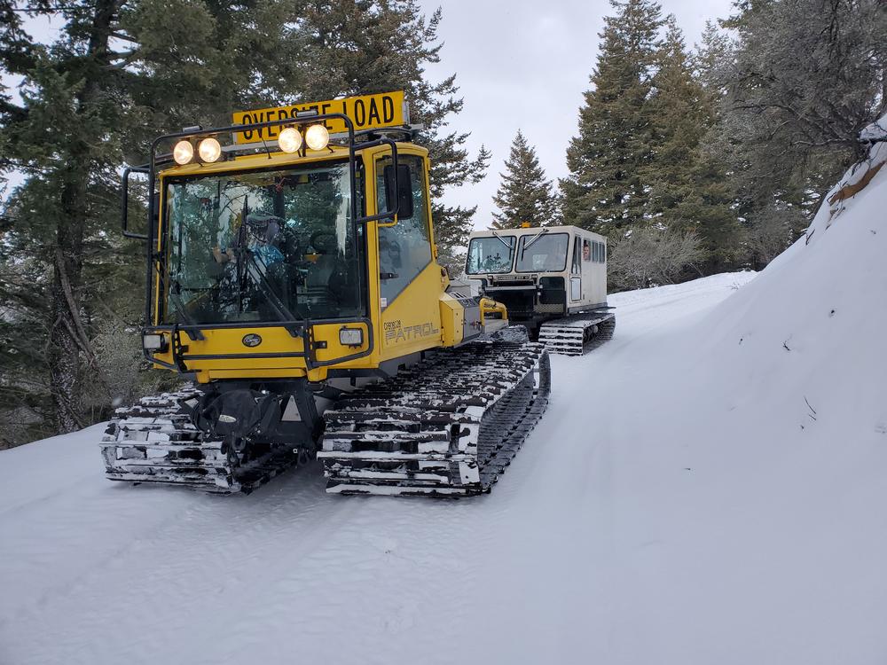

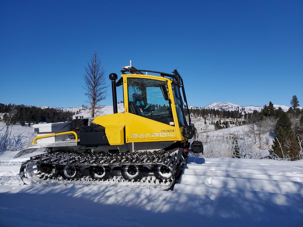

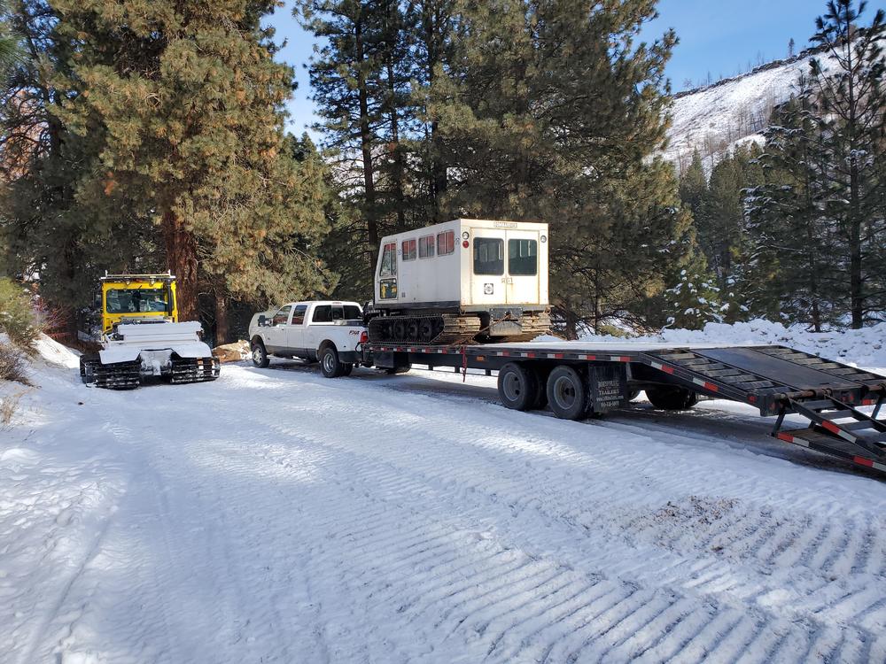

Finally got to take the Patrol out for a spin. Couple little things (isn't there always?) but hopefully no big deals. First day made a loop about 14 miles alone, second day went about 19 miles farther up the mountain, with the crew. One herd of around 75 elk, and another of about 20, and one mangy coyote. Trinity mountains, west of Sun Valley, North of Soldier. Turned around at a dead fall across the road, running out of time anyway, maybe 7500 feet, (Trinity LO is 9900' ) about 21 inches of snow there.

how dose the truck do hauling both cats ? nice set up.
It works good, for me, but I remember when I was a kid we had a Pete with a 318 Detroit. Cabbage hill is 7 miles of 7%, and it took me 1 hour to get from the bottom to the top. Everything is an improvement from there right?
It's the 6.7, F350, drw, auto trans and grossing, I'm guessing about 32,000# this day, it still can maintain 50 on most hills, 70 freeway. Of course more weight is not your friend uphill or downhill on slick roads, but with some caution, experience, and chains if needed, it's ok. DRW are only good if you need that for weight, but having that on the tow rig makes it easier to opt for that on a trailer because your already cutting that track. I have to move both cats up to the front, fold the ramps up and then move the rear cat back to onto the ramps a bit to distribute weight correctly. Pump the air bags on the truck up to about 85 psi. and that levels it out pretty good.
It looked like you had about the same set up for hauling the Tin Cup Tucker, is it?

I think thar Patol is an awesome machine,but wonder if not having a blade has posed any problens?
I'm new enough at this that I haven't had a problem yet, but I suspect that there will be times. With the high altitude, bare wind blown summits/saddles found in the western U.S. causing steep side slopes, it's bound to come up I'm sure. On this machine the frame is built to take a blade but no hydraulics for it.
Pederson's in Utah said they have added blades to Troopers, used br blade and OEM engine driven pump, not to difficult. Or I might find a used blade and use a battery powered pump set up. I understand the hydraulics are slower with the battery pump set up and the engine driven pump takes some hp constantly. With the wide tracks, flotation seems pretty good so I don't know how much I need the blade for compaction as apposed to just cutting a side slope to a level track occasionally. Is my use ultimately 30% or 3% of the time.
Not sure but thinking a little more experience might help me decide.
