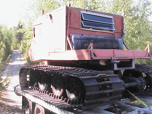

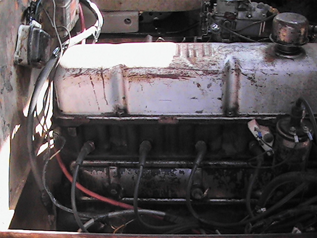

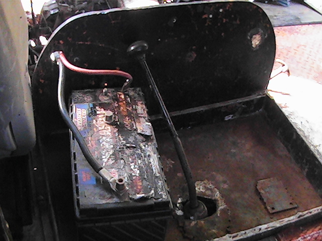

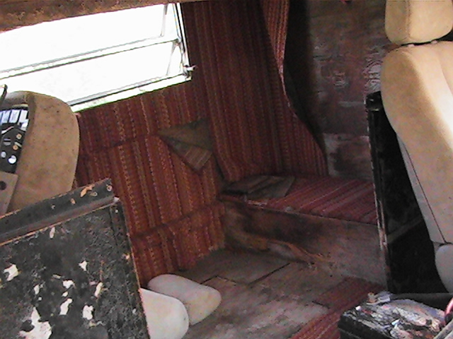

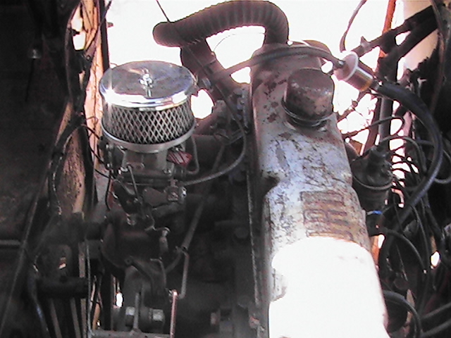

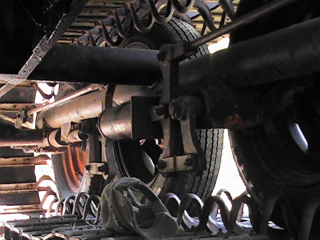

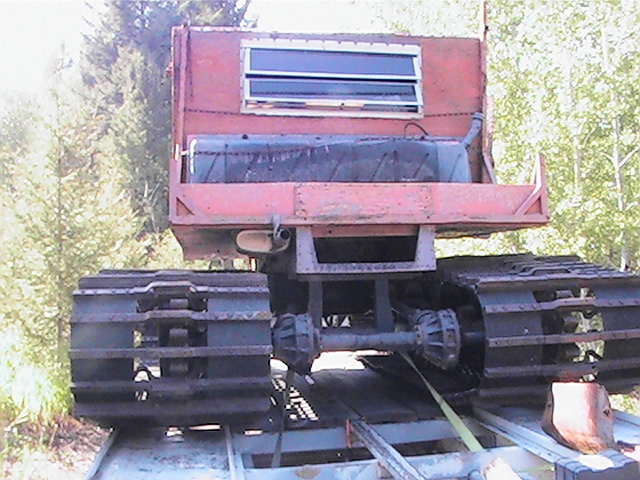

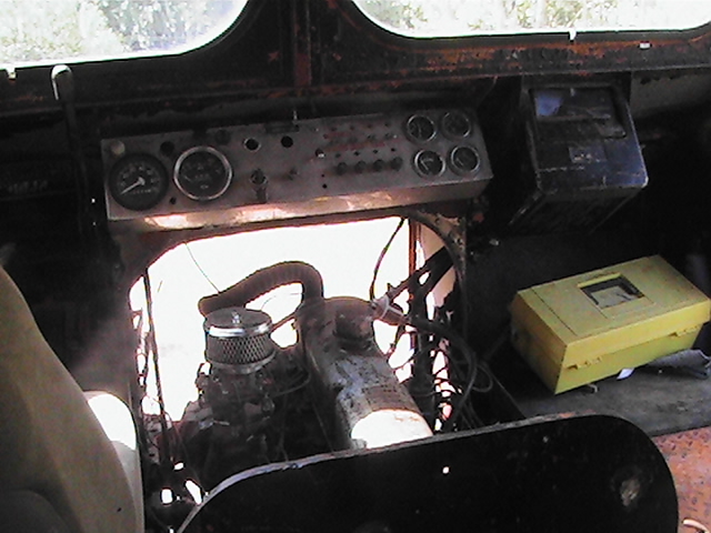

OK guys I got pictures will try to up load them

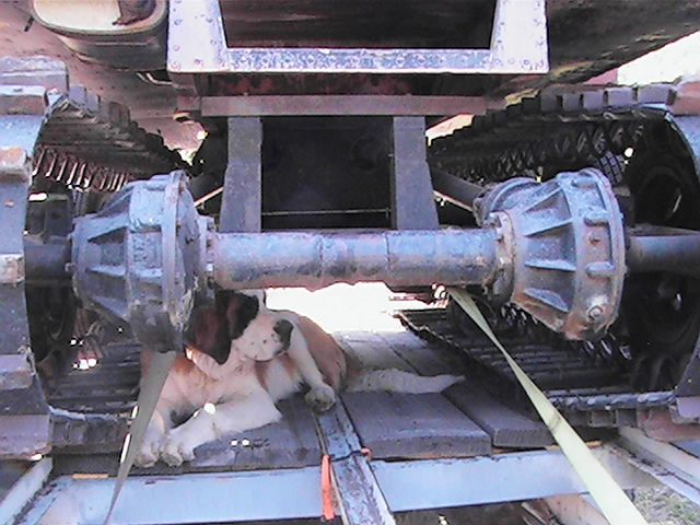

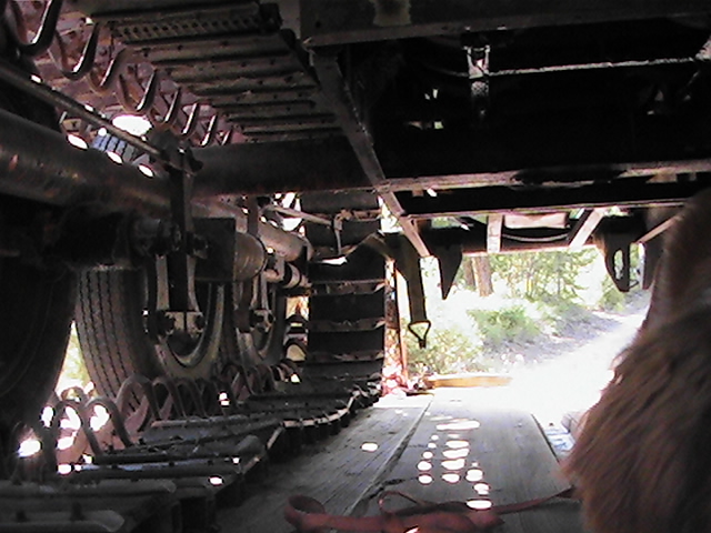

Mike8623

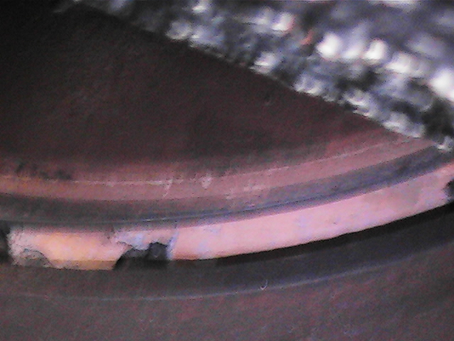

more pictures the first of these shows the clutch discs.

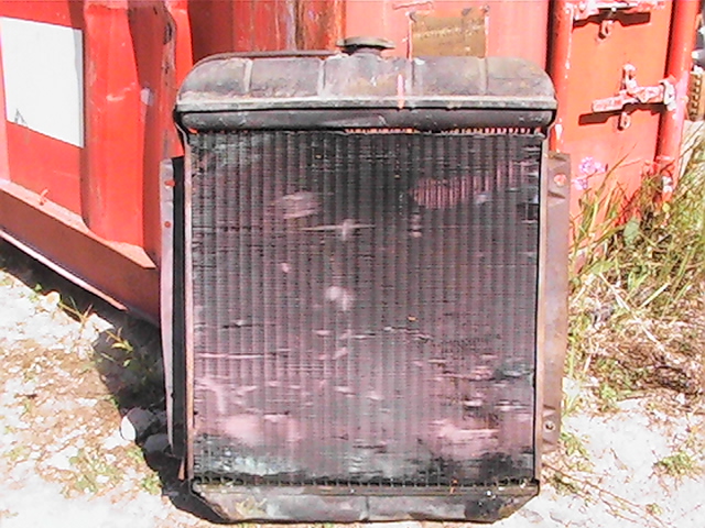

Mike8623

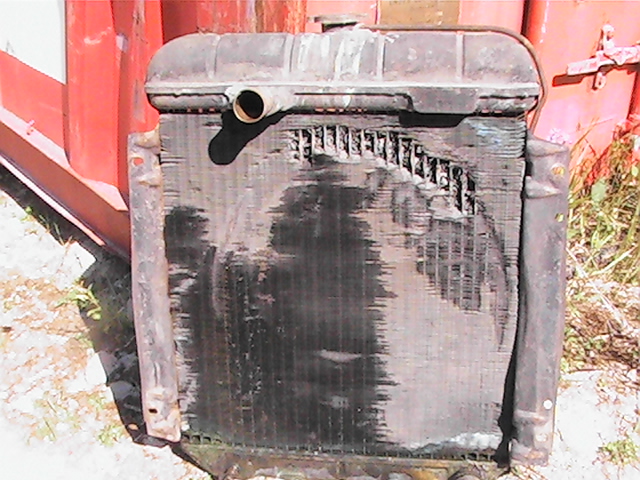

Last two pictures of the radiator
Mike8623
The last two pictures of the radiator

Thanks for the pictures,
Those sprockets need some rubber on them! It's all gone! At the least
They can be revulcanized there is a company that does those it eludes me right now who it is. But others have wrapped the profile with belting and attached it to the sprocket face before with moderate success.
Tracks do not look to bad ( after looking better I noticed maybe real bad dry rot in a photo ) look at them close
How's the engine?
How far do you need to go in the winter? 4 miles ?
I do not think you will find a radiator like that anymore but maybe,I would convert to more modern
Mike8623
Yes, I am focusing on the radiator, someone out there must have one of these and have replaced the radiator and have a number or make that they used, I'm going to undue the tracks and remove the sprockets here pretty quick and send them in for a redue unless someone has a set they want to sell, any tips on removing them would be appreciated, The tracks can wait until next year I hope.
I would really like to find a radiator now though!! I'm sure that radiator was used on a car, truck or tractor at some point, someone must know something.
Dr. Zaugg
Knowing Thiokol I would bet the radiator is from a F-100 pickup of about the same vintage. I have even found some Falcon parts that were used!
sno-drifter
Mike,
You have the tanks, flanges and dimensions, take it to a radiator shop and put a new core in it. You don't want to be let down out in the deep.
jp11
Mike,
For sure. I re cored the one in my ASV. Sure, I could have bought new. I got 25% more cooling for less than 100 bucks more than a stock radiator. Find a real radiator shop. I think the one I used has been in business since the 20s!

Well guys since reading and looking everywhere, a lot of promising but false leads I took my radiator down to a local shop for recoring, it looks like it will cost about $400.00.
