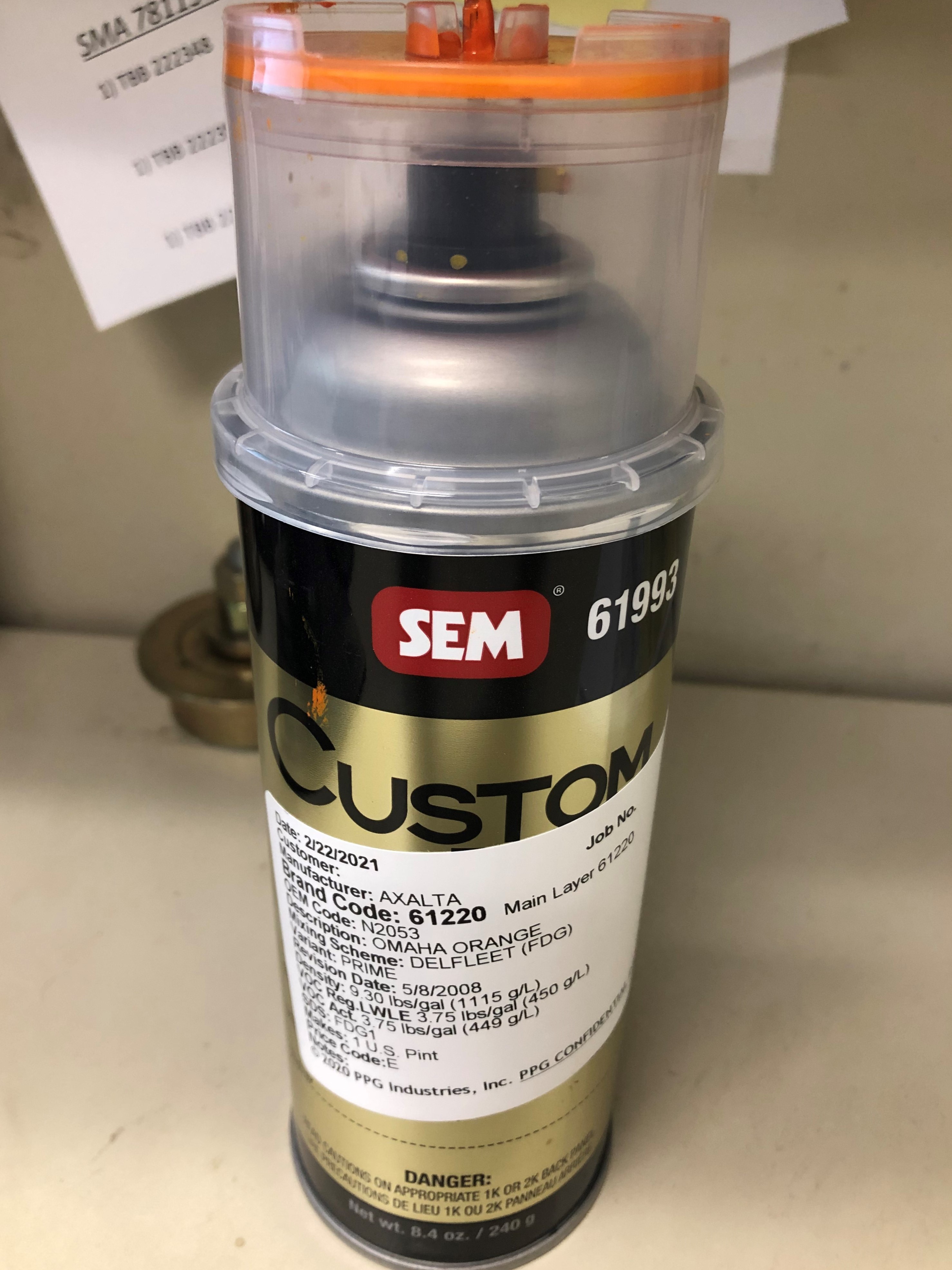

I would like to find out what restoration community guys use to paint their cats. Im looking to buy paint sprayer and would like to ask your experience with different brands you use

As was I before my first paint job. Taking it to a body shop was way too expensive for me and with a little practice and learning the right spray technique and paint mix you'd be surprised what you can get. With rattle cans the paint is pre thinned to spray out of the can but you get thinner coats and I would have payed as much for them and gotten a lighter coat than using a gun and paint. Keep the rattle cans for interior work or touch ups. Also, if you use a custom color, most paint stores can load that paint into spray cans for later use....Bob
