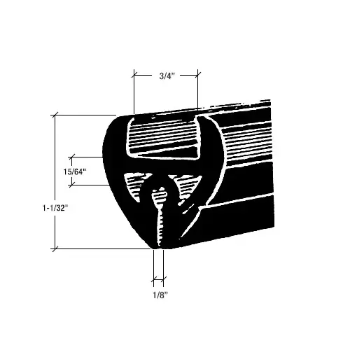

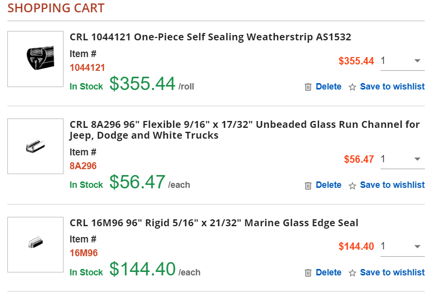

My Super Imp has the dual glass sliding windows in the doors. The rubber and tracks are weathered and need replaced. After a bunch of searching I think i've found replacement gaskets. BUT I can only find the wide track in a 50' roll for 355 dollars.
Has anyone else ever replaced these? Have a better source? Or left over material?
I thought about buying the entire roll and selling off what's left for others who need to the same thing. The links are below.

I ordered the flexible channels from DK Hardware (10G Flexible 72" Channel for 1950-1962 Chevy and GMC Trucks without Framed Glass
Tray Item #:10G72) and it looks like they fit. I have been hoping to salvage the main gaskets but so far haven't figured out how to install all the parts. I'm planning to take it all to a local glass shop and have them install. Does anyone know if there some way to remove the doors so I don't have to trailer the whole rig to the shop?
