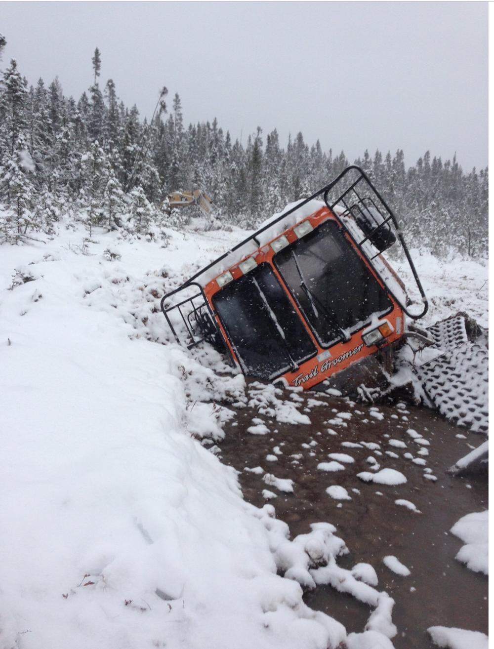

MNoutdoors
Tracked Evolution Central
Rear sprocket drives pull the front down for climbing hills. and also pull sleds better if brake steered.
Front drive machine are made to lift the front up and out like in swamps. Don’t pull sleds very good unless ram steered.
Tucker’s don’t do swamps well. The track dives into the swamp
Tracked tractors don’t do swamps well either
