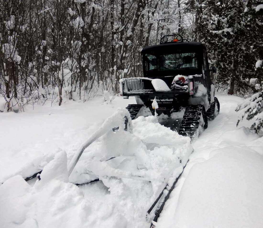

alryA
If walt or anyone wants to groom trails, you need to decided what type they will be, that is, who is the end user. Plus what implement you intend to use to create that trail with. I asked if he hoped to till and did not get a response, so I'll guess not.
Grooming XC trails is my forte but I've also done sled trails.
