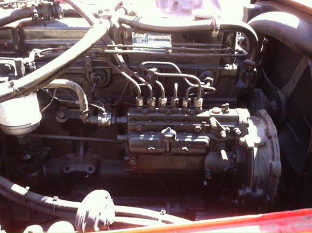

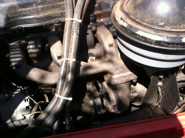

I just purchased a new Thiokol 2100 today sight unseen. I wanted to get the one mike had and was ready to send off money when he sent me an e-mail of one for sale on the west coast. the savings were too much turn down so I transferred money today here are some pics of it comes with a turbo diesel and blade.

mike would need the manifold too to add the turbo to his model. my question is that thiokol shows the turbo to be for high altitude only, am I going to have head gasket problems running it at sea level?

Can't tell by the pic. Does it have a waste gate?
Cletis
Cletis, I doubt it would have a waste gate....I believe the pump settings for fuel are the same for natural asperated or this altitude compensating turbo...
Caterpillar did the same on some old D4's back in the day. They left the fuel settings the same as the none turboed versions.
Regards, Kirk
waste gates are used to improve on turbo performance across your operating band, my early cummins has a non waste gated turbo and pumps out about 30 psi of boost. i'm, taking a stab in the dark and I betting this one only makes about 10 psi as kirk says it's an altitude compensating turbo. where the what if comes in is that from what i've been reading is the engine is a 19 to 1 compression ratio which is quite high, kind of like the old 6.2 gm diesels which didn't last as long when you put turbos on them. you will notice engines like the cummins and power joke all have lower compression ratios to allow for higher boost on the turbo.
My 06 Ford 6.0 liter is 19 to one and see's 28 pounds of boost. It isn't any wonder they had some head gasket issues though. That compression ratio, and boost level almost makes it hard to believe it can hold itself together. Must have a stout lower end.
At sea level I thinks Don's engine will be just fine. Just leave the pump settings alone. Some one some where probably figured this all out years ago.
Regards, Kirk
Not be a buzz kill. there is a statement in the product literature *safety one* that says turbo only above 4500 elevation of something to that effect.
Like Kirks comment, I think that statement is directed to when the machine is operating at the critical end of WOT. Just cruising dragging a bit of freight utilizing a fraction of what that machine is capable of I agree it will be fine.
maybe a pyrometer is in order.? I used a 2100 to drag snowmobile trails last winter and it just sniffs fuel. My fuel burn was less than 1.45 gal per hour. High gear 10' (9'6") arrowhead drag flat ground.
Mike
yes Mike I don't think the turbo model needs a pyro, but your n/a model would need one . the turbo models would need less cooling capacity at high altitudes. the cooling system that may be adequate on paper isn't going to work at altitude as water boils at lower temps as pressure drops. I forgot what the formula was but it was substantial this may be the meaning of turbo only at high altitudes my concern would be the longevity of head gaskets and stud stretch running at sea level where the air is denser. im guessing that isn't a problem as ford put a lot of those motors into tractors with turbo's and and didn't list then for high altitude only.

did a little searching on the power plant I may have found it.
I think it is turkish built ford. Search otosan. 6.2L of Krusty Krusher..
