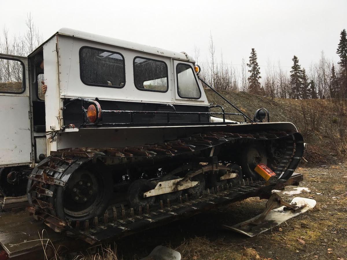

Snowyriver
Willow AK
Photos

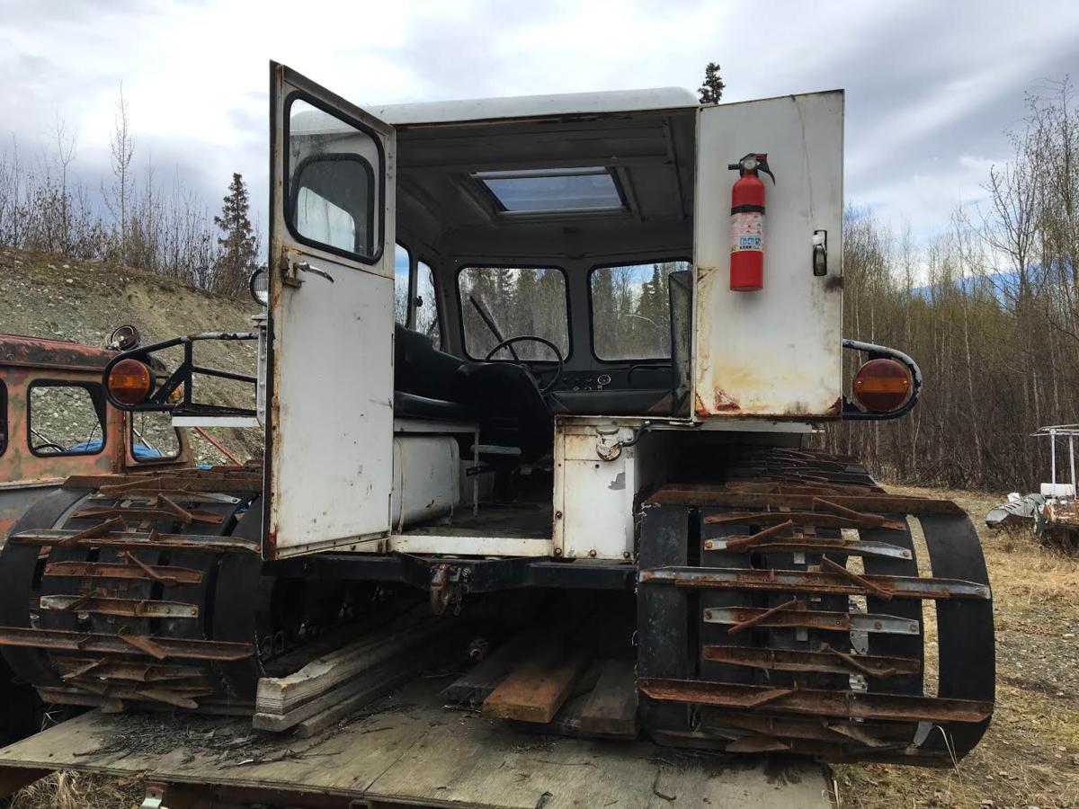

Snowyriver
More

The orange one runs. I was driving it and making shallow short turns to go the other way and it kind of felt like it was binding up, I heard a loud bang, and it did bind up and stopped moving. Now left front tire is riding up on the metal pieces the sprocket engages. Now the left front tire is lined up with the center hub, not the outer sprocket like the other side.
nikos
Snowyriver Thanks For the Pics.
My opinion is that the Sprocket came to close to the left front tire.
You have to check the Left Track Adjustment for the drive chain, if it is broken.
Any other fotos for the side of engine. We need extra informations
