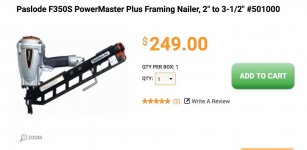

Bannedjoe
After two days of research, and some suggestions here, I decided on a Paslode.
This should prove to be an all purpose gun.
It will shoot a round head .113 2 inch nail (roof sheathing) all the way up to a 3 1/2 .131(framing) nail.
It's paper collated, so there won't be little bits of plastic all over the place, it's adjustable, and has a no mar foot adaptor. (extra charge)
Thanks for the suggestions!
