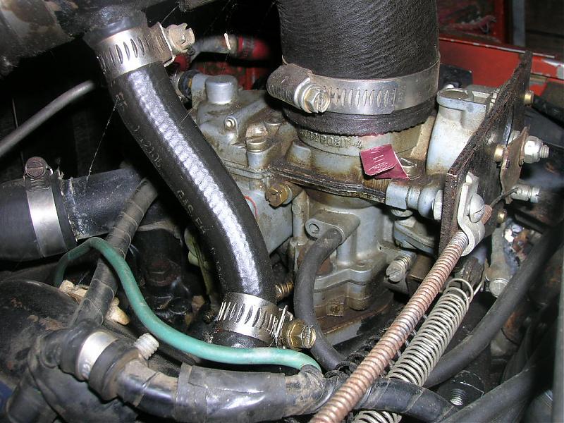

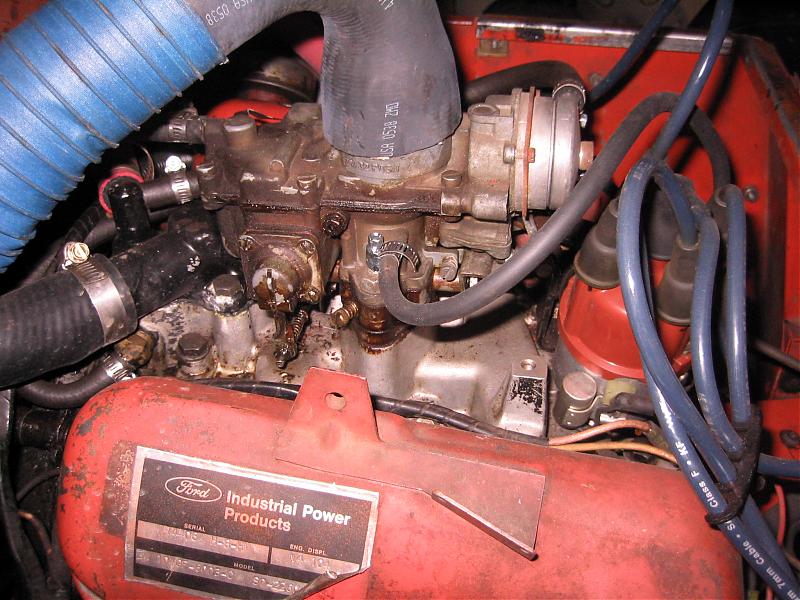

This is what is on my 70's Imp for Carburation, pretty much the same as yours but mine is converted to a manual choke. The numbers on the pink parts tag are for Ford 11 436 198
You may be able to get the local Ford dealer to give you a number for it or cross it over to another parts supply brand or cross over at the auto part stores....
If you find where to order a kit, let me know I may do the same just to have the parts on hand.

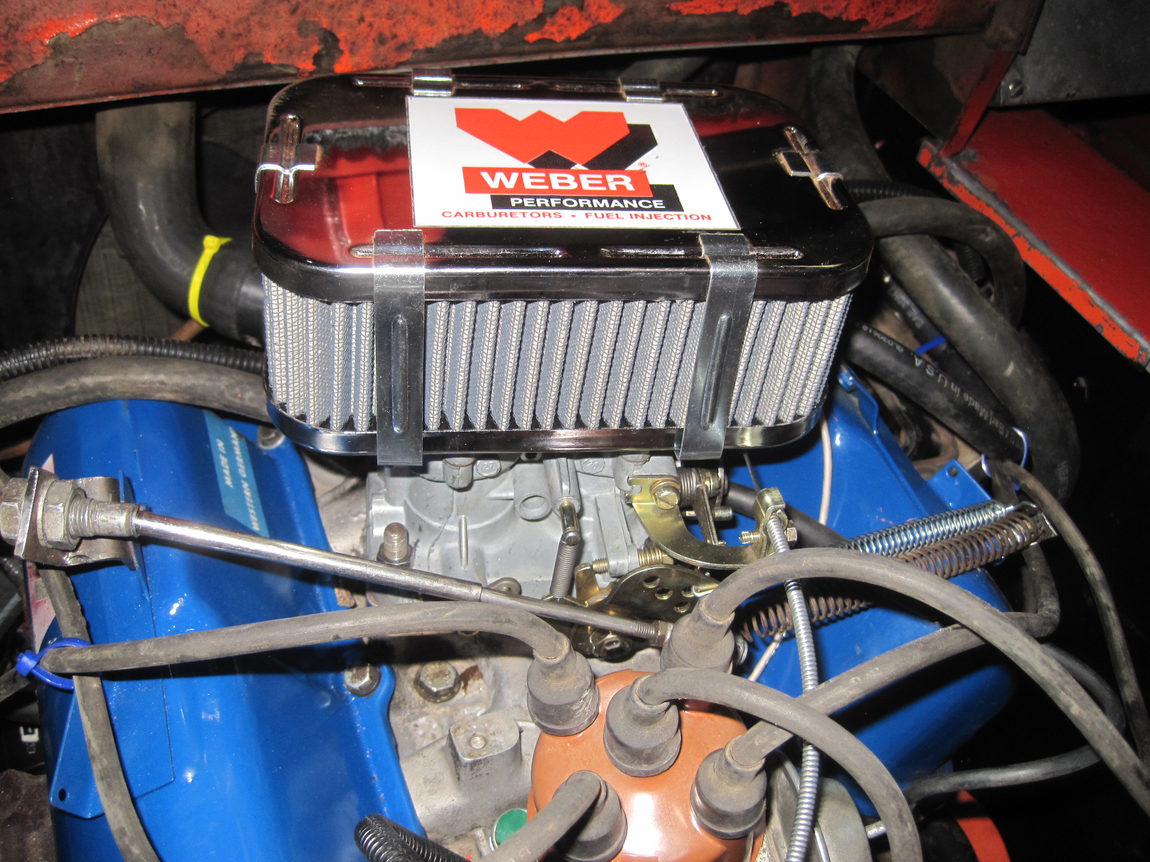

The best replacement carb that i have found is a Weber 32ich this carb works great and is a easy replacement. most import parts suppliers can order they also should have a jetting chart so you can jet it for your altitude

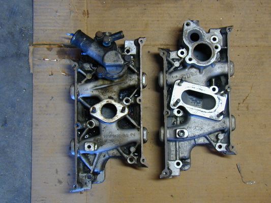

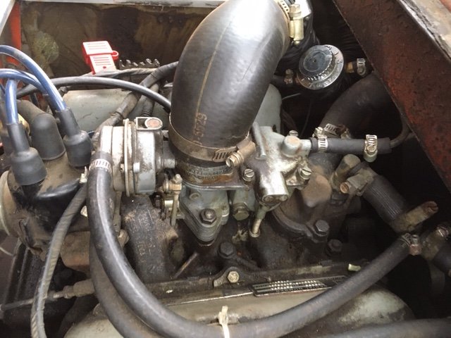

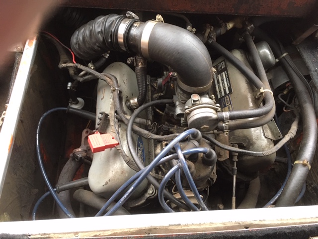

If you need an original 1977 Thiokol Imp V4 Solex carb with 814 hours on it, I have one in great condition that I removed from my Imp. The Solex was running awesome when removed in 2020, but the Imp now has a 2 BBL Weber upgrade for high altitude (10 to12,000' A.S.L.) ops. PM me if you are interested in the 1 BBL Solex carb and/or 1 BBL manifold.
Solex are the two pictures on the left.
