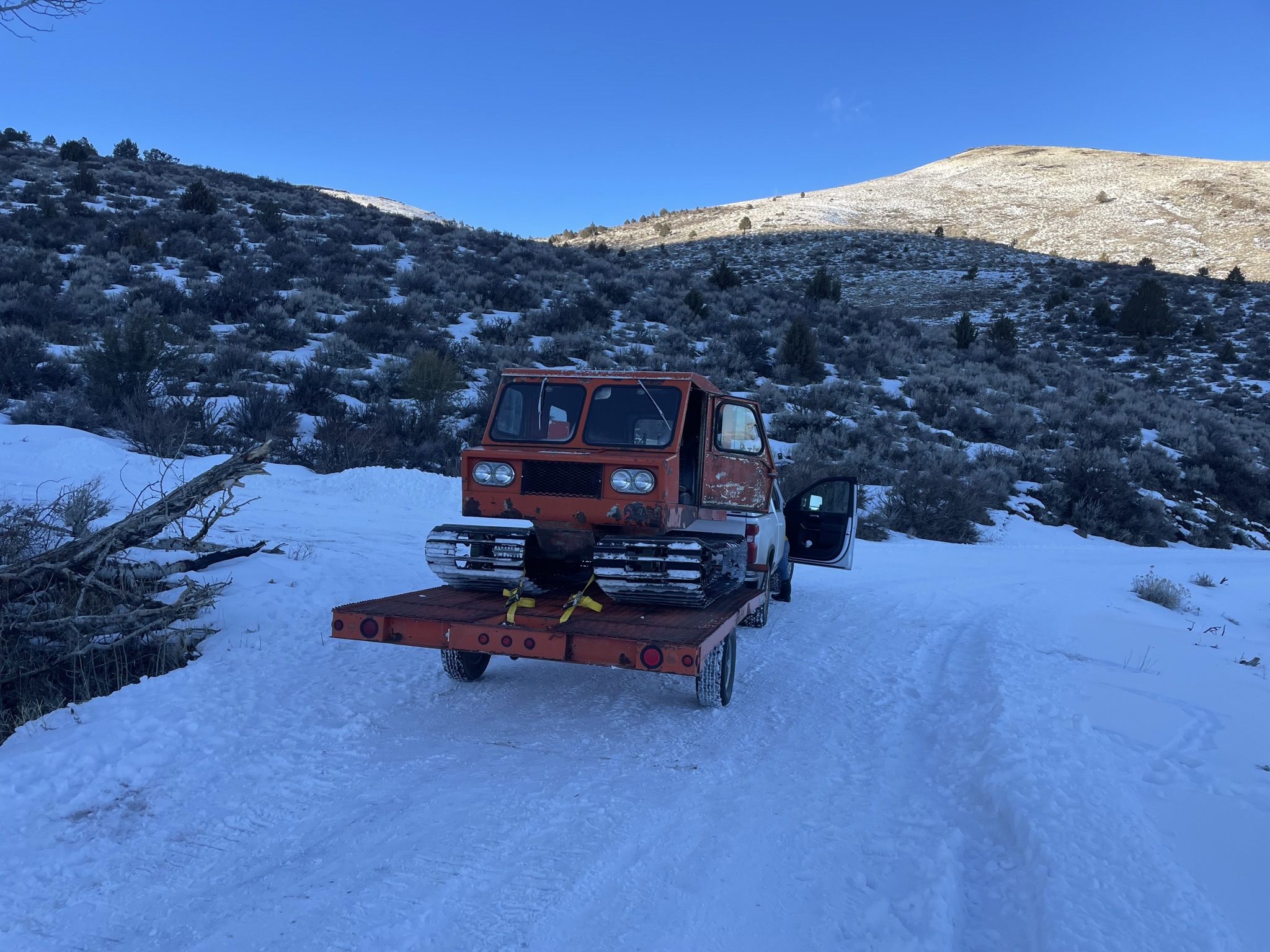

Ok so I’ve been here for a bit. I thought it was time to start an ongoing repair thread for IMP 669. This was the unit and matching trailer for sale during the holidays on KSL. The family and I did a 1200 mile round trip to pick it and it’s matching trailer up. We’re in Southern Idaho. The cat was in Northern California, northeast corner.
On the day of pickup, I had to swap out the old hubs on the trailer so I could use a set of 6 lug trailer wheels I had from my deck over trailer. The condition of the old 14.5” tires on the trailer was bad. They would not have made it 100 miles. I ordered a set of conversion hubs through R and P carriages that would fit the #42 spindles on the old axle. I pre-packed the bearings so all I would have to do is remove the center nut, and pull the old wheels off, Install the new 2-1/4“ inner seal, and bolt new hubs on. Piece of cake. I had both sides rebuilt and towable within an hour. The trailer lights were completely shot. I’ve never seen wire insulation turn to dust. Luckily, I had brought a pair of magnetic tow lights, so I slapped ’on after loading the cat.
Now for the good part. The Imp was about 6 miles down the road, and 4 miles up his access road, dead. He hadn’t had the chance to install the new carb or alternator. Sooo, I towed the trailer up the road to the cat. Oh yea, there was a solid foot of snow on the road. Parts of the road was over 10% grade, so we had that going for us. Luckily there was a wye in the road where I could get turned around, to load the cat. I brought a 4000# come-a-long and a bunch of rigging goodies to load the cat. We drug the cat down backwards with a recovery rope. I then backed the trailer right up to the cat, tilted it down, rigged up the come along, and proceeded to yank the imp onto the trailer. It wasn’t easy, but I got loaded. by now it was getting close to dusk, so we headed out back towards Burns, Oregon. The trailer did great, it towed like a dream. We made it back to home the following day without incident.

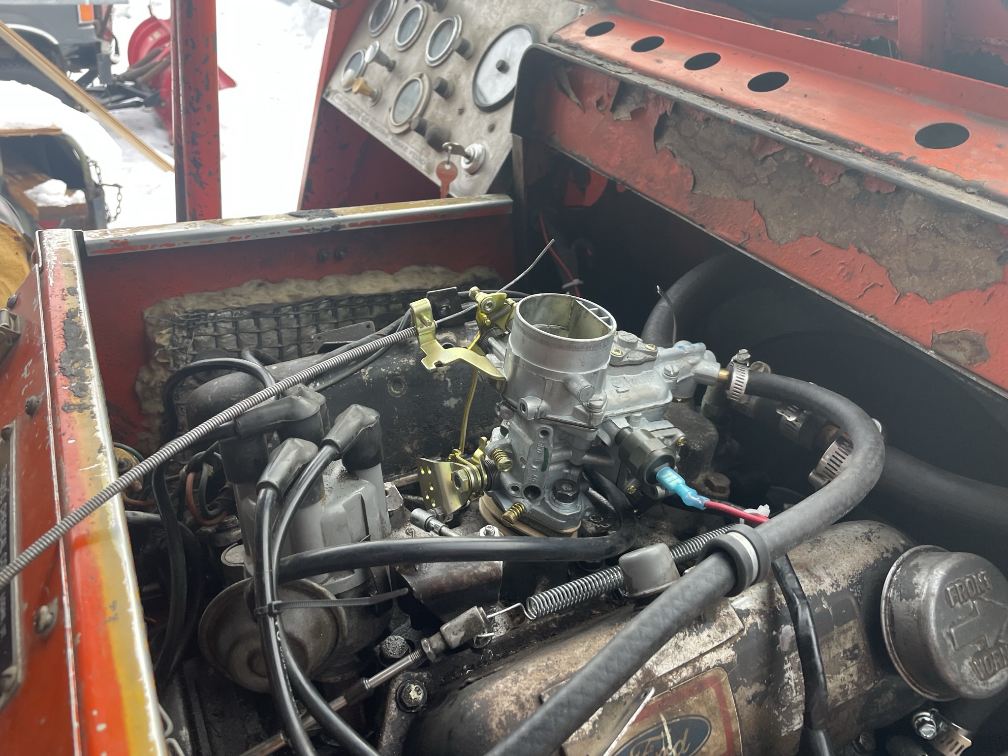

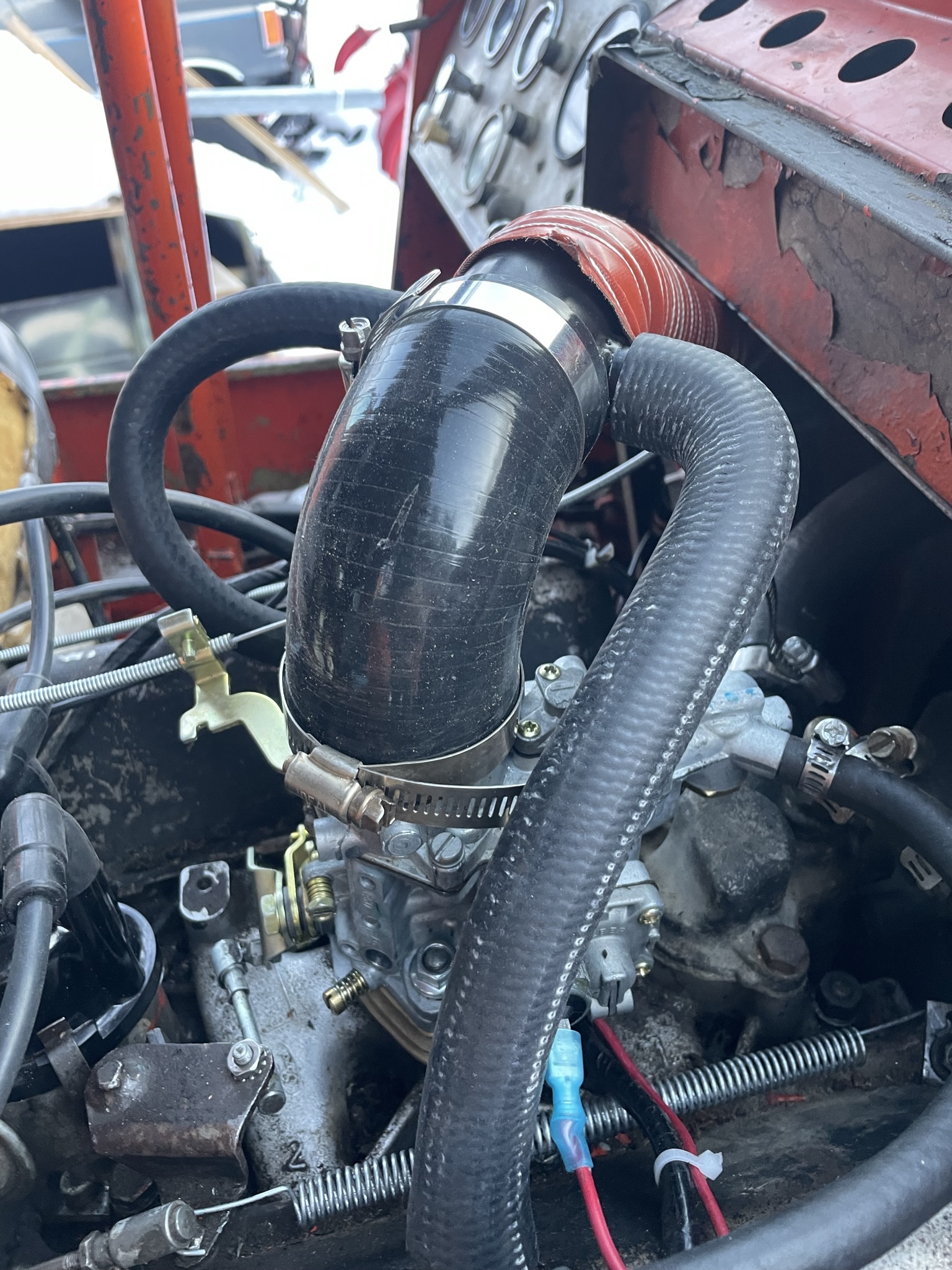

Time for an update. After better temps and a bit of time, I was able to get the new Weber carb installed. It was an easy install. I had to flip-flop the final linkage rod as the new bracket was slightly different and underslung below the fulcrum. I had rigged a temporary choke cable to get it started. The carb came with 2 steel spacer blocks and fiberboard gaskets. The Weber does require a constant power lead, so I ran a permanently temporary wire from the ignition circuit. I found a 2” diameter scat hose on the Flea-Bay, as well as a silicone elbow to connect the carb to the original Donaldson oil bath filter behind the dash. For purposes of starting the engine and dialing in the carb, I ran without a filter. It fired right up! After being warmed sufficiently, I noticed a pretty decent stumble so I started looking at everything and discovered the plug wires were ran in numerical sequence, not in firing order. Wires were re-connected in proper firing order and engine runs smooth now. the Imp has 1154 hours on it. I‘m fairly certain the PO ran the cat with wires in sequence for who knows how long. I’ll be performing a full tune up shortly and installing a Pertronix ignition. The plug wires look original and they are hard as a rock. More to come shortly. I’m still in the discovery stage on this machine. Every time I turn a corner, I notice something else that needs to be fixed.

The carb could be jetted wrong. It's been decades though since I fiddled with Webers. I see in the pics the open vacuum port on the carb. Is that supposed to connect to the distributor?
Idaho IMP
Thanks PJL. The pictures I’ve taken are somewhat out of sequence. yes, that port you’ve called out is for the vacuum advance. It has been connected. I’ll call Dan at Snowcat Service today. He supplied the new carb to the PO just before I picked it up. A larger jet may be the answer.
PJL
Could be a vacuum leak somewhere else too. Spray some carb cleaner or other flammable around the base and see if the engine speed increases.

Sorry it’s been a while since I’ve posted but I’ve finally had the IMP off the trailer! Turns out the “New” Weber ICH 34 was missing the plug over the progression port on the outside, hence the massive vacuum leak. I have sourced and installed the missing plug and it runs great! I have also cleaned/reinstalled the original Donaldson oil bath air filter under the driver’s dash board and properly connected all breather lines to the air intake, etc.
