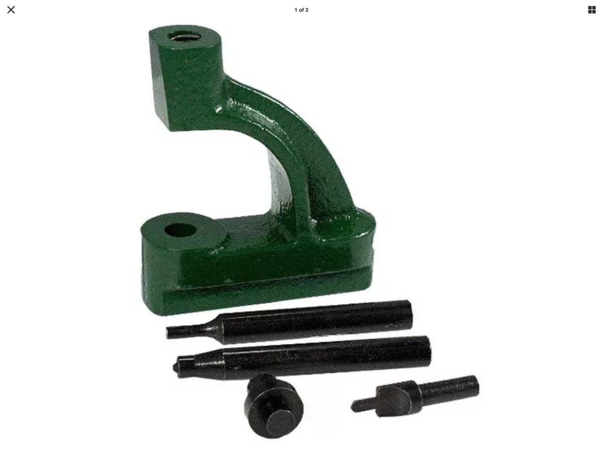

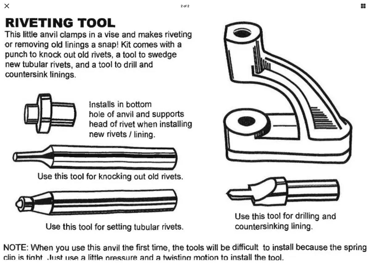

Bill, we have a small kit that allows you to do it yourself
It’s not fancy, but it gets it done
I’ll send a picture when I can

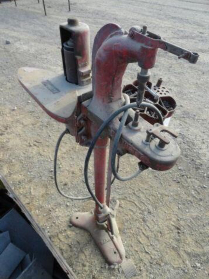

We use one like this

Huuuuumm Could she be thinking about an Estate sale this summer? I suspect she has no idea what his tools might be worth.
Trackrig
She turned most of the machines over to someone last summer to be sold. I've been in Brad's shops. He had a lot of parts and adequate tools like any decent shop. Supposedly I'm on the top of the list if she sells the brake rivet machine..................
