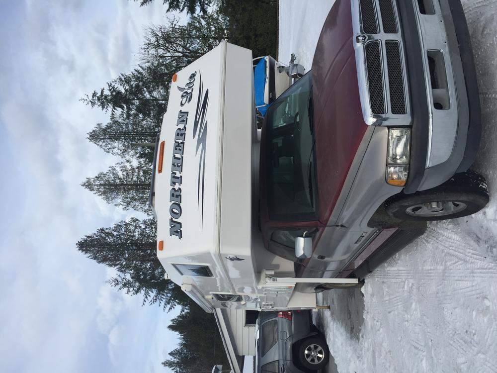

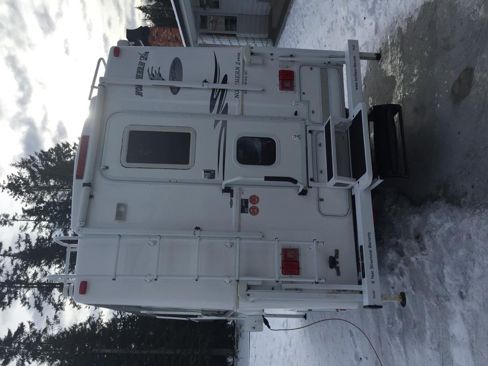

The misses brought me to our new camper today. 2011 Northern Lite 10.2 and it turns out it was a bank repo. The seller had a price 6K below anything like it on the internet. On top of that it was in Canada. Great exchange rate.
Now I need the truck to go get it. No pressure right ! Lol.....
