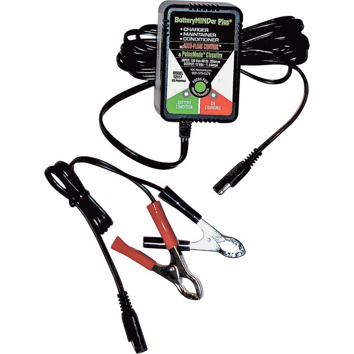

I use Battery Minder Charger/Maintainer/Desulfator. Mine are older models, 1 amp I think.
https://www.northerntool.com/shop/tools/product_200332201_200332201
Anything thats parked for any length of time gets one. No timers, on full time. The book says you can hook two identical batterys up to one charger but I have one charger for each battery.
The two tractors made it 10 years before needing a battery and the mower and RTV were 8 years.
I have the 2 pin sockets permanently wired on each vehicle so I don’t have to use the clips.
