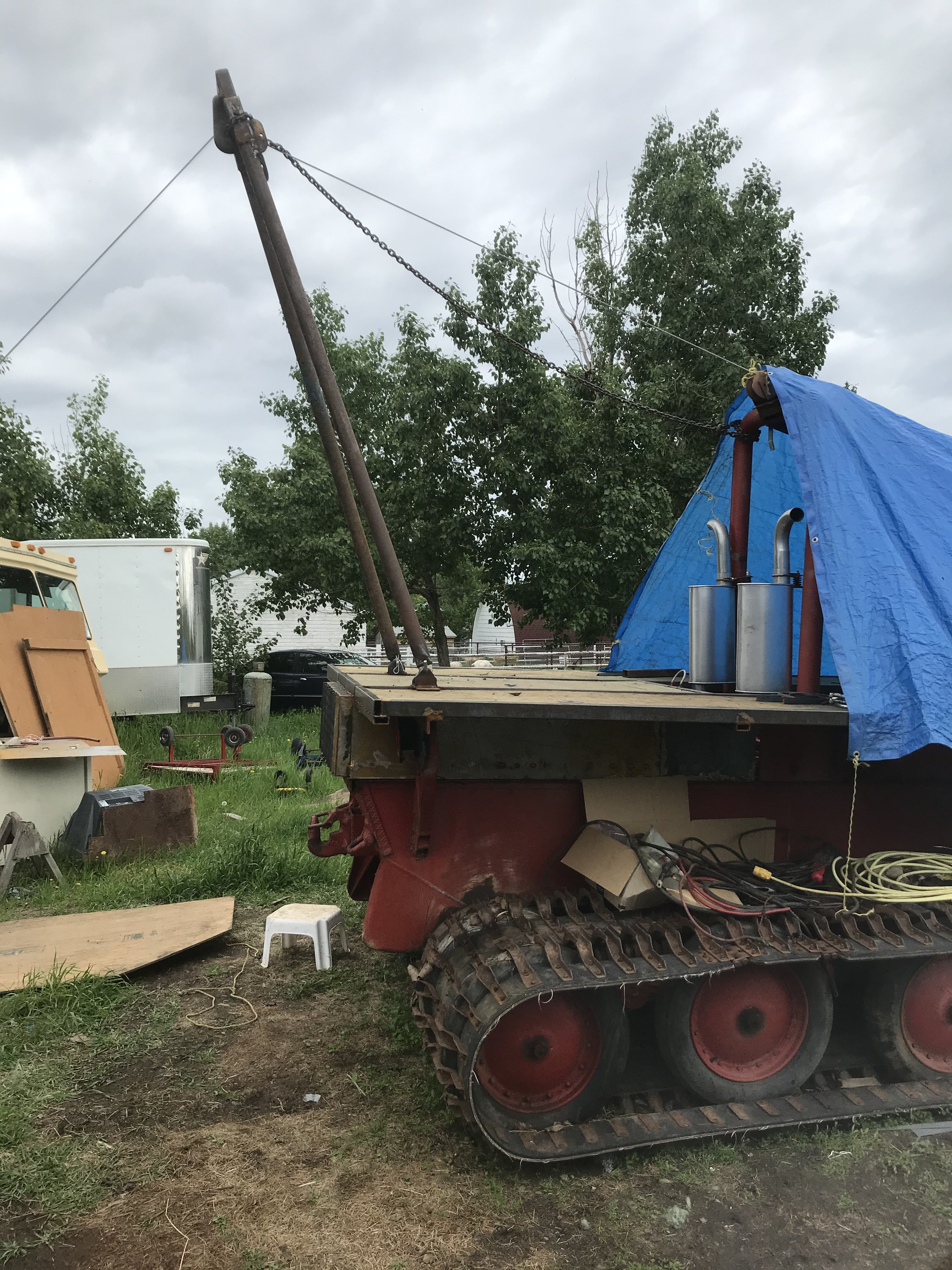

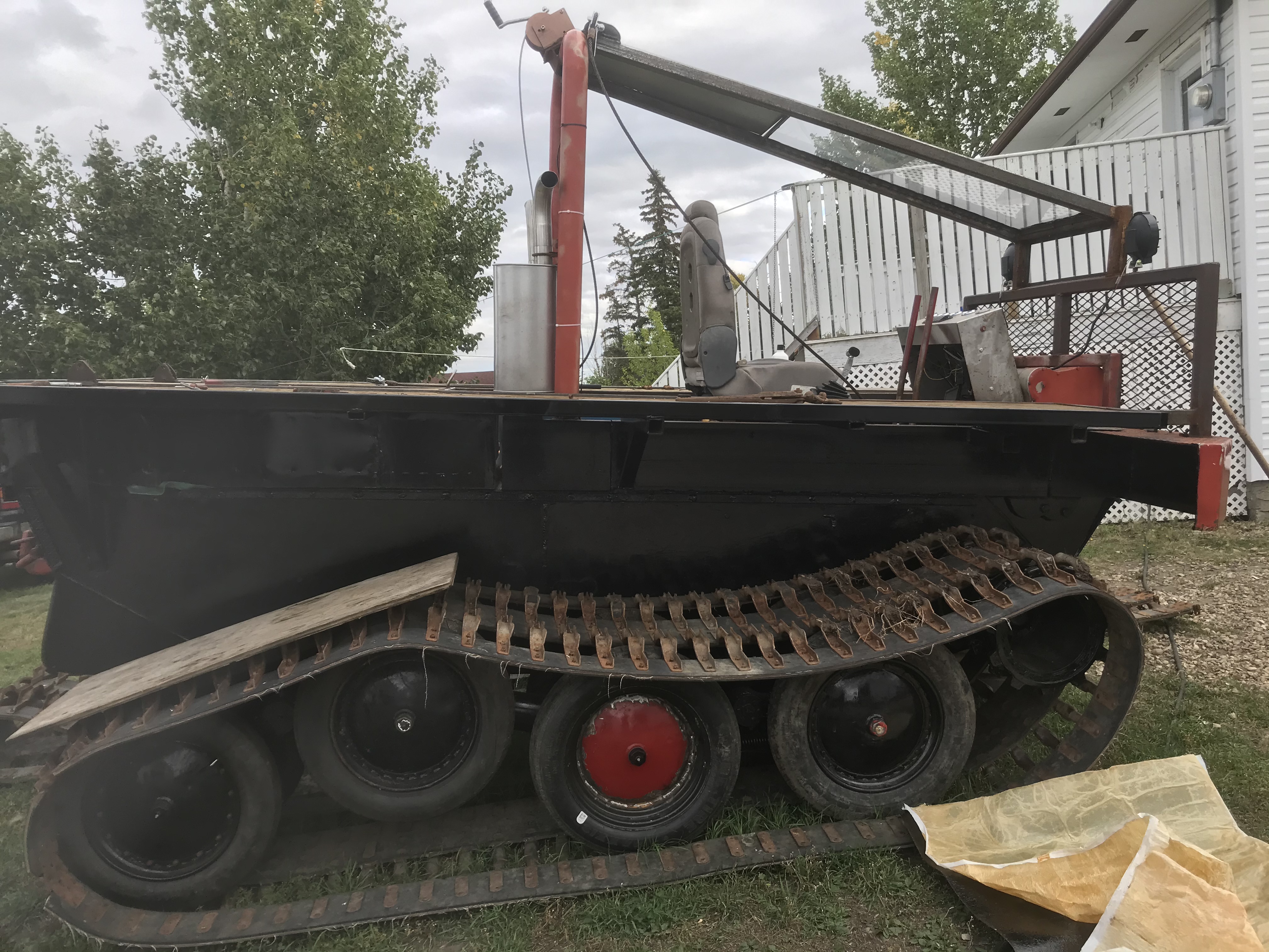

I use convenient spare tires from cars. They are 4.5x16 l use my tire machine to install and remove. Trying now tubeless tires after mod on old rims. 50 psi

Check at wreckers in the trunk. Many cars have the sizes you can use. I get them for 20 bucks T125 4.5 x 16
Hachet
My old unit
