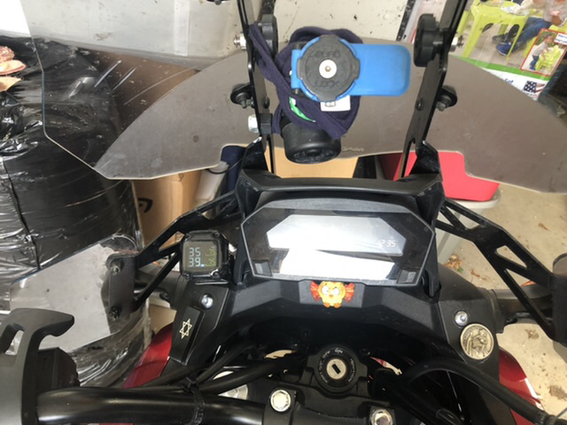

Today Santa in a brown truck pulled into my driveway and delivered 2 of the TPMS units from Amazon.
I plugged one of the units in to charge it and went about the process of mounting it, and the sensors to my bike. After charging I popped the head unit into place and it worked. Synced up automatically with the tires and off I rode.
While I was gone the other head unit was connected to the charger. Got home and installed that onto the lovely Mrs_Bob
s bike. Only the front tire is registering pressure and temperature. And the head unit only displays Celsius but won't work in Fahrenheit. Hmmm. Dead battery in the rear sensor? Bad head unit? Dead something else? I dunno. I'll try to figure it out tomorrow. Or send it back for a replacement.
Amazon is sending out a new unit to replace the apparently defective unit I received. Hopefully the replacement will be fully functional.
Tried again today, got the rear tire sensor to work so now the whole system is working, but the temperature sensors are still only reading Celsius and I can't get it to read Fahrenheit.
When I reset the system the rear sensor started flashing with a low pressure warning. Rode the bike out of the garage and the pressure reading was showing up before I got to the road, so less than 150 feet before it was displayed.

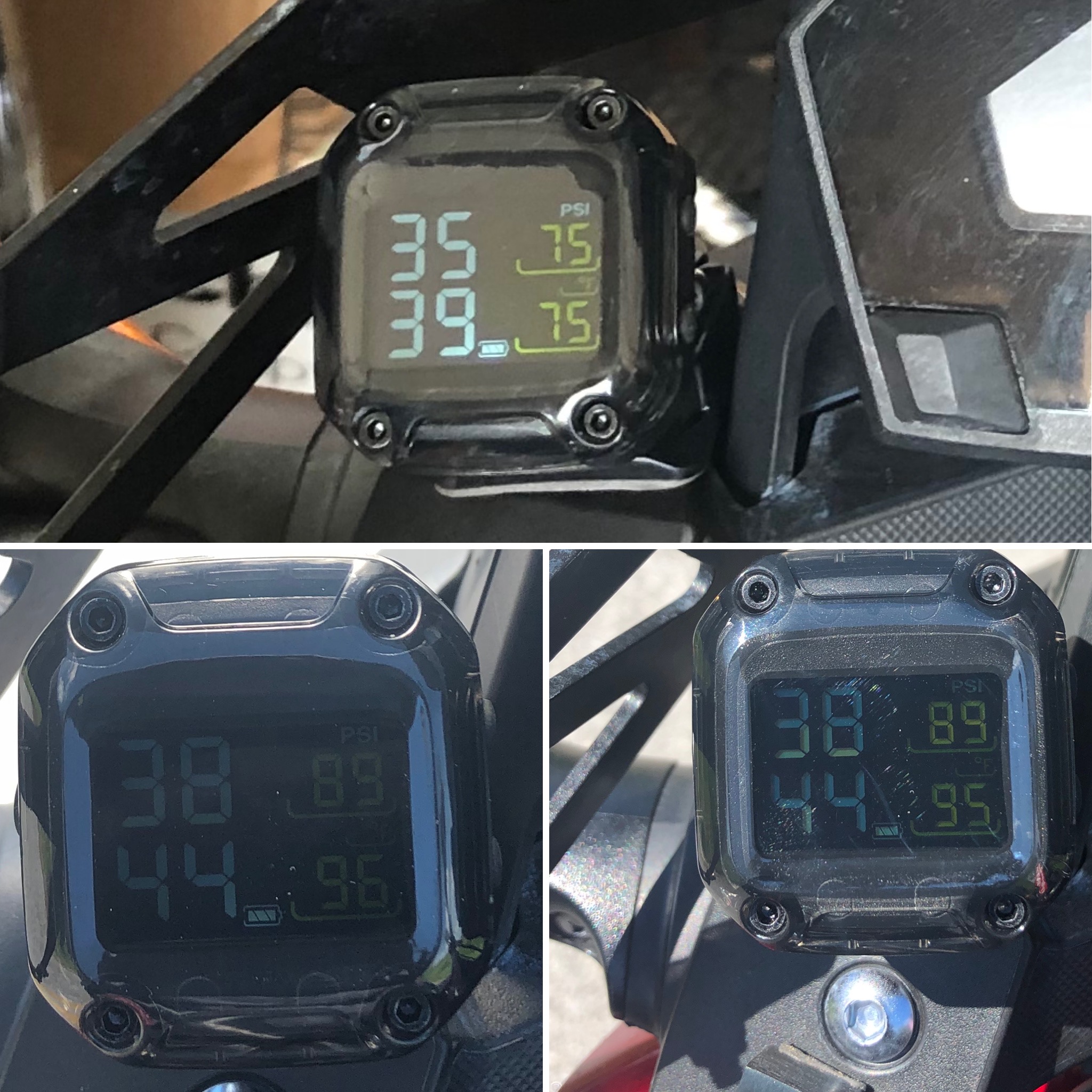

You can see the display sitting on the left side of the dash of my bike. 35# front tire. 39# rear tire. Both tires showing 75 degrees Fahrenheit.

PreRide pressures & temperatures
MidRide and post ride. Handy little device.
Been playing around with the tire pressures.
If I recall, the factory tire pressure recommendation for my motorcycle is 36psi Front & 41psi Rear
At those pressures I found the bike skittish, especially in some of the rural areas I ride where gravel is often scattered on corners and occasionally out in the road. Especially the rear tire, which, if inflated to 41psi would often climb to 44 or 45psi as the tire heated up. At those pressures the tire was rock hard and if it hit a rock it would typically "spit" it out to one side or the other, causing the bike to be slightly upset, instead of rolling over the rock.
I've now settled on 35F/35R and seem pretty happy with those pressures, the tires seem to stick better to the roadways, the bike is no longer "spitting"gravel and seems much more stable in the corners.
Much lower than those pressures and the bike also acts squirrelly in the corners, but doesn't bounce or spit rocks like at the higher pressures. When starting out at 35/35 psi for the front rears, the pressures typically increase to about 38psi as the tires warm up and stay at those pressure while out riding on normal summer days.
FWIW, when riding on hot/sunny days, the tires will heat up and the pressures will increase 3 to 5 psi. I noticed that when the tire pressure was about 40PSI the pressures could increase up to 5 additional psi. But at pressures in the mid-30's, I only notice the pressures going up about 3 psi. So I'm wondering if higher starting pressures = higher growth in riding pressure do to higher tire temperatures? This is observational, and could be based on weather conditions, as I've not been using the TPMS for very long.
