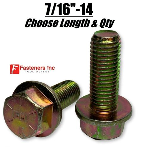

my experience is over time the heads of those 7/16 bolt heads will pull through the 1/2 inch hole. I will send you a pic if the sun is still up when I get home tonight. I was cutting up fire wood by headlight last night.

The plan is to use the washer headed bolts
I am building fairly light tracks so 5 bolts per grouser per belt (10) 3/8" bolts with swage nuts and (2) 7/16" for the guides
The 8" belts have 3 bolts and so I decided to add 2 more on an even spacing on the 12" belts for 5 total per belt
The washer headed bolts on the grouser as well as the tire guides
My guides will accept 1/2" bolts...some were loose, but bone were missing or pulled through
