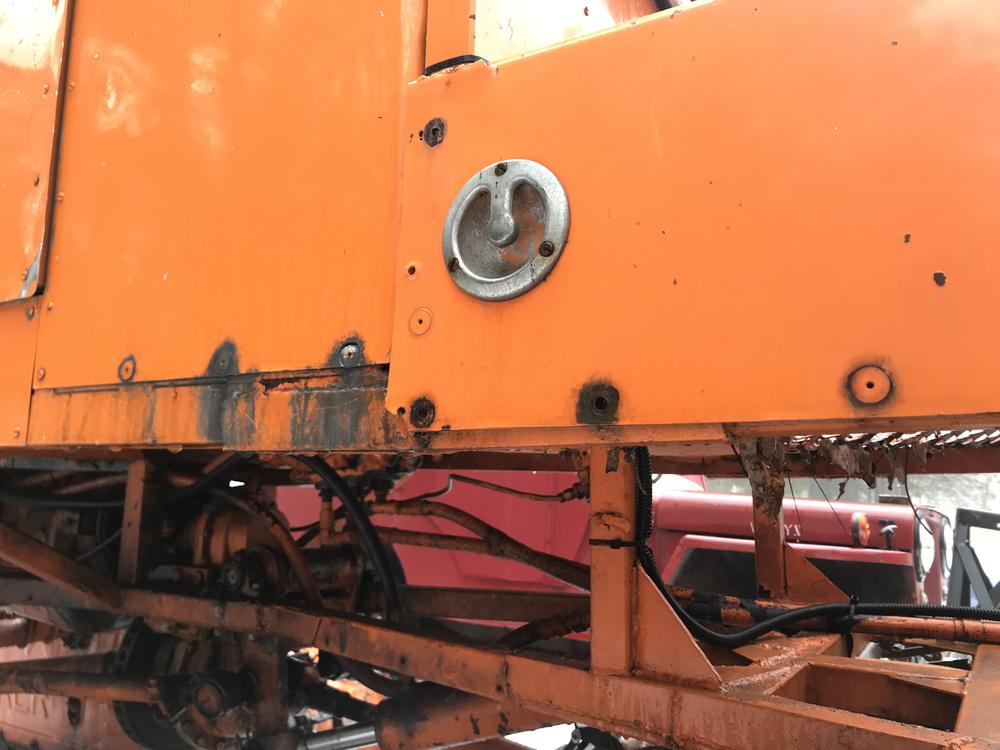

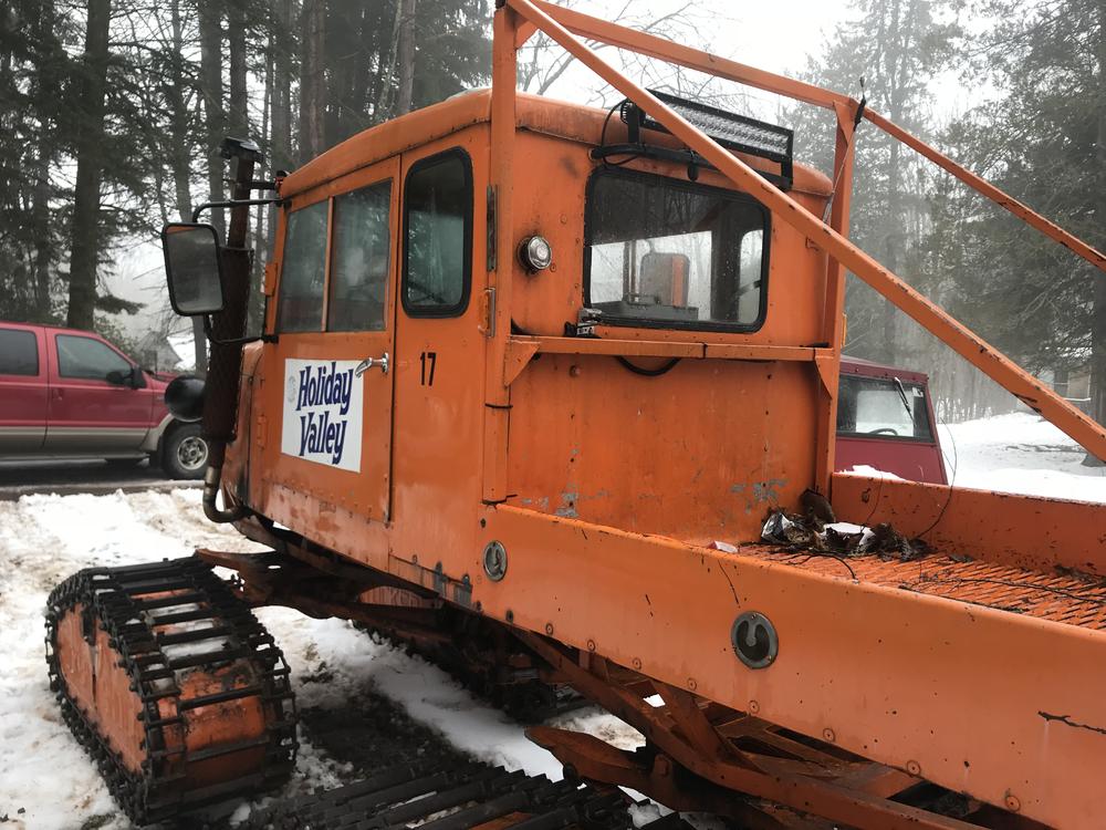

One of my standard lines of snowcat buying advice is "The cheapest machine is usually not the best value". IMHO, this Tucker is in lousy shape, has been abused, poorly cared for and is waay,waay overpriced. This is one you run away from.
There are so many red flags it's not funny. For example, look at the track slides. Note that some mechanical moron has added 2 x 4 wood spacers under the track slides. Really? How about the broken frame that was broken in multiple locations and repaired by someone making their first-ever welds? Then we have the pathetically plumbed rear hydraulics. That means usage history as a groomer, which I try and stay away from. Obviously repainted, and evidently too much effort to mask off the windshield gasket? Even Earl Scheib would do better. I see nothing I like. Nothing!
On the quality spectrum of used Tuckers, this is less than a 1 (out of ten).
