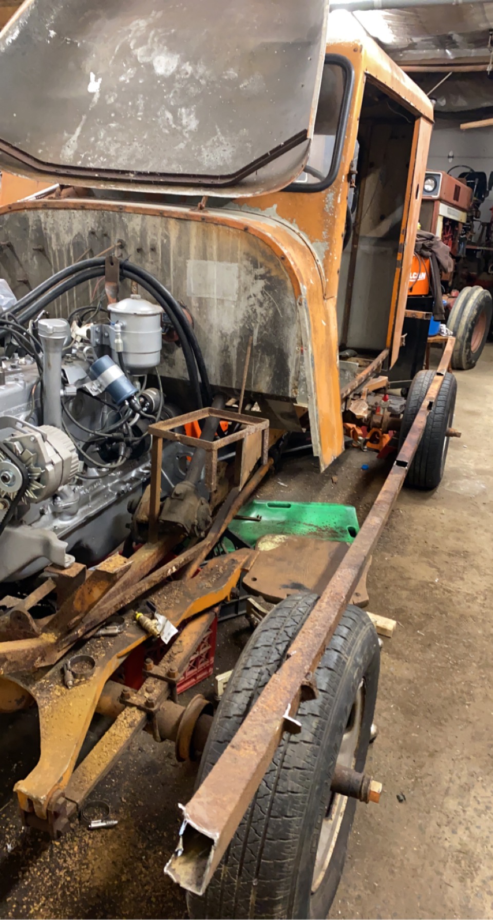

After reading another post on here about rusting frames I found the left rail was rotted out on the bottom. I got it cut out and hopefully can get a new piece bent this week. Also planning on mounting the radiator at 90 degrees since the original mounts have it leaned forward at the top

Had to get a new piece of frame rail for the left side. It rotted out on the bottom. I’ve got it welded in. Just need to touch up a spot or two yet. It took 4-5 hrs of cutting and grinding to get the old one out plus another 3-4 of removing rusty screws.

The frame rail is almost finished. Most of the body has been reinstalled.
