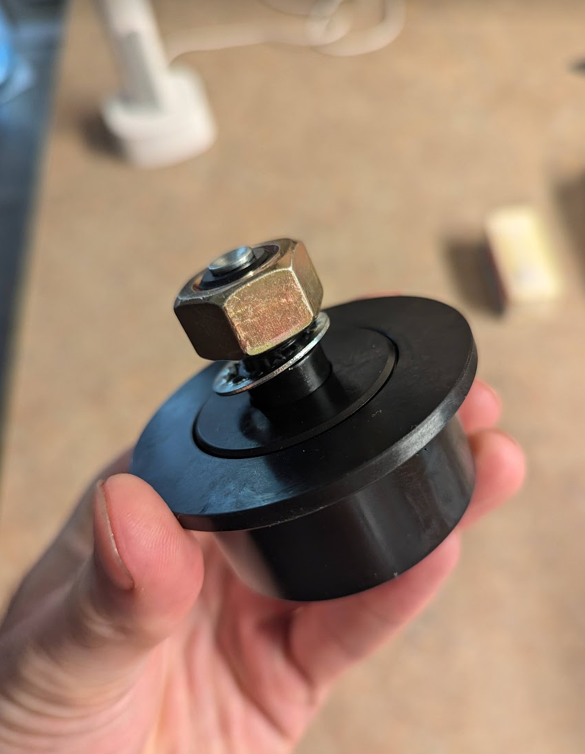

Mill666er

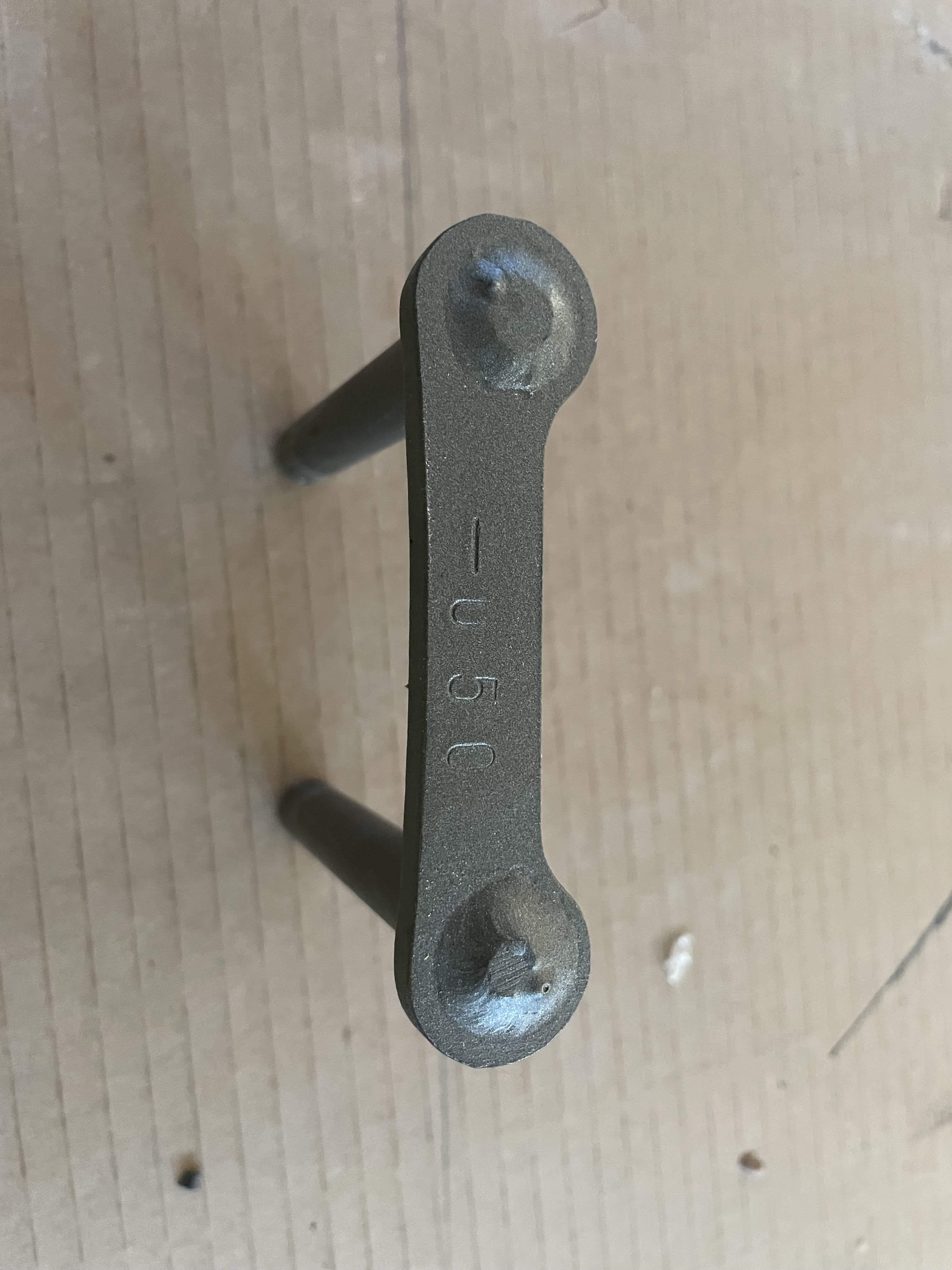

Even adjusters have their limits. When you run out of adjustment and then add another 2” to them the rollers push right through the bottom of the pontoon. I made new adjusters and links for half of the grousers which took up enough of the wear to run them. The new links only correct the pitch between grousers and does nothing for the pitch wear of the grouser. I’ve started making the links .050” undersize which shortens the track but now have .100” difference between grouser pitch and link pitch but is within the slop of the sprocket.

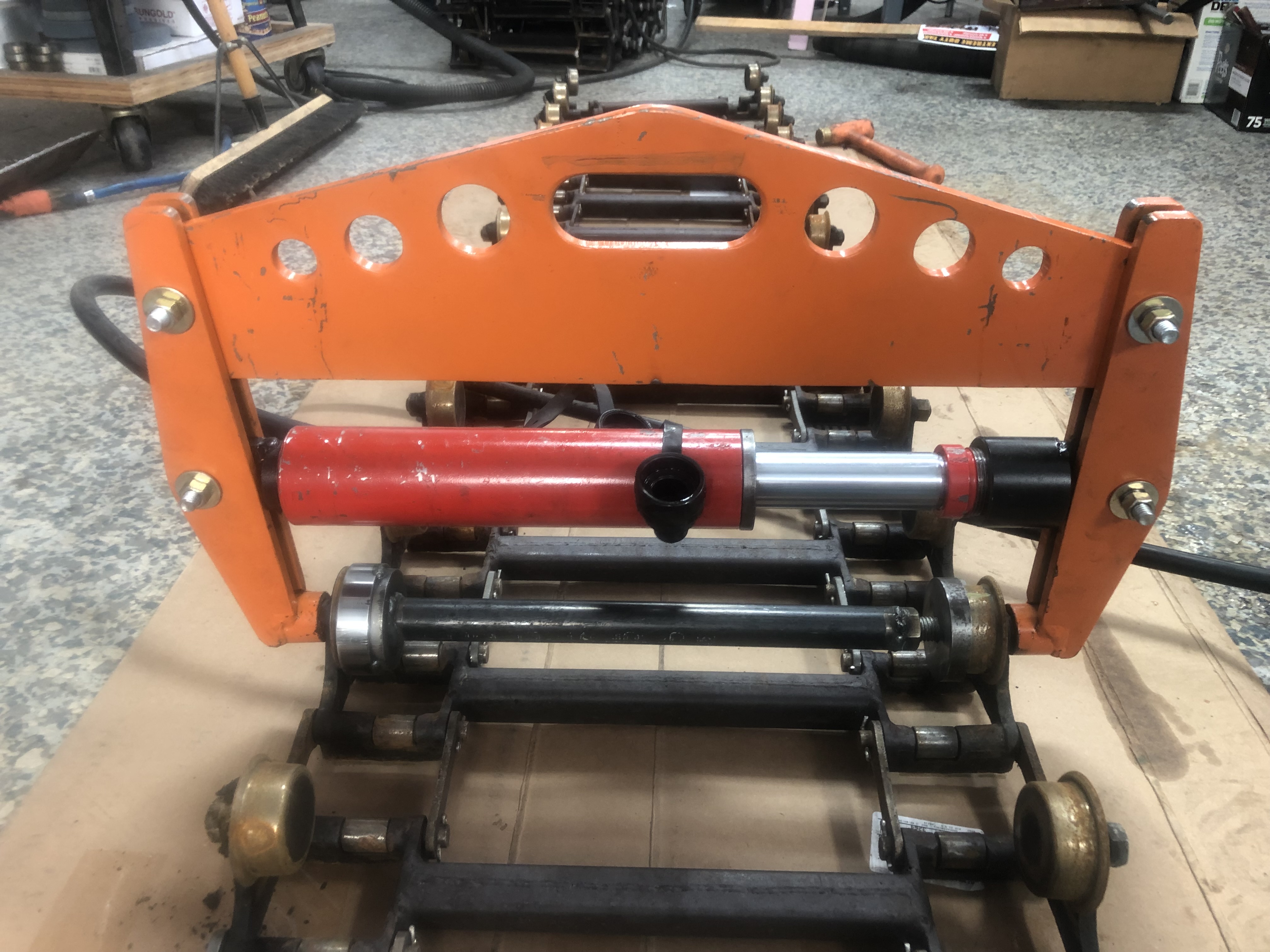

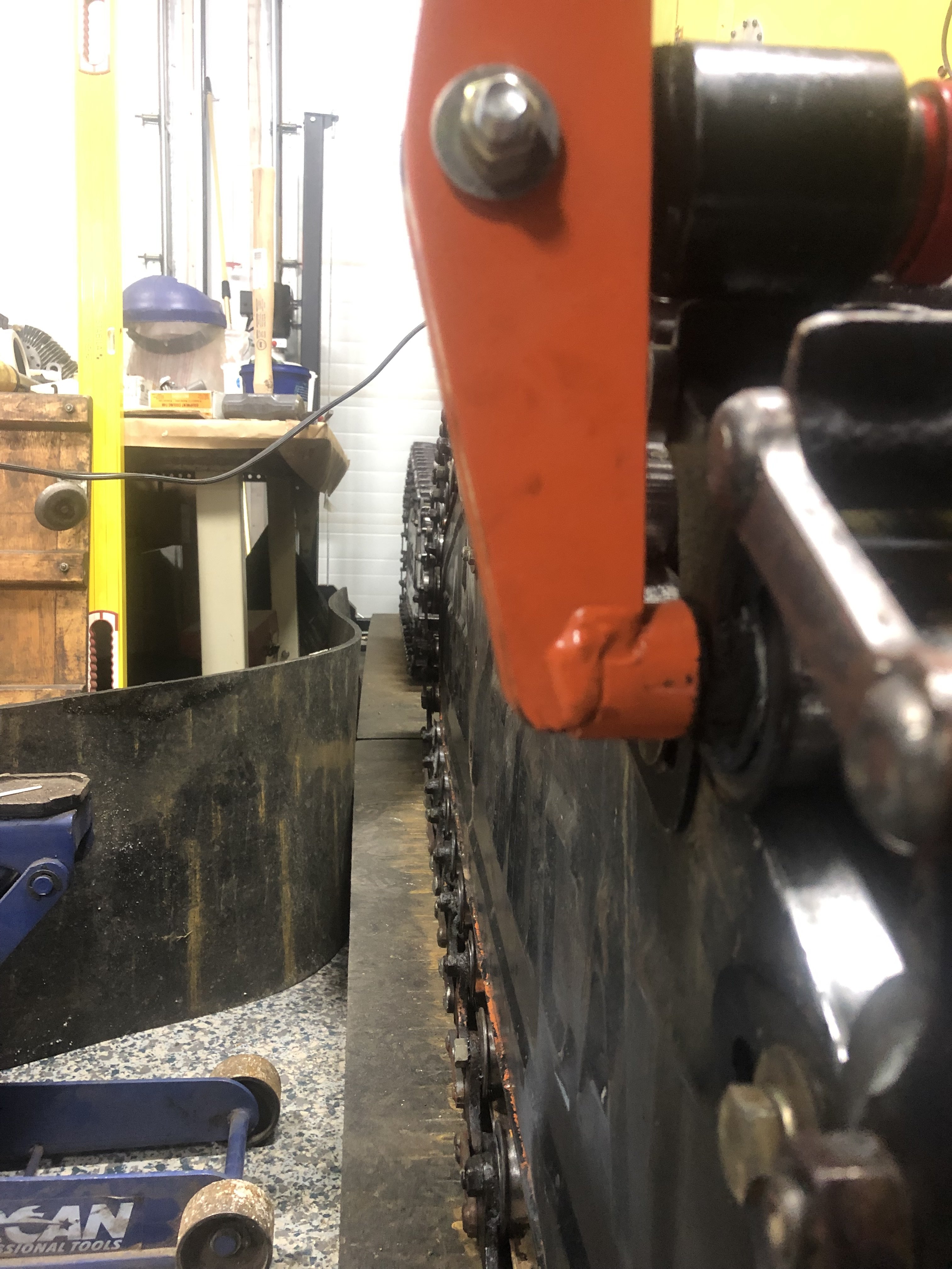

I was straightening grousers 1 at a time but then made a hydraulic ‘crimper’ to straighten them on the pontoon but the spring back was about 1/4”. I then decided to pull tracks off and make an adjustable stop to compensate for the spring back and work pretty well. The crimper slips over the nut and is counterbored for the roller stud so it presses on the face of the nut. The stop allows a little extra pressure to help to take some of the twist out of the ears. The ears aren’t perfect but goes pretty quick with the air over hydraulic pump.
