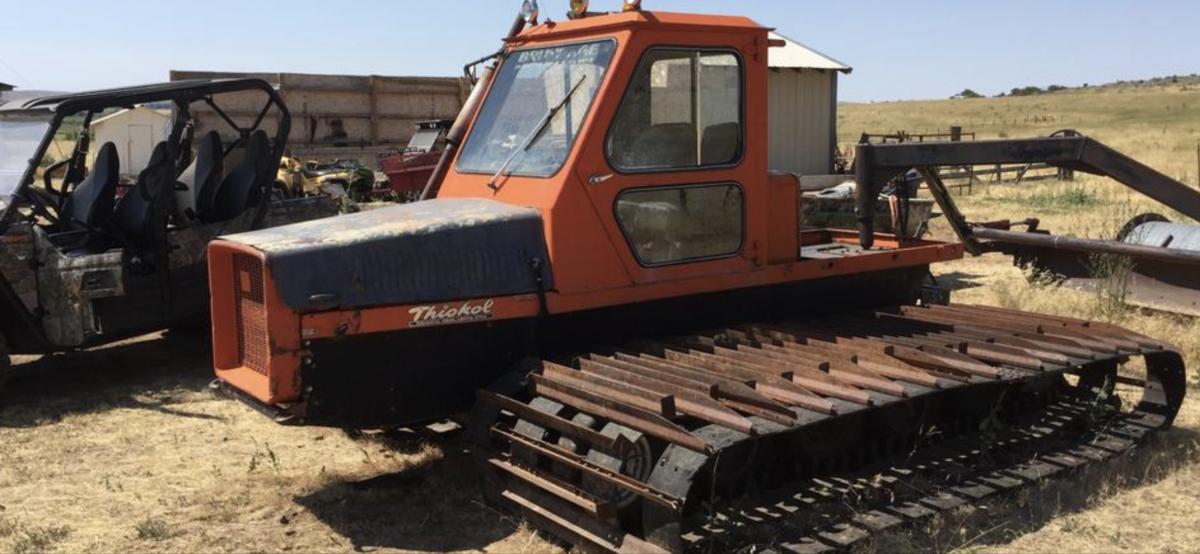

So here is a tale of a snow cat project that would be the envy of any (wo)man.
GIVEN: The value of a hobby is worth what ever one is willing to spend on it.
AND: the difference between a hobby and a habit is a 12 step program.
I am going to document the end of life for a cat that likely was the gleam in the eye of some happy groomer operator back when it was new.
When this machine hit the forum we had some things to say about it......
  • They have a very skinny jump seat to the left of the driver. Wonder why it has that high snorkle intake and the even higher exhaust? The air cleaner on my 2100b sits on top of the carb. Maybe it's a mud buggy?
  • Its not a give away...
  • Will take either a lot of money to pay someone, or take a lot of your own time to get that into a proper shape...
  • Of course, it will probably start, run and drive, but you'll never know when it will break a track or pop a seal on the engine due to being abandoned for so long...
  • Longterm project, take it all apart and put it together...
  • Hopefully you can house it at the cabin, since its too wide to tow without oversized signs...
  • I think I read it wrong... its $1500 to the person who picks it up
  • Looks like it would make a nice parts cat for the money though, probably some goodish stuff on there. Lots of steel to scrap out too!

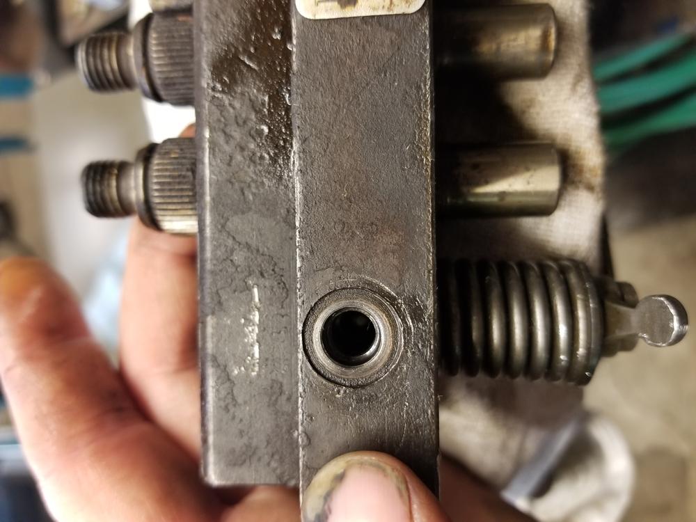

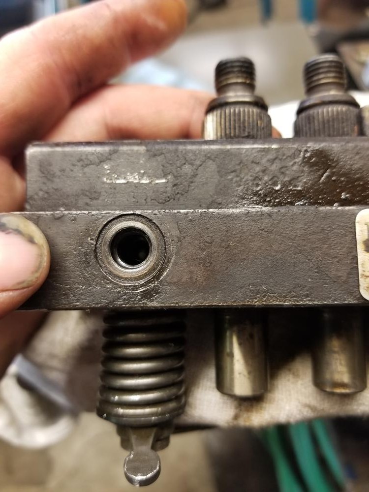

I dug into the fuel pump and injector pump to find corrosion had held number 3 and six plungers in their full open position. This is normal as when you stop a mechanically injected motor the governor moves the rack to try to increase engine speed mean while you the operator are cutting fuel…. The pump sits in full throttle, waiting for the next chance to run at which point the fly weights shift the rack back to what ever speed you desire. I was estatic that I not only had a tag, but a local diesel shop that was able to walk to a shelf and bring me a barrel and plunger. $60 later the rack moved as it should (photo 2 shows plunger six in its stuck position) I was able to get 3 to move on its own.

So to recap. the machine was found, loaded out and hauled home, engine assessed and injection serviced it is now a running snow cat sitting on its bogie wheels with sprockets that move and react to the steering controls... oddly I can't seem to find reverse........

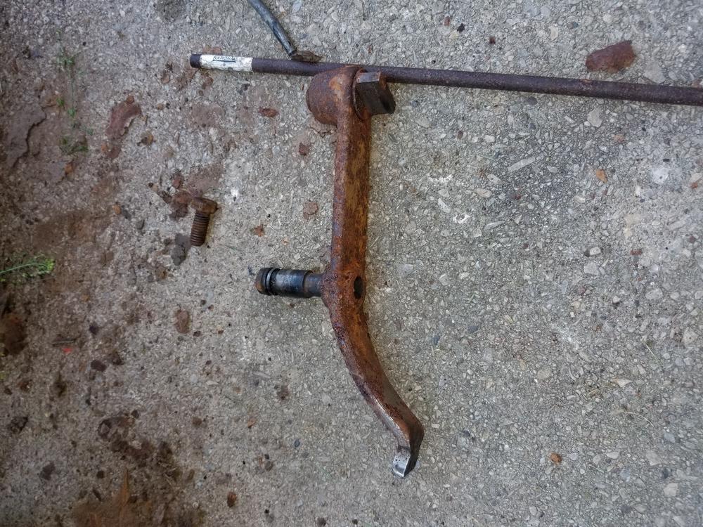

Little tug on the left stick, right stick, left stick and the pride bubble burst. The K part of Knowledge skill and ability is in the bull pen perpetually warming up for just such and occasion. K shouts from the bull pen, pull harder. (S) And (A) speak up sternly [pluck ewe] and I go check the hydraulic fluid, again. It is low but not empty….. I will explain my disdain for engineers another day, but they got this situation correct.
“ The 2100 relies on hydraulic pressure to steer and stop. Snub the engine and an electric pump is there to save your bacon. (gravity being both friend and foe, between dropping the blade or tiller as a anchor and also equally pull you down the incline)”
The feed line to the steering pump is higher than its sibling feeding the accessories. You lose ability to steer long before your brakes and attachments cease operation. (brilliant) Little splash of juice and (S and A) now agree with (K) and I pull harder on the pilots. I hear a whoosh of fluid and alas we are able to steer. We-bit Verklempt again.
A quick check of reverse and we can stage for paint like a proper reality show.
Nope. The gods of simple fixes says it is time to tip the cab. I am proud that all the work to date did not require putting the cab into service position. The dream is over. The IH scout II has a winch. A high-lift jack confirms the rust free cab is just that. “last time I tipped a rust free 2100 cab the floor stayed put” I winch the cab over and pull the top of the T-18. I am relieved to find the transmission intact and to a proper level of excellent quality gear lube. The photos reveal either an Oh snap moment or inept operator moment, neither matter, the pin for the reverse shaft needs repair and gets it.

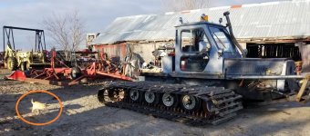

The “Runaway Diesel, Overwidth, Snowcat, and Roadside Mailbox Guillotine” (RDOSMG) Starts runs moves and steers of its own free will. Next stop is the accessories. They are needed and if this rig is serve out its 50 hour retirement with me it will need to serve a purpose….

redsqwrl
experiment #2
turned left
last week I turned right
Previous photos unturned

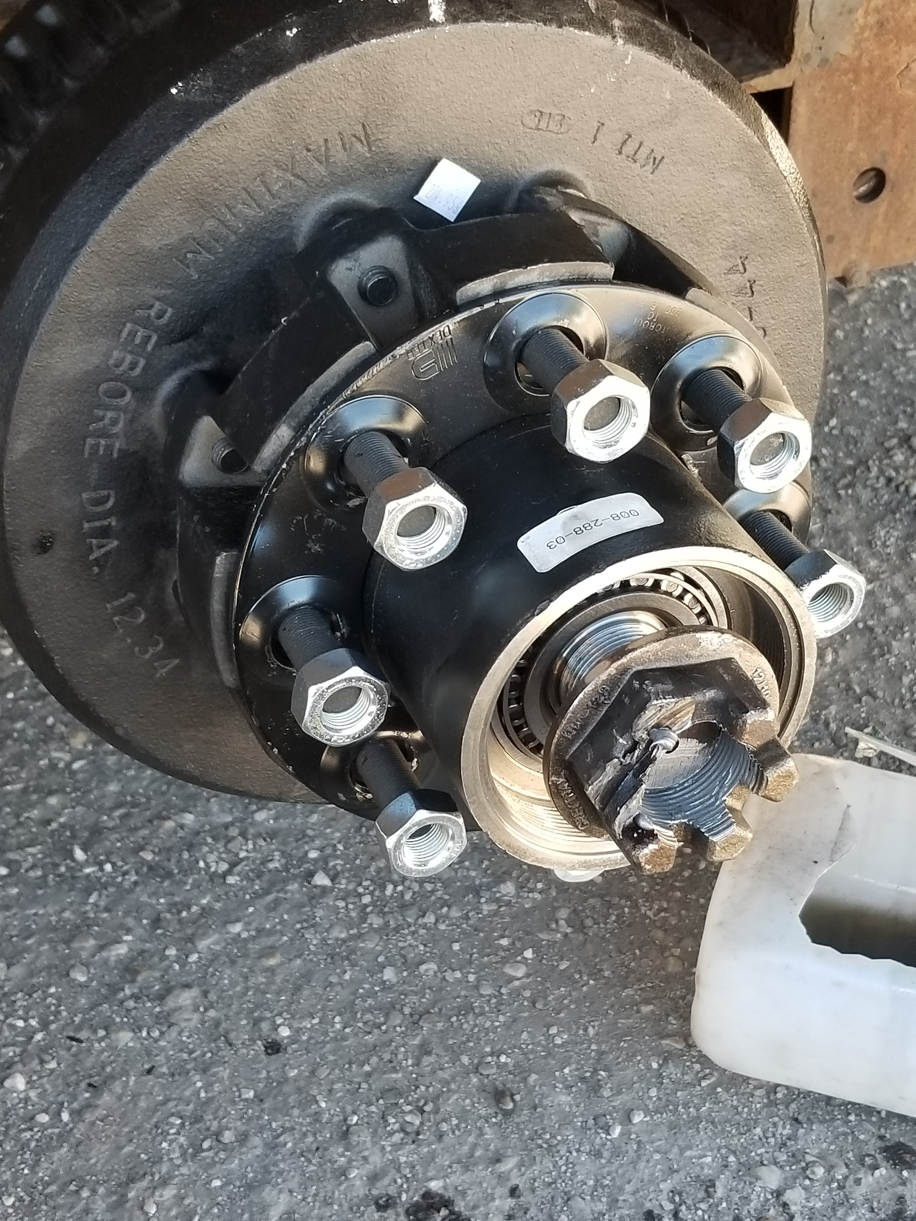

photo ONE Is the result of sending a tire assembly into rattle snake river or snake river either or?..... as I was cutting down to denver for some more scrap iron as the trailer had a couple of inches that were not over loaded with *chain* ( the chain in reference is a swimming analogy, it is insensitive and off color joke ) Zoom in and take in the nuance of the nut in the photo and whether or not you choose to believe that the studs sheered off and sent the out side tire off into a river ravine, While the other *inside wheel* stayed right there on the nut for 40+ miles, (words of the truck driver who waved me over stating he had been trying to catch me for that length of time......) that is on you. I believe the gear lube dibble pissed out at just the right pace......... ITS not BLUE!?
the second photo is baby lions back. My son just happened to be with in 4 hrs of my location so I got ahold of him and had him hunt down parts while I pulled the front axle up with a very stout chain come along. this put all the weight of the chain (load) onto the rear axle
Its was very hot. I kept the speeds down and found great interest in the rear view mirrors as I limped down into the provo, SLC area.... found a hydraulic shop that stayed open late willingly to allow me access to some tooling that allowed me to save the threads of the spindle. Made it to a trailer retailer for a pair of wheels and tires...... and onto another location for the hard parts. I offered to bring coffee if they could get to me first thing in the AM. sales men was less than interested in a coffee, I went to the midwest peace offering which was a box of malted beverages, I had four to choose from and that seemed to raise the tension on the phone even higher....
I hit a nerve when I suggested he could pick what ever packer football game he would like to go to and walah There were parts available. Did I mention it was really hot when I serviced that hub and got back under way. toured the beginnings of some celebrity sno cat projects that had just been painted red.... ( hint hint )
