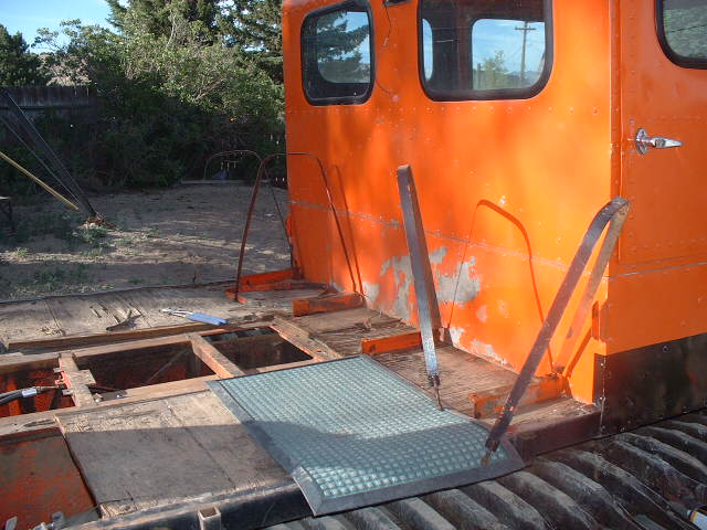

Here are the pictures of my Thiokol 1202B Rear tank and deck removal. The wood deck was completely shot. I will be extending the deck about 8" as well. Heres the pictures. :thumb:

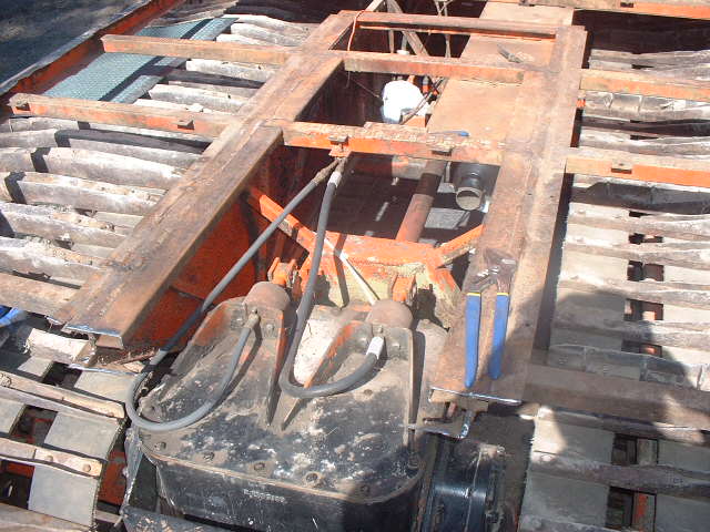

I have cut away alot of bent, stressed steel. They sure were hauling a heavy load on the rear section, both sides. Heres the pictures of the Tank being removed.

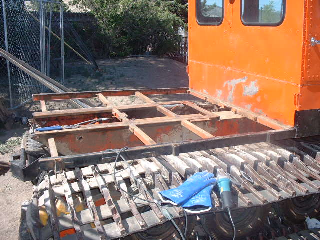

OK here is a few pics from today. I decided to cut the "L" brackets on each side of the OC-12. I will use the 1 1/2x1 1/2 tubing instead. I found a bunch of little stress fractures only around the rear sections. Most will be replaced the rest will be drilled then welded.
Four pictures.
I decided to extend the deck 10" in length.

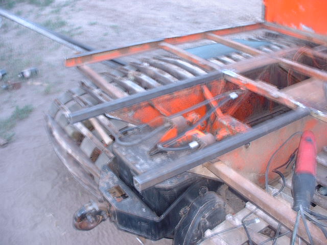

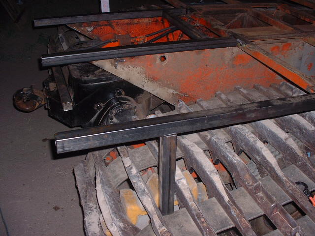

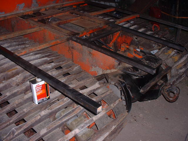

Well here are the photos from today. I have everything cut out and all the replacement steel cut to length. I will cut the rear bar after I square everything up and weld it. Then the back piece will be measured, cut and welded up. The "C" channel that covers the outer edge and over the plywood ends will be replaced with 1/4" aluminum diamond plate. It will be the same dimensions. Heres the pics.
6 pictures.

Looking good! Quick question/observation though: On the outer bars extending to the back, I'm guessing that those bars going down through the tracks are only there for support while youre welding it up?(pic bottom right)
I'm sure they are, but it would be a classic Mikey move, wouldn't it! :yum:
BobP, Now your just being mean! :argueing: Wait your not supposed to weld those to the outer axles?:4_11_9: Actually I had them there for picture taking purposes and didnt think "I" needed to explain that. BUT I GUESS I WAS WRONG. :rolleyes: :poke: OK, The tube and the can of mineral spirits are there to just support the out tubes so I could take the pictures and let you see how its going to look. They will be removed before I weld. :yum:
<snip>
Hey, we just had to be sure. After drinking down that can of mineral spirits who knows what you may have been thinking!! :burp:
