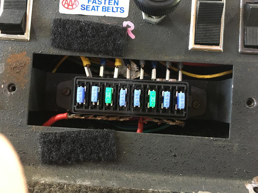

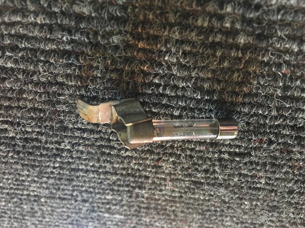

Started having electrical problems in the 1200. Some of the fuse holders were getting too hot and melting things. They weren't overloaded. The rivets had loosened over time and the connections were poor causing excessive resistance.
I wanted to update it with ATC style blade fuses and keep it in the the same location.
https://www.amazon.com/HELLA-H84960...t=&hvlocphy=9033308&hvtargid=pla-523116156236
I found a Hella 8 gang holder that would fit. The height was an issue but I figured I could use low profile fuses. Nope. Those only come in mini size and wouldn't fit. But the regular mini would. I put it all together and it worked great. Can even put the cover on. Now everything works again and the magic smoke has stopped leaking out of the wires.

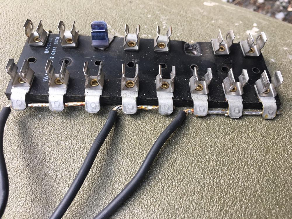

be cautious with using solder as the buss connection. That 30 amp circuit is able to get warm. It doesn't take much to get solder to a plastic state where it can creep. Then it becomes cyclic where the hotter it gets the less it conducts which causes more heat.....

Good observation, to continue on that theme --- what would happen when 90 amps flowed on that left hand wire ?
The original fuse block had a soldered bus. It worked for 31 years. And that's not what failed.
Close ups of the factory wiring. I agree that solder isn't the best. I think a solid strip of copper with the connector screwed down would have been far better. I ran the cat yesterday for about 4 hours and all the circuits were fine. I touched all the connectors and none were warm. That's with all the lights on.

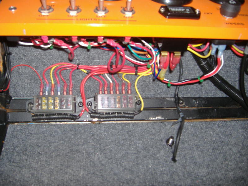

That's the same type fuse holder I used in the imp. I used two 6 circuit holders and made the holes in the tabs bigger and soldered the bus wire through the holes. It has worked fine for 6 years now. I used two 6 circuit fuse holders but the one on the right is split 3x3. 6 circuits on accessories, 3 on ignition and 3 on battery. I have a lot of electrical stuff to run.

I had a bad experience in a 2100 this winter. I believe the factory engineers may have used silver solder or something more substantial that 60/40 malleable solder.
Tight clean connections will never draw heat.

For what ever this comment is worth, the national electrical code prohibits circuits that rely on solder only. they must be mechanically made first then soldered.
Turbinators connections are an example of this. the pig tail and t tap are wire twisting procedures that are made to be soldered.
I used to hold a Solder Certification card for Nuclear, weapons, and aircraft when I worked for the Navy. 2 week school. They were real picky about that stuff. Especially the nuclear inspectors. Turret posts had to be between 1 1/2 and 1 3/4 turns with a 1/8" tail. No more, no less.
Unless you really want to change it, it will probably be ok. Make sure there is plenty of solder on the tabs and the wire is well wetted and flowed into the stranding.
I've actually had more problems with bad crimps than soldering.
